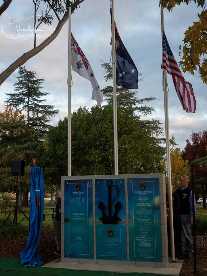

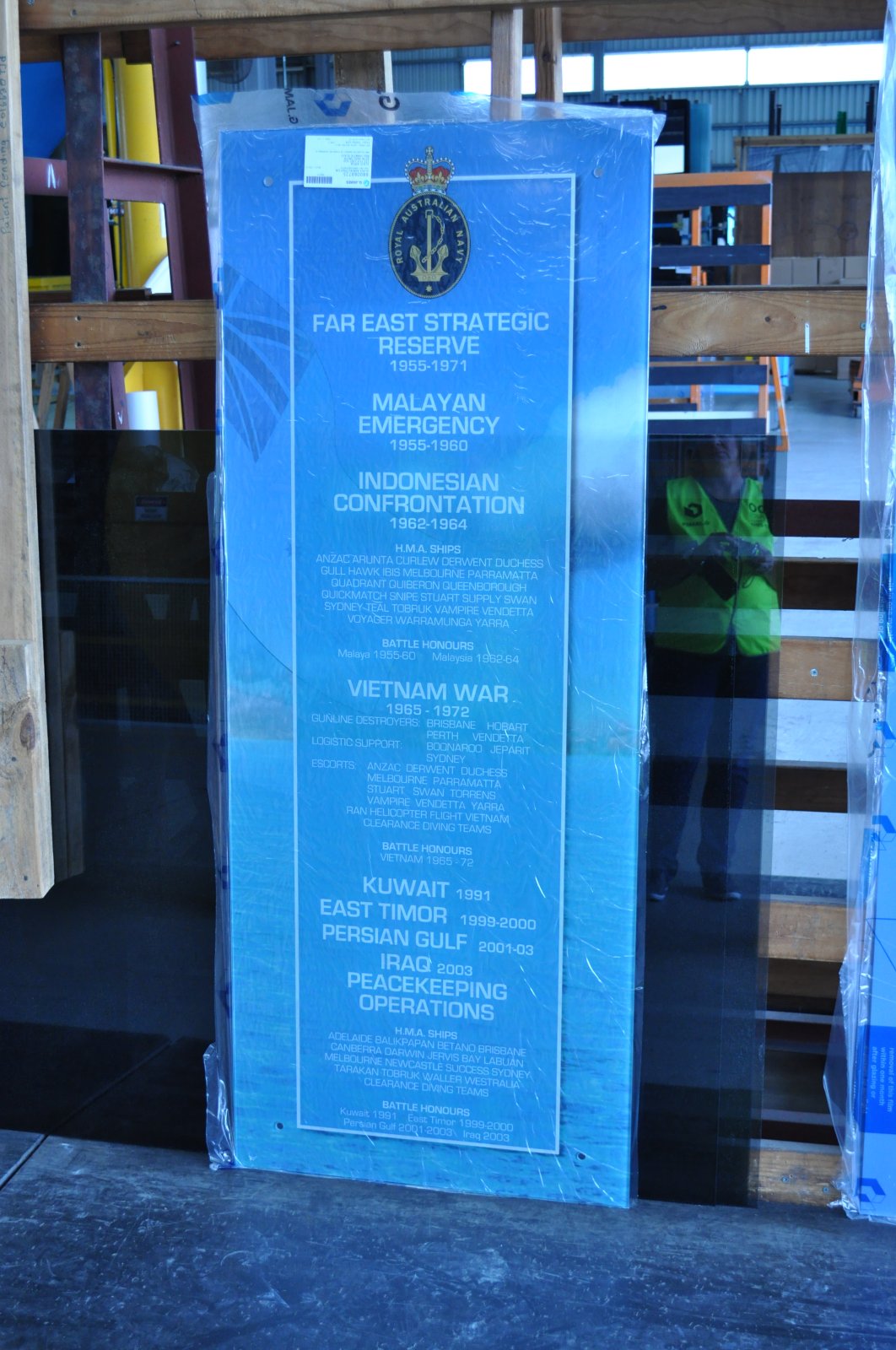

    You can have laminated glass where the individual glass layers are tempered. The tempering is done before the lamination process. We had some printed glass panels done this way for a Navy memorial wall we were commissioned to do. We designed the artwork, oversaw production, and completed the installation of the panels on site. It was a very rewarding project that we were proud and honoured to be involved in.

    1. H.A.M.B. Chapel
    Totally off subject…but, is that in Canberra? Seems familiar.

    twenty8
    No, not Canberra. It is actually in a small country town in south-east Queensland.
    It was dedicated in commemoration of the cooperation of the allied Australian and United States naval forces in the Battle of the Coral Sea, May 4th to May 8th 1942. The battle stopped the Japanese sea-borne invasion of Port Moresby, Papua New Guinea. The glass panels list all of the conflicts the Royal Australian Navy has been involved in, and the names of all the Navy vessels involved in each conflict.
