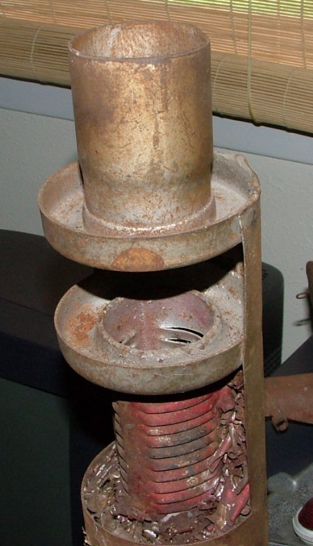

    This is an original Smithy's muffler demo cutaway, showing what used to give them the sound they were famous for.
    Notice the chambers, that are on both ends, adding some resonance.
    Today's reproductions only have the outside appearance and chambers in common with the originals.
    Today they have a much smaller diameter louvered inner tube with dense gl***fiber packing, giving a very different sound to the originals.

  21. Road Runner
    Joined: Feb 7, 2007
    Posts: 1,256
    Road Runner
    Inner tube and donuts are one piece that slides, creating the two empty chambers at the ends.
    If you do this, make a sound clip.
    We haven't heard the original Smithy's sound for a long time.
    If I had a machine shop, I would have people send me their new repros and modify them custom to length with the original type of construction.
    My main issue with the new ones is the small constricted 1-3/8" inner tube with hole louvers.
    The original 2" inner tube and slotted louvers should have a much deeper throatier sound, without the choking narrow restriction.
    To get closer to that, I had Porter make me a custom 14" pair with his larger 2" inner springs and 4" outer casing.
    Best muffler sound I had so far, but I am still curious how chambers on both ends would sound, like the Smithy's have.
