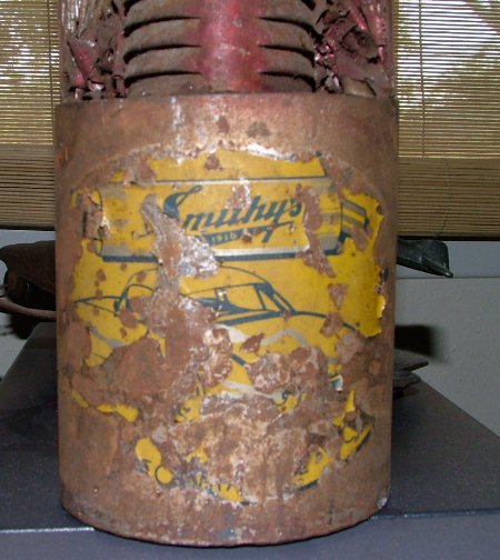

    Since I saw that photo posted here many years ago, I wanted to hear the sound they make.
    Here is the rest of the photos. Somebody showed off this table-top display and I saved the images.
    This one has the perfect length I would use on my 235.
    I can add a soundclip of the custom Porters I had made for me a couple years ago, next time I come back from trip to town and everything is warmed up. They are quiet entertaining.

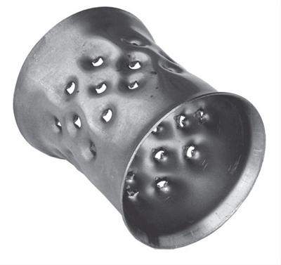

    Here's one more addition to the "holes" idea. We ran Schoenfeld mufflers on our dirt car for years, and made some of our own inserts. Hit the holes HARD with a punch, to make longer "barbs", giving you more noise reduction. We only ran 6" - 8" muffllers, but we only had to get to 95 db. A 24" insert with lots of barbs could be a big help to make it (kinda) street legal. A pic from Summit:
    http://static.summitracing.com/global/images/prod/large/SCH-42530.jpg
