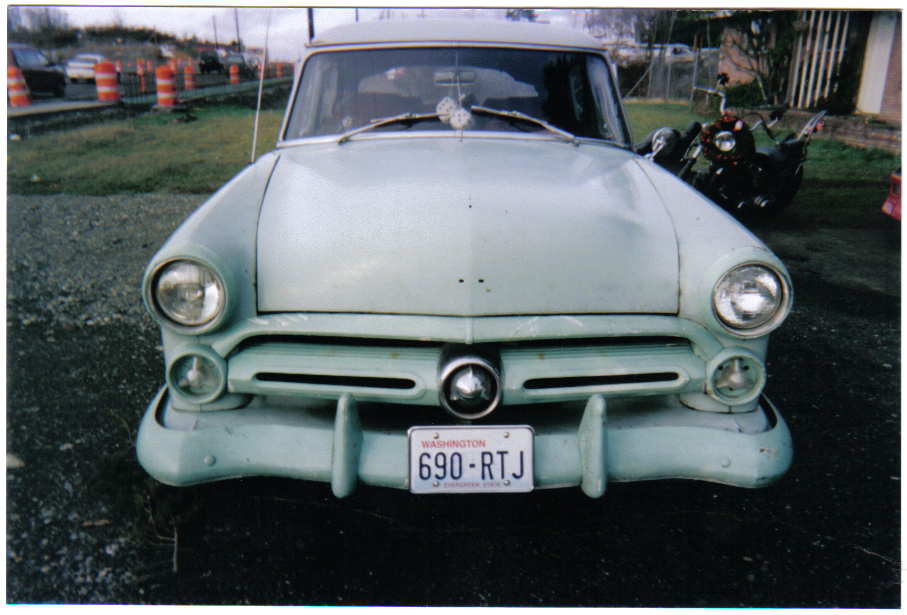

  10. low springs
    Joined: Jul 10, 2003
    Posts: 2,499
    low springs
    from Long Beach
    4t64rd and gbomb, i have more pics if your interested. if you have questions when your doing your car let me know. good luck.

    What did you use to radius the conduit?
    Also, what size is that conduit?I am doing something similar on the 50 Chevy but I am having a hard time making the pieces symmetrical. Any tips?

    [ QUOTE ]
    [/ QUOTE ]
    i used a coat hanger to get the radius. then once i got the shape i wanted i out lined it out on to a piece of wood. used it as a buck. i tried using a pipe bender but just kept kinking the pipe. i couldn't get such a tight bend. i used a plywood as thick as the pipe 1/2".
    i measured from the center of the top lip to the center of the fender. so it bends directly under the headlight and lines up with the fender lip on top. then just marked it on the pipe and just bent it. tape one end of the 1/2" conduit and fill it up with sand. make sure you pack it in and tape up the other end. without the sand it will kink the pipe.
    i hope that helps. anymore question just ask.
