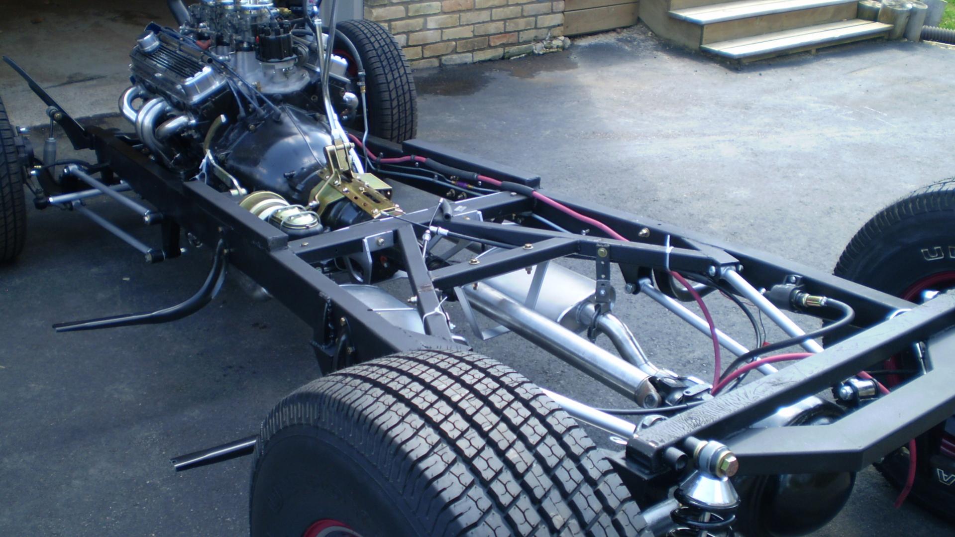

  2. Nothing to out of the ordinary but I'll get your thread started. Basic Model A perimiter frame that I made all the crossmembers for . Pretty straightforward stuff but I'm proud of it. I almost hated to put the body and fenders on...:eek:

    Good looking frame there oldschool..!
  5. Thanks. It drives down the road at 65 with no hands, straight as an arrow. I guess I did something right.:D

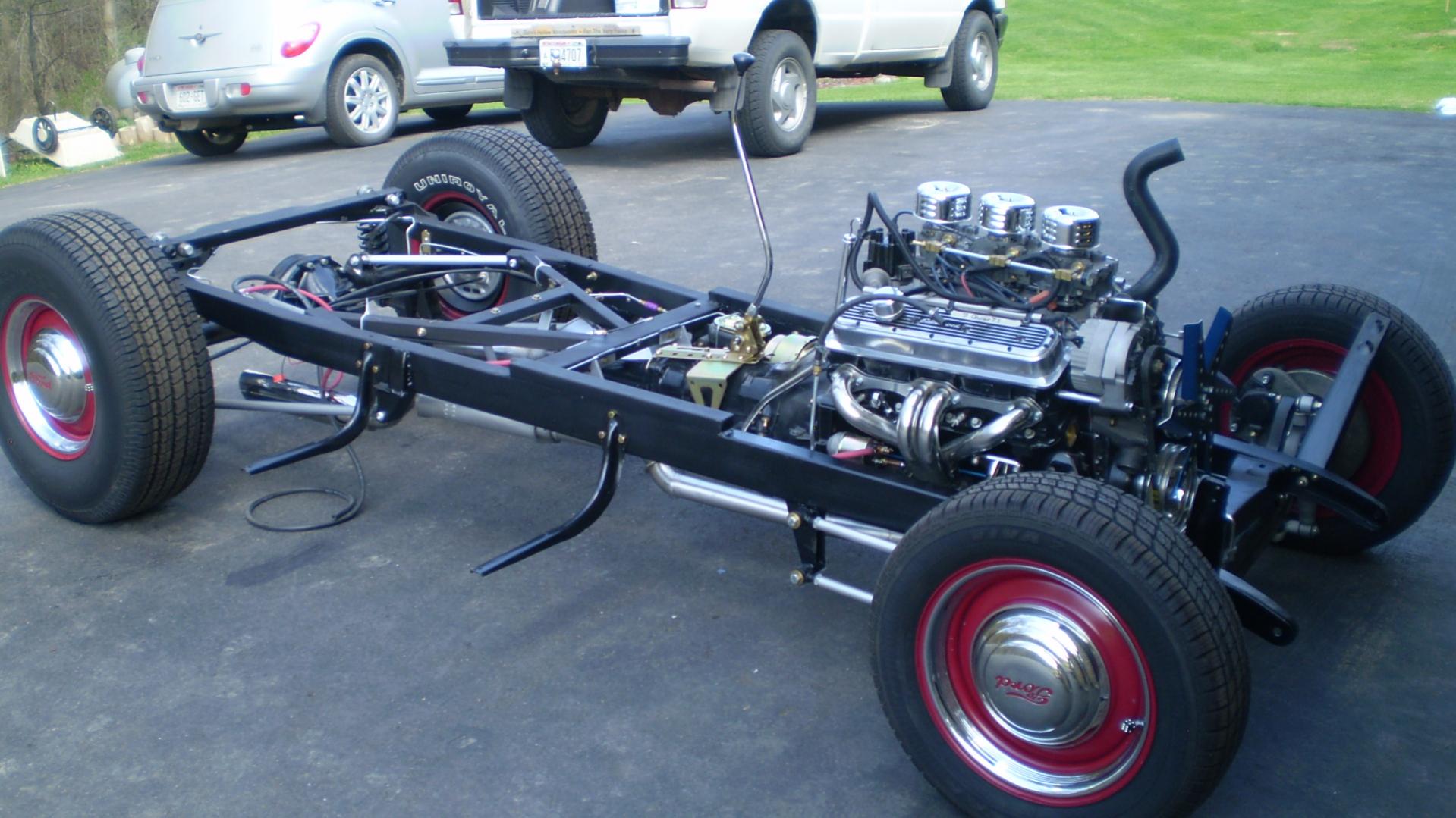

    2x3 tubing, cut and welded at the front to duplicate a stock "A"frame. Triangulated 4 link, 4" dropped axle, 4 " Z at the front, and a 8" Z in the rear,etc...................................
    This is under a 29 2 door sedan,that is now in New Jersey.
  7. Nice work L79!!!

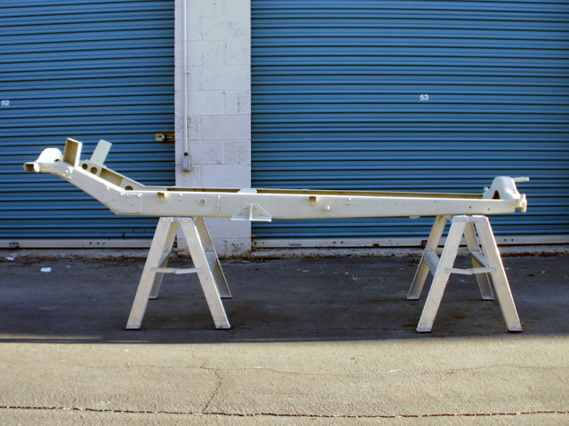

    Here's the frame for my deuce. It's from Carl Fjastad at the Deuce Frame Co. We stretched the wheelbase to 108" , pinched the front and flattened the front x-member along with rounding the profile to match the grill shell. The center x-member is fairly standard with the exception of a removable rear trans mount . In the rear we removed the frame ends and raised the rear x-member 2" so I could use a longer shockabsorber. The car is three years old and has about 13K miles and rides very well.

    Philly thats ch***i its so right, im planing my -32 frame and i want something like that.
