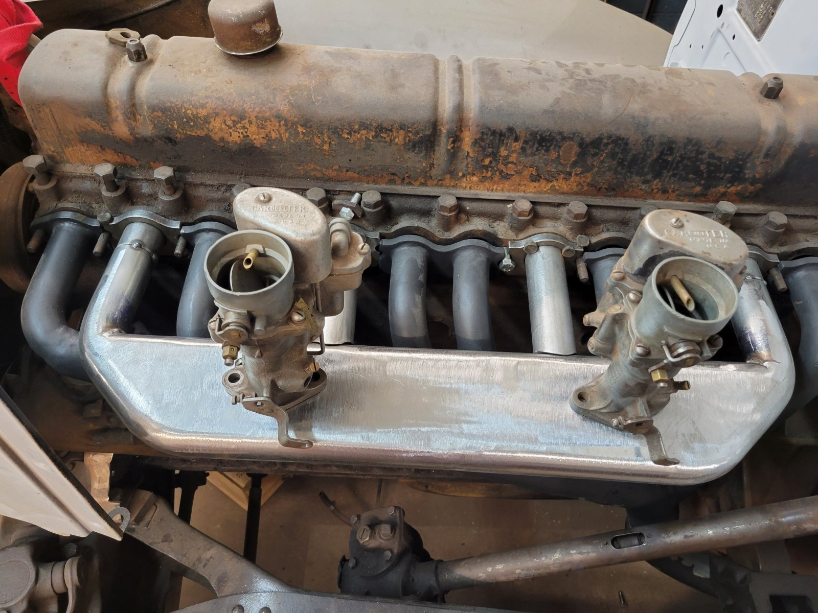

    I bought a 3/8"strip of stainless, used a hole saw and welded stainless J-bends. made my own manifold for my avatar

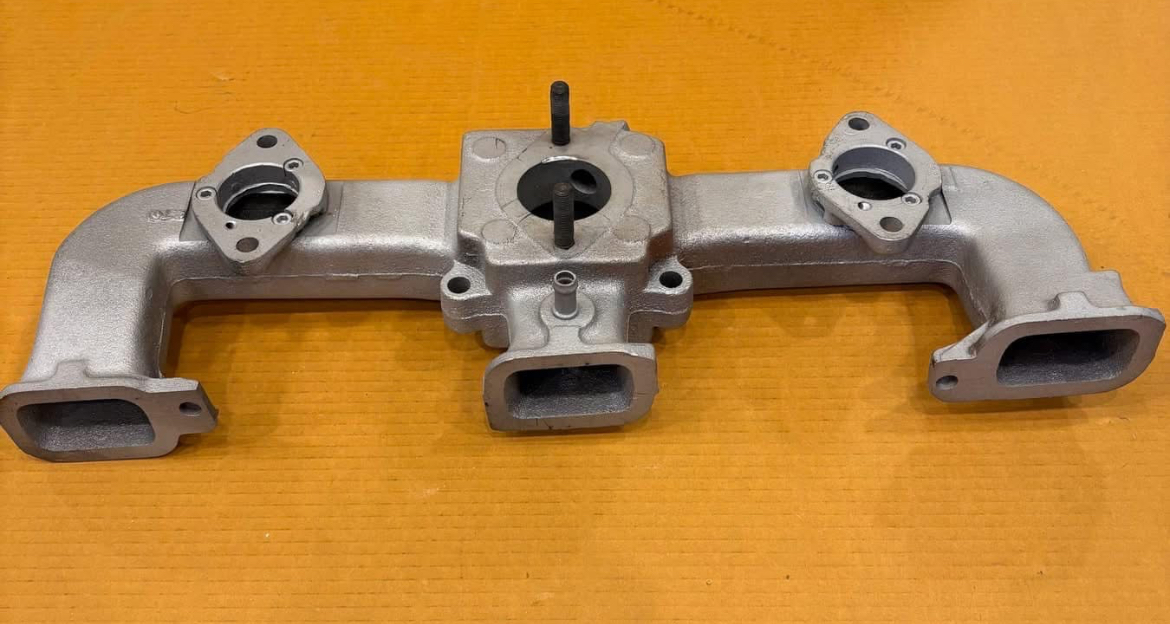

  8. Early vets had em. Not cheap but probably cheaper than paying to have something built.
    Nickson made em as well

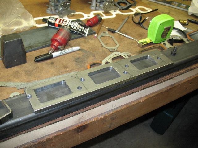

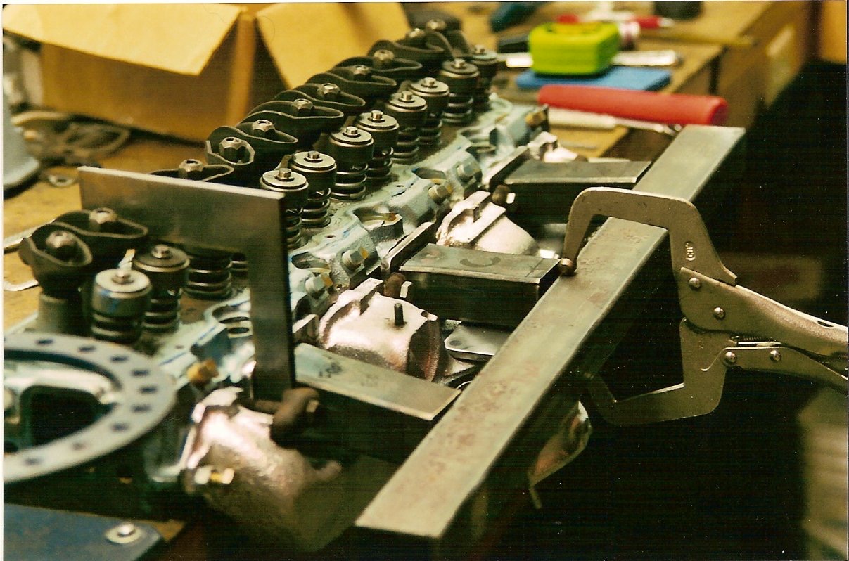

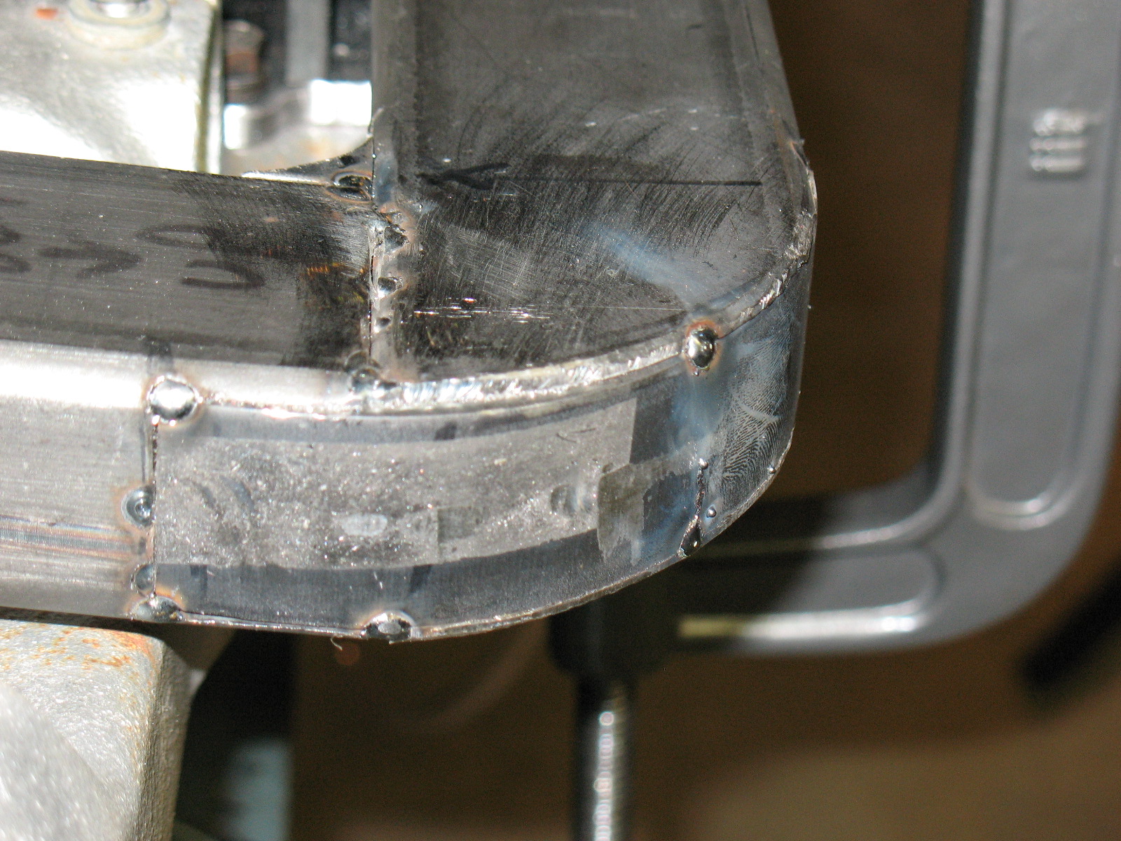

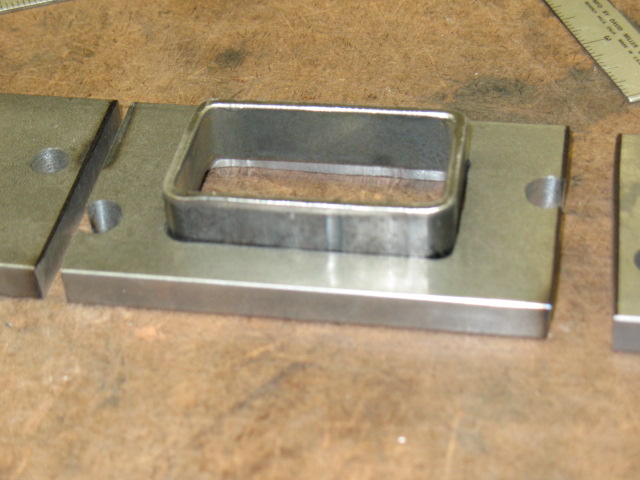

    Not a side draft, but heres one I am using on a 250. Nothing but hand tools, electric drill, jig saw, and mig welder. assembling intake.jpeg IMG_0957.jpeg IMG_0962.jpeg IMG_0981.jpeg IMG_1030.jpeg

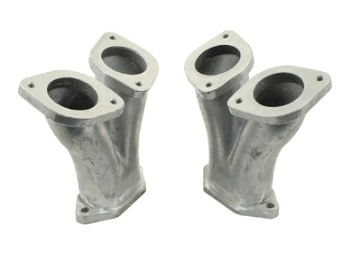

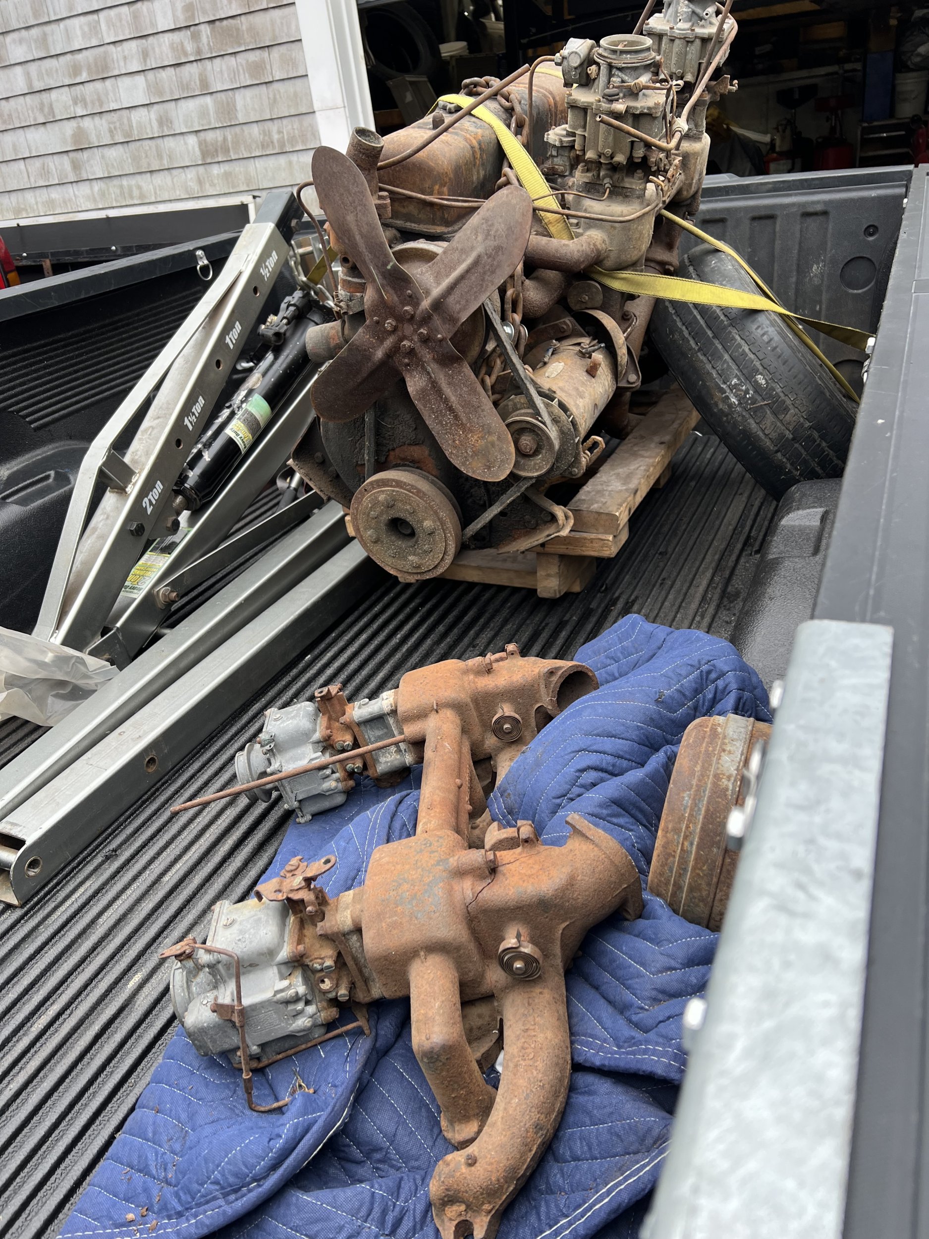

  12. The 235/261 COE and step van intake could easily be converted to side draft
    If ya dont mind welding cast iron
    Had an updraft carb
    Sharpone likes this.

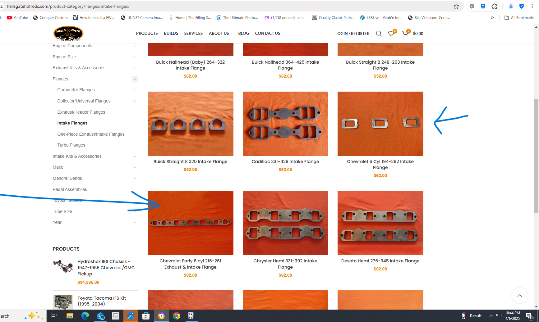

    https://www.hellsgatehotrods.com/ makes and sells intake or intake-exhaust flanges for straight six Chevys and makes carb flanges to help with intake fab. They will also sell you the tubing/bends to make intake or exhaust too. Screenshot (856).png

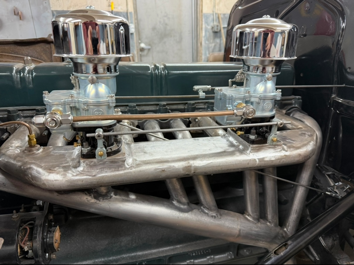

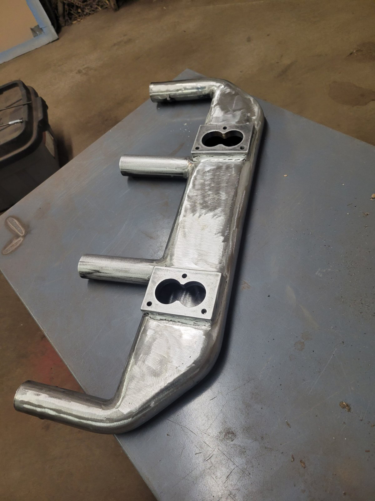

    Are you opposed to just guessing your way through it? :rolleyes:

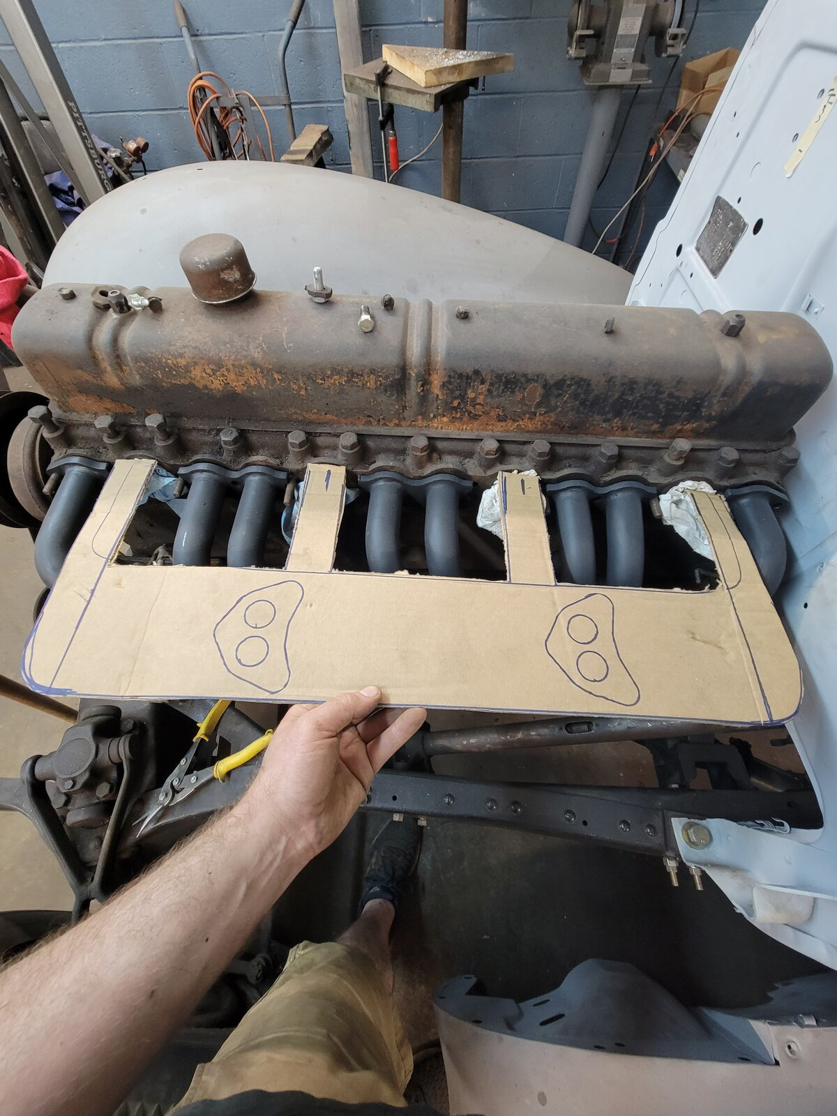

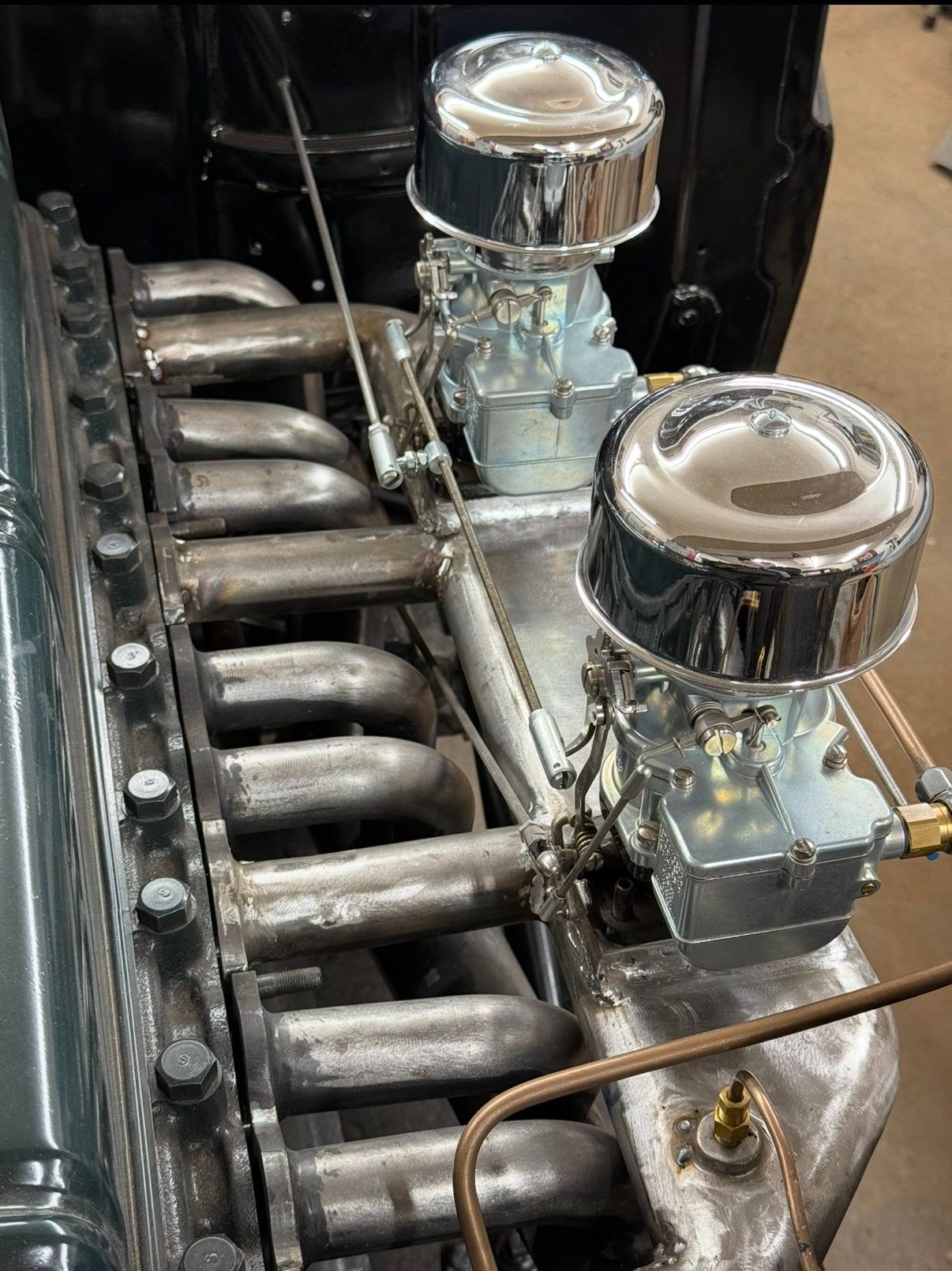

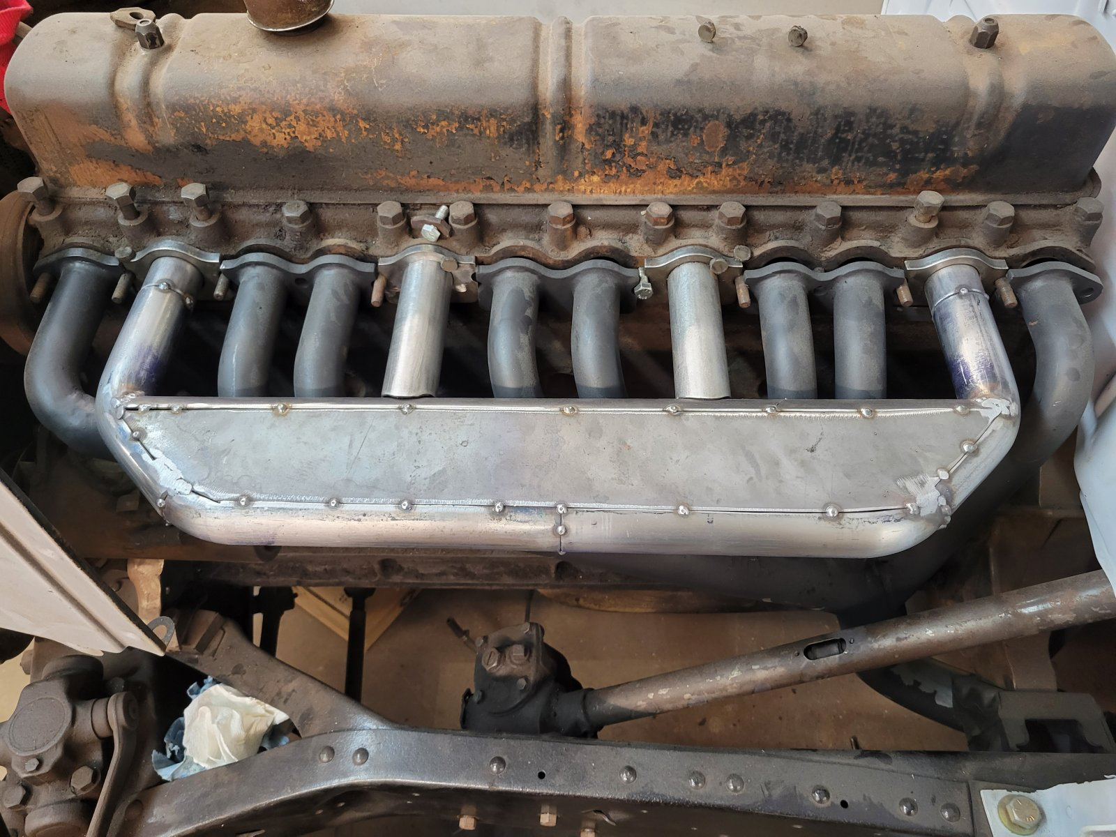

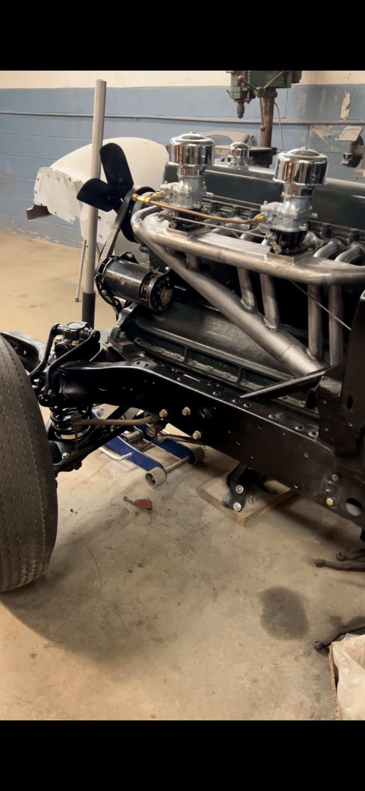

    A couple more inline cylinders than a 6, but same idea. I still need to do some finish welding and get it all polished up before it gets cerakoted along with the header but ive been dragging my feet and wanted to make sure i didnt need to add any provisions for fuel or gas pedal before it gets coated.i think the intake stuff starts around page 10 of the thread in my signature
    IMG_4638.png IMG_4640.png IMG_4641.png IMG_4642.png IMG_4643.png IMG_4644.png IMG_4645.png IMG_4646.png
    That's where i got the intake and exhaust flanges from for the straight 8 stuff. i also bought some carburetor flanges but i ended up using some that i made.

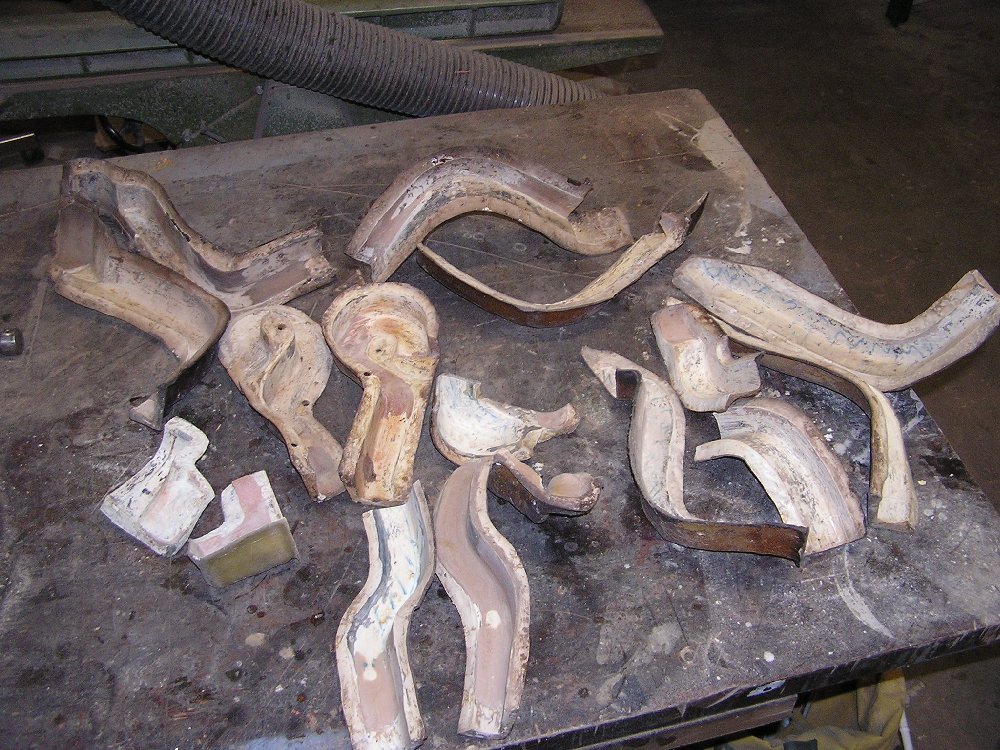

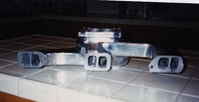

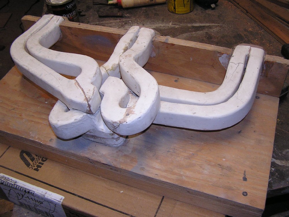

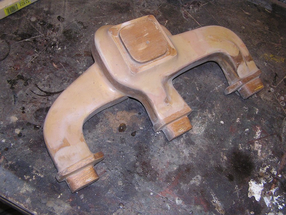

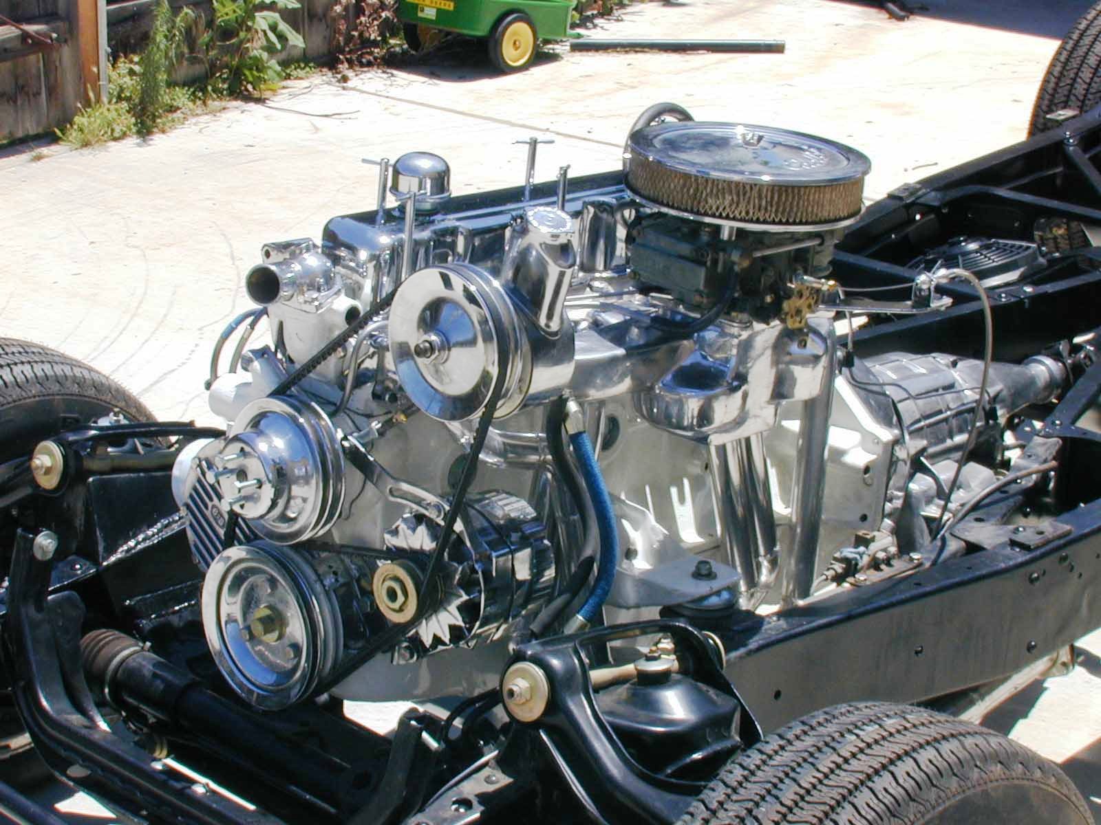

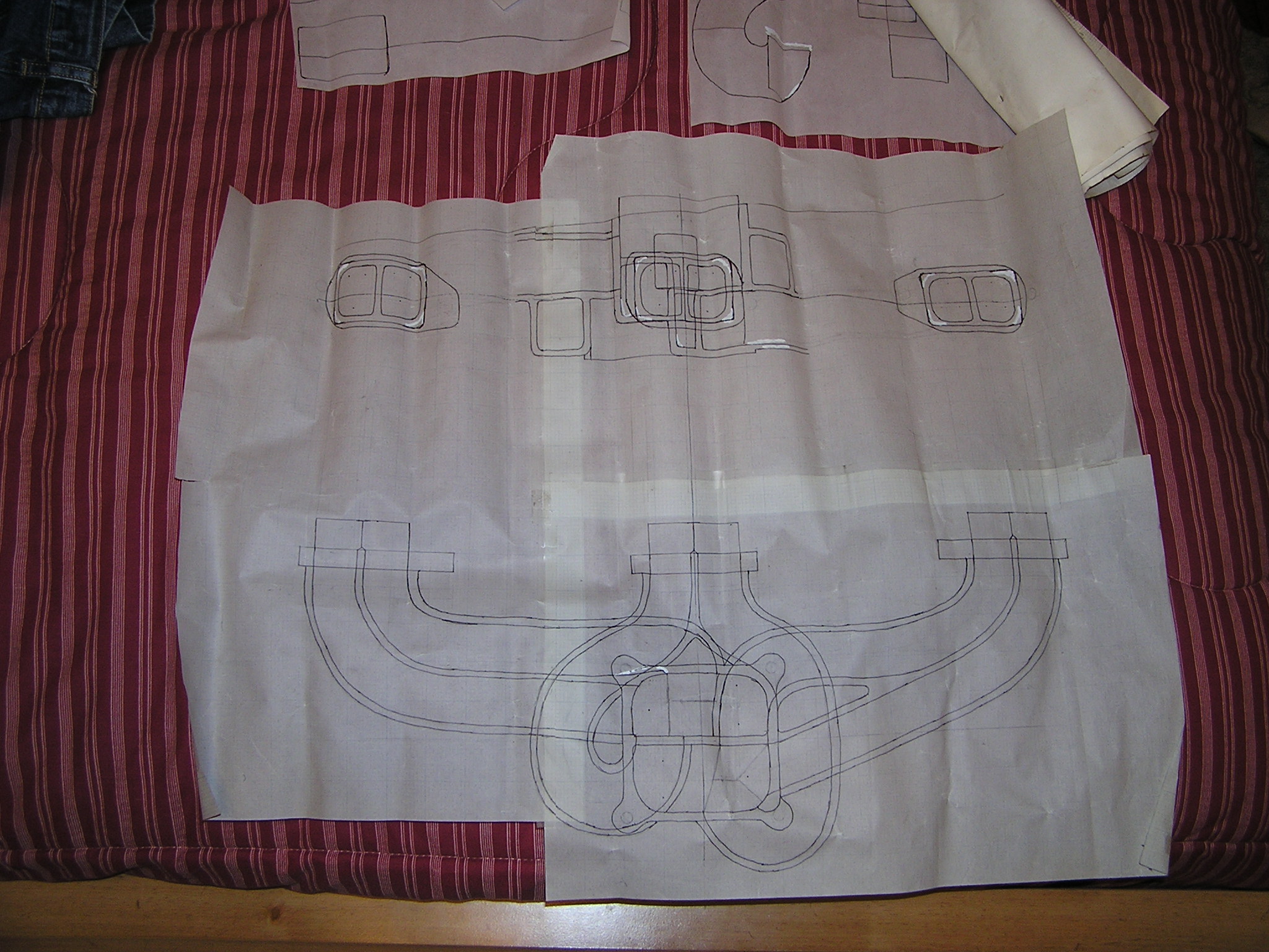

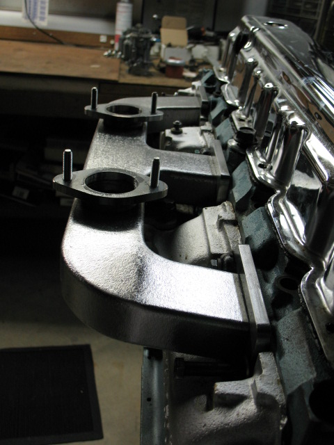

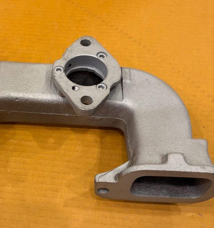

    Posted elsewhere but here it is again. Equal length 180deg 4bbl intake I cast for the 230/260 series Chevy 6.

    When I made my intake, I used the exhaust manifold as a guide to set the level of the intake. I did set the carbs at the same hight knowing I was going to use one large air filter, but there is very little difference in them.

  27. Stooge
    Joined: Sep 9, 2015
    Posts: 594
    Stooge

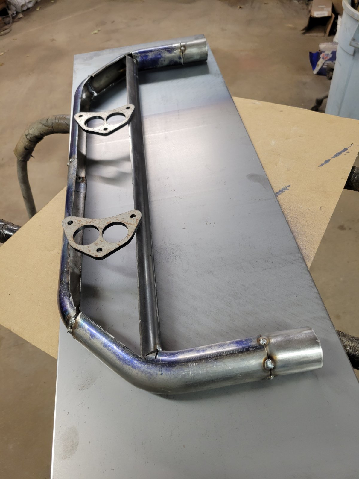

    I didnt add any angle to my intake for the carburetors. From the Edmunds Customs intake i used as a concept, and the Howards 6 carb intakes i have seen for straight 8's, neither had risers on the rear carbs. I have a couple of factory dual carb intakes for the smaller straight 8's with the carburetors still on them, and the rear most carburetor is slightly higher than the front, but i believe it is a fairly minimal difference. Let me know if i can help with anything. the homemade one wasnt as easy as it looks, and between that and the exhaust header, i do have many many hours in to it, but it is doable
