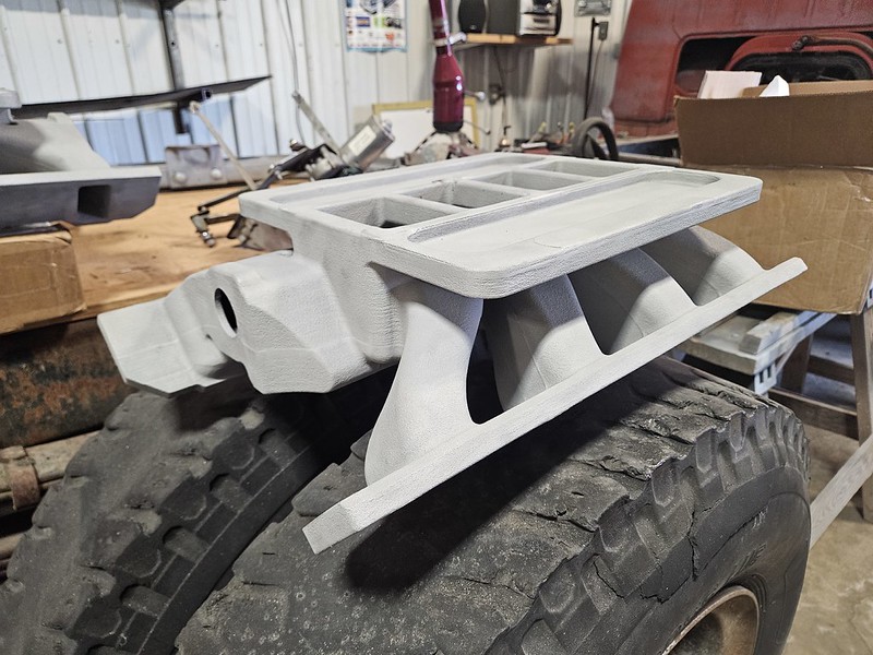

    I am in the process of finishing up this custom intake manifold. 6-71 blower to MEL. I got the first examples from the foundry last week, now I just have to do the final machining.
    Fabricating a sheetmetal intake would be the cheapest and quickest, especially for an inline where the fabrication is much easier, but below is the process I underwent to create the MEL intake.
    I started with an old Weiand LM671 intake, but that intake had a large number of short comings that prevent it from being used on a street engine. The Weiand requires relocation of distributor and thermostat, has a huge plenum that will affect low rpm flow negatively, and interfered with the valley pan / crankcase breather. I wanted to correct all of those shortcomings and build an intake that is much more usable.
    I modeled the Weiand in CAD as a starting point, and then started making modifications to the model to include the items I wanted (thermostat and distributor clearance).
    Eventually the CAD model progressed far enough that I felt comfortable having a 3D printed model made that I could mock up on the motor to check fit, clearances, and perhaps even use on a flow bench.
    Some more changes came about based on what the printed model showed, and I was able to finalize the CAD model. At this point, I started working with FECoffin as he had the foundry contacts to get a couple made. We chose to use a 3D printed mold, and after some tweaks to help improve the mold flow, we had a couple of molds printed up and the samples were poured.
    Finally samples arrived and I am now working on building fixtures to do the final machining. Hopefully that will be completed in a few weeks.
    6inarow, Depending on your goals for the project, and if you need any help developing the intake, feel free to PM me. I can offer help generating a CAD model, fabrication, or whatever else may be needed.
