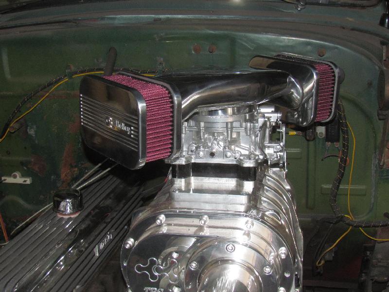

    20160424_123954.jpg 20160424_125523.jpg 20170104_163634.jpg 20170129_151636.jpg 20170226_172517.jpg
    brEad, v8flat44 and samdjr74 like this.
