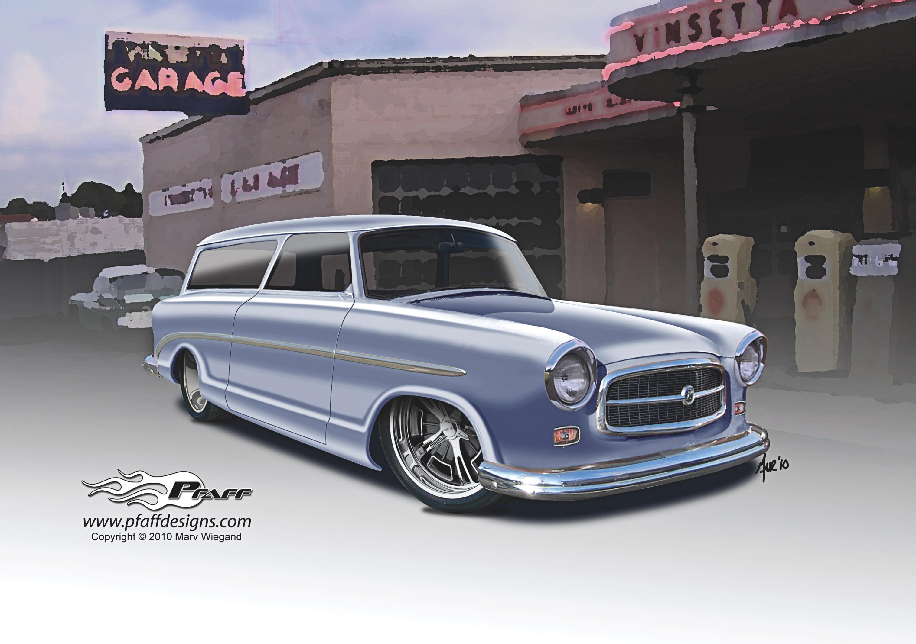

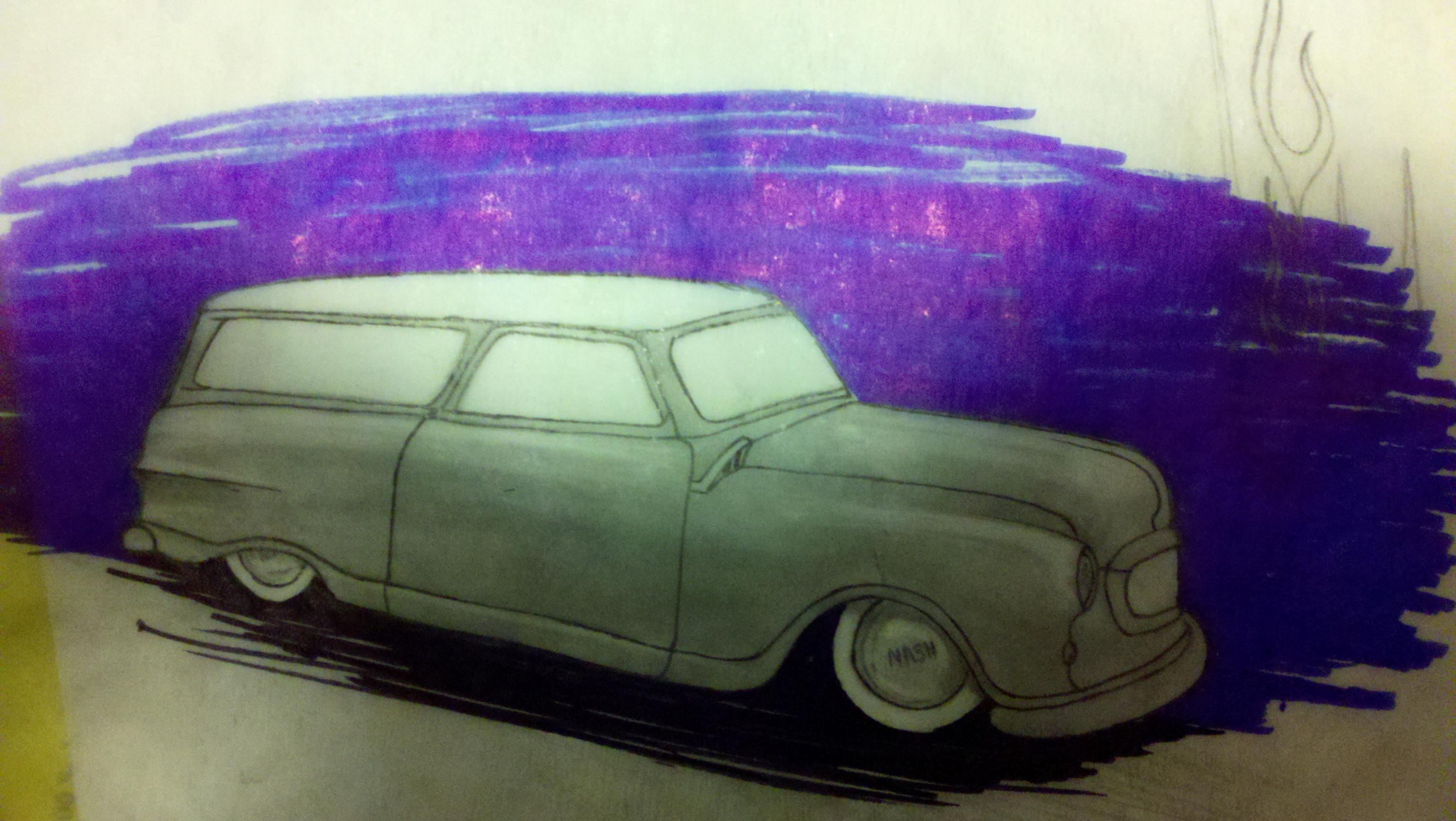

    THE FINAL LAYOUT FOR THE NASH WILL BE OPENED FRONT WHEEL WELLS, REMOVING REAR C PILLAR (SO THERES ON BIG PEICE OF GLASS IN THE BACK) AND A HANDFUL OF SUBTLE BODY MODS THROUGHOUT THE CAR LIKE SHAVED DOOR HANDLES REMOVING THE WING WINDOWS FORD WINDSPLITS AND AN IMPALA DASH TO SAY A FEW

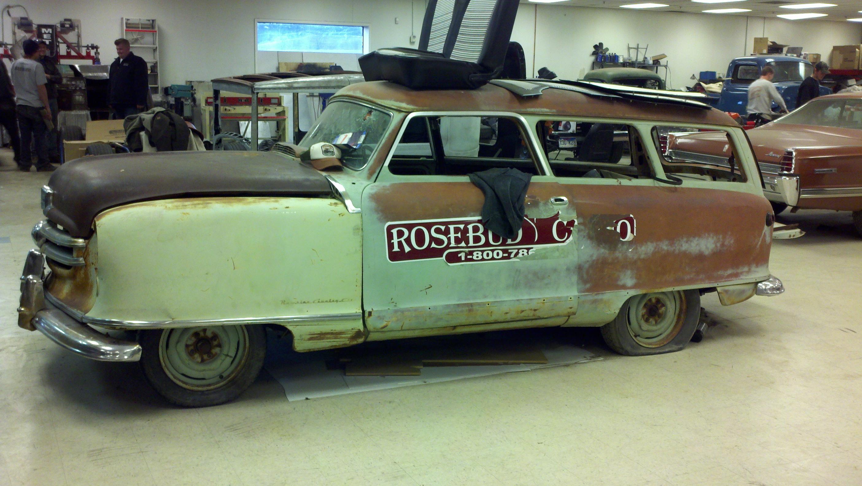

    BEEN GATHERING PARTS FOR ABOUT A MONTH HERES WHAT I HAVE SO FAR
    49 FORD WINDSPLITS
    54(?) FORD HEADLIGHT BEZELS (HAVE A SLIGHT PEAK ON TOP AND ARE STEEL)
    59 IMPALA DASH
    ARTILLERY WHEELS FOR THE FRONT
    49 FORD SMALL BOLT PATTERN 16s FOR THE REAR

    I like it! The fender openings are not overdone, and the side chrome looks like it was born there. Can't wait to see the results.

    The rendering looks good! The one piece door glass really updates the look of the car. Should be enough room in the door for a one piece window, will take a little work, but shouldn't be bad. Might have to knock a front corner off though, like the new cars do with the mirrors.
    One question... what are "wind splits"? The chrome bars in the grille to each side of the "R" badge?

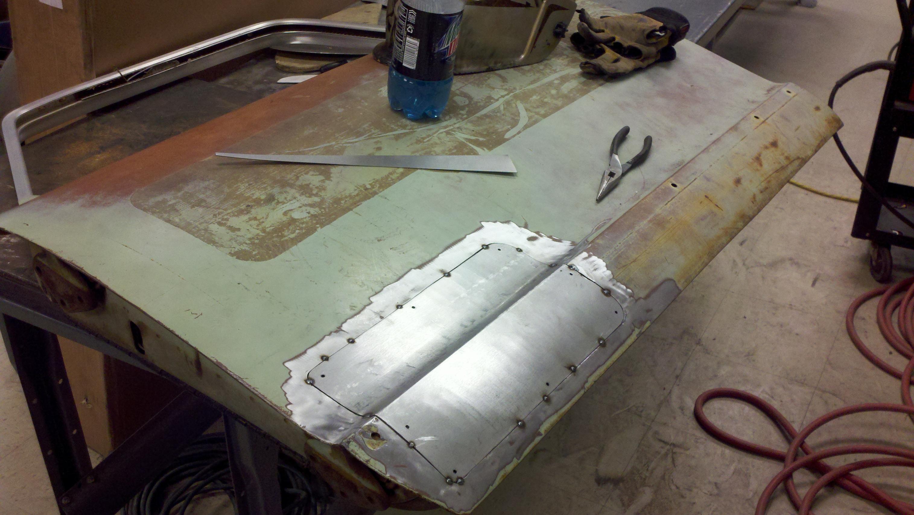

    started on the body, got new fenders shipped from oregon (well, better shape not new) in the process of fixing the messed up hood brace and building new ones. also fixed a tear i may or may not have put into the door trying to get a dent out of the bodyline :eek: good practice lol

    also have a pic of the final look of the car. color not decided yet but body modifications are. will be opening wheel wells up after i get new mounts made for different hinges for the hood

    The hoods are pretty flimsy! Those added braces will certainly help a lot. There should be a rod on each side from the rear support toward the front sides also. Might have only been on later models?

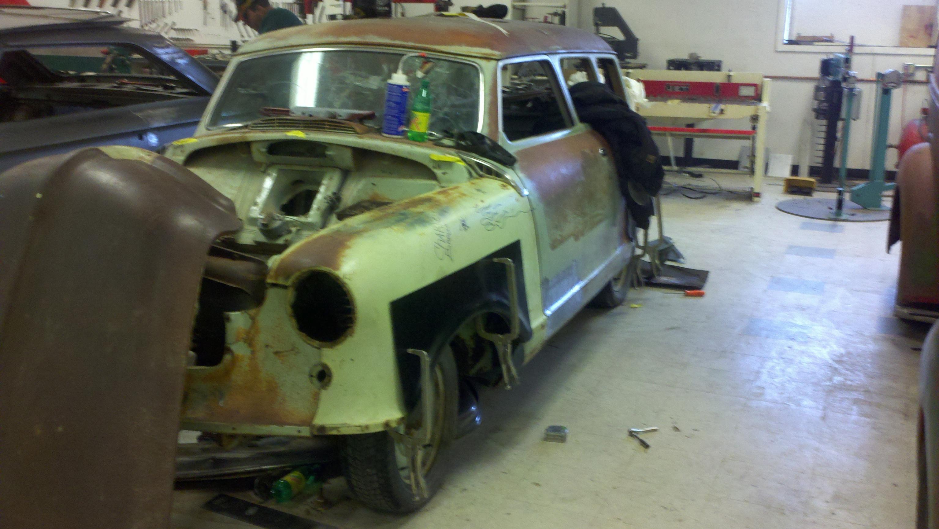

  14. more updates today, got started on the wheel wells no turning back now! just have stuff mocked and a rough cut out of the opening dont worry about wheel alignment in wheel well that will get fixed when i make the frame

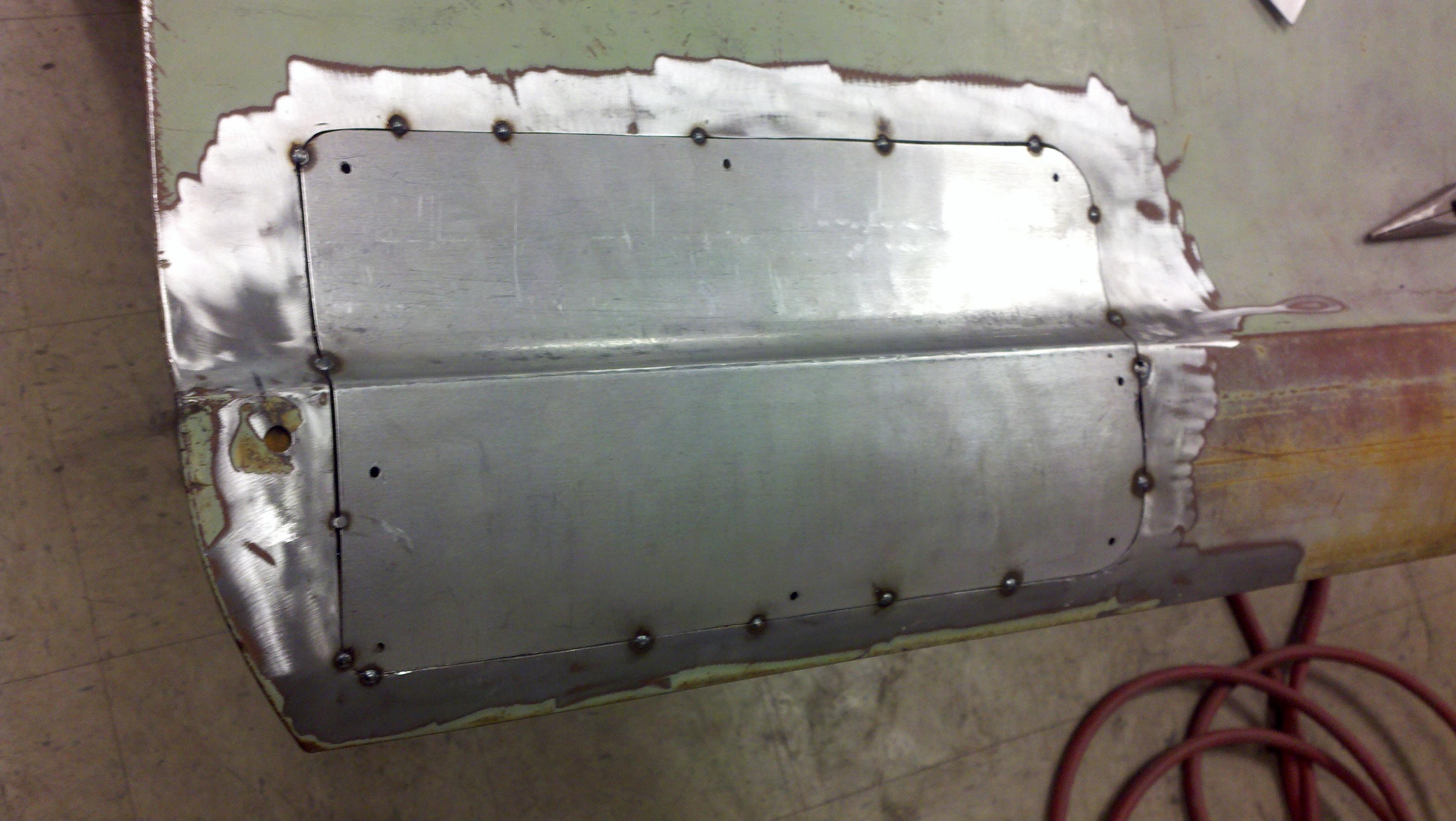

    If the 54s don't suit you then you're right -- no point in using them! What patch panels are you using for the openings, or did you make those?

  17. Wheel wells are already cut lol. Farna I used 67 through 72 chevy pickup upper lip patch panels there only 20 bucks a piece and with a little tweaking they fit perfect! Ill just taper the rear of the openings and it will totally change the look of the car.
