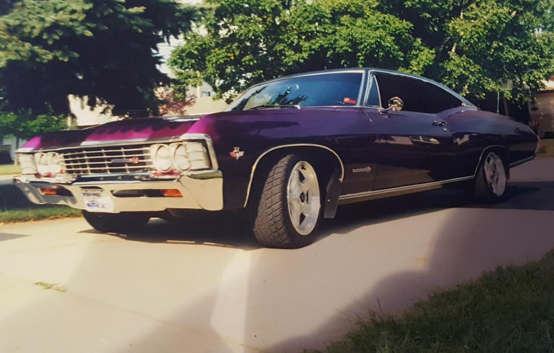

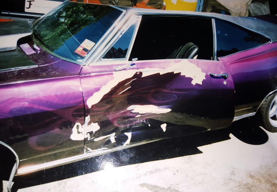

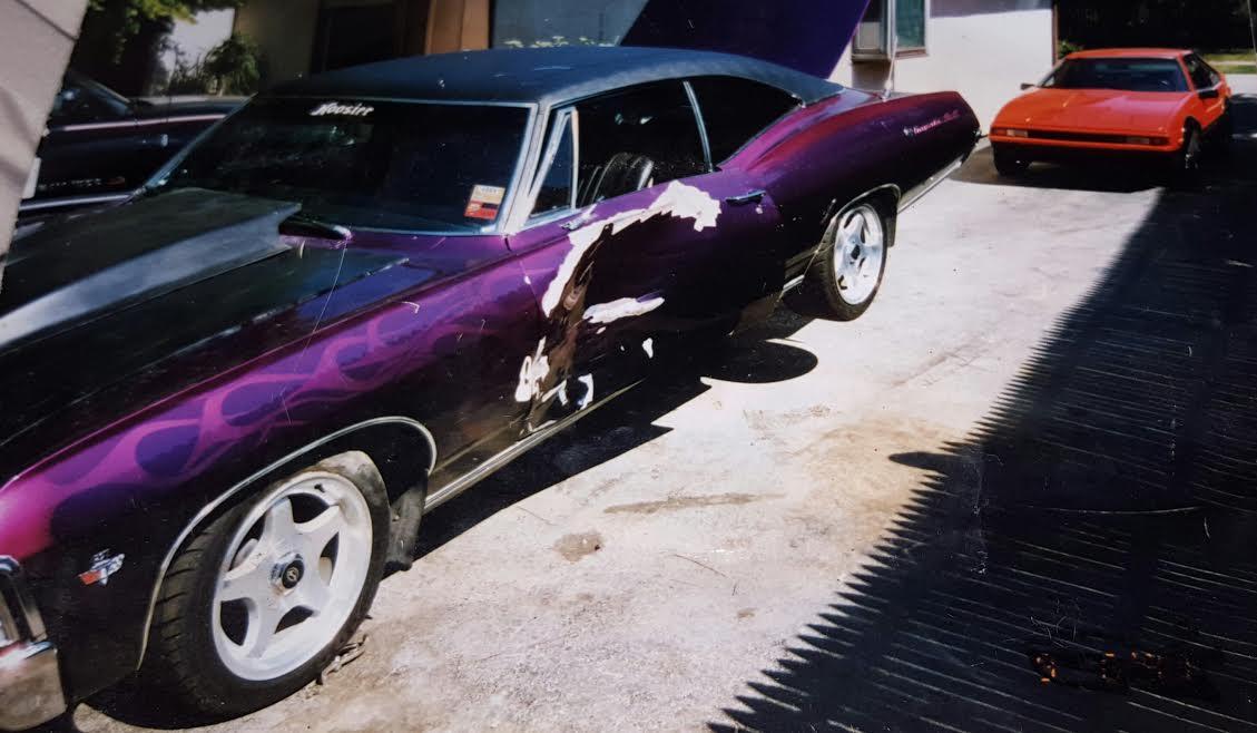

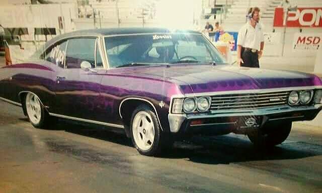

    Hi guys been awhile since i posted, but i have a project i am helping a buddy out with. Seeing my years in the body/paint world is still a pin ***** to some of you guys out their. My buddy is having this paint job re created on his new/old OT 67 impala to recreate the purple one below. I will be painting this, but need help selecting colors from a few extra people with a good eye. Secondly going about this spray job i have a little info from an old panel we had sanded down.

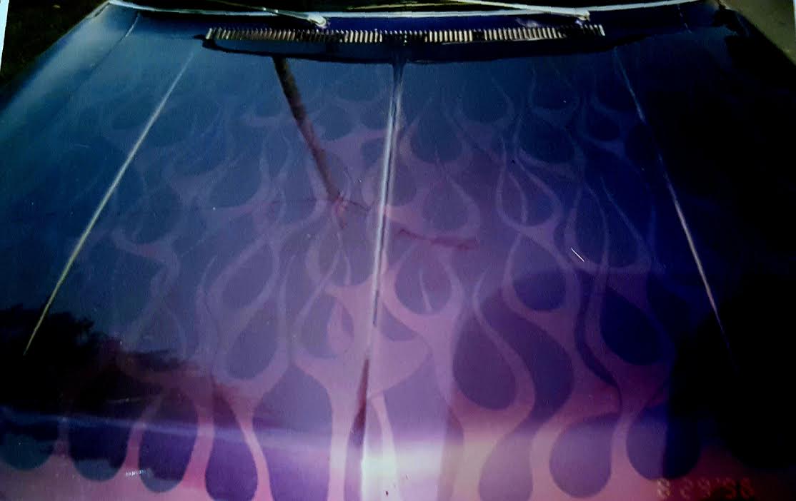

    Looks to be sprayed a purple then flames painted silver with either a pearl with reducer sprayed over it, or base mixed in clear? I have done one ghost flame job in my career and that was on a motor cycle tank but went a different route than done on this car.

    To me it looks like they put a red "interference" pearl coat over the purple for the flames. Also called Flip Flop Pearl, if done right, you don't see it in the dark, or under some lighting, but when the light is at the right angle, it lights up. You have to experiment to get the right mix of pearl to clear, and amount of coats to get it right. Too little, and you don't see it, too much and it's there all the time, or gets 'milky' looking.
    Joe, your car would be very close to that color, if it was over a white sealer, and Bill throttled the fluid down a bit, or put on less coats. But it would have been harder to get even coverage with such a translucent color.

    Exactly this car would look like a borderline deep purple/black at night and you could barely see the flames. He is insisting the paint job be the same or pretty close to matching colors.
