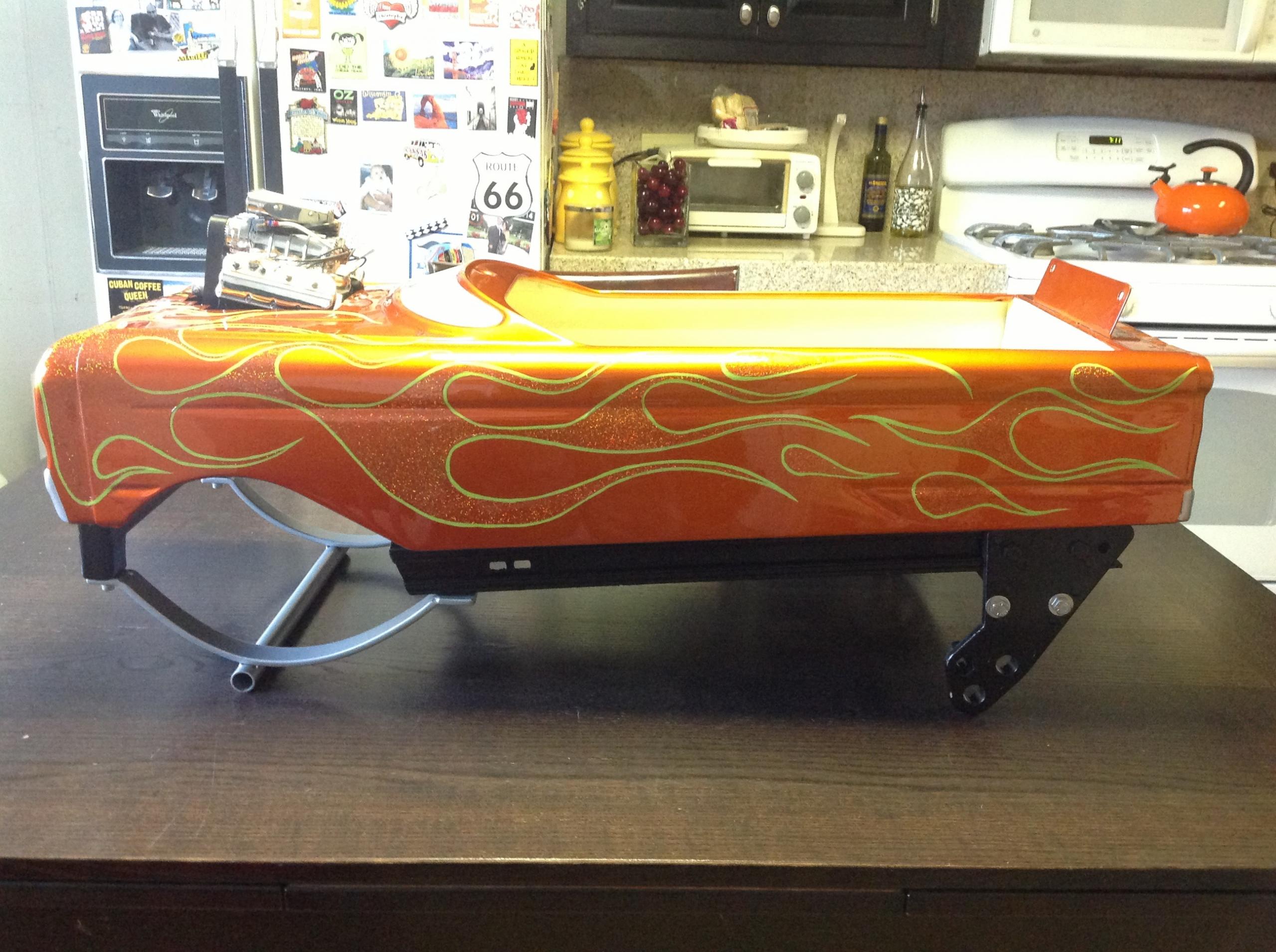

    I went with a pull style, still needs some bodywork, inner fenders and the stacks installed. He picked his color this weekend, and is super excited about "his car" ImageUploadedByTJJ1366760878.447631.jpg

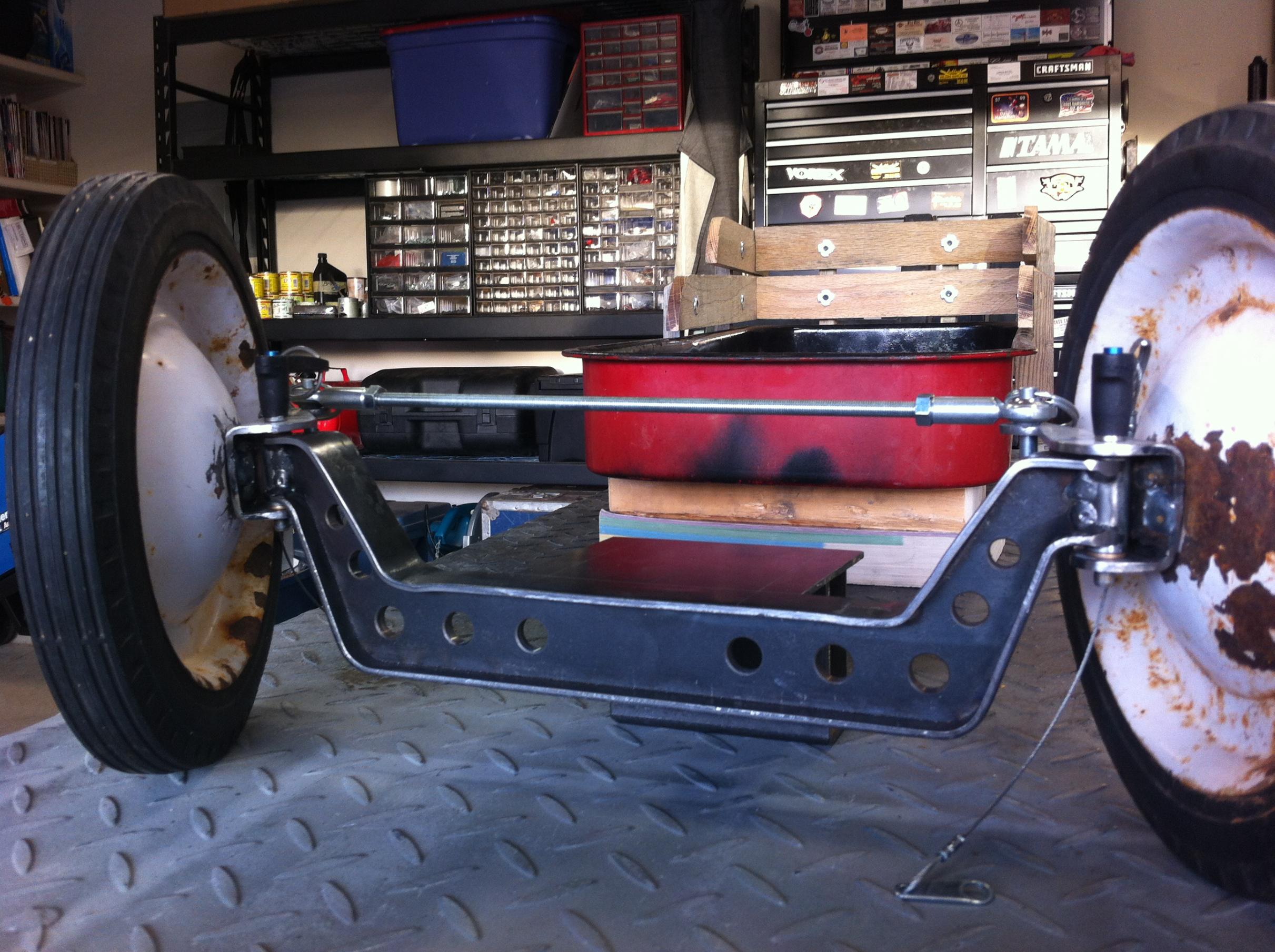

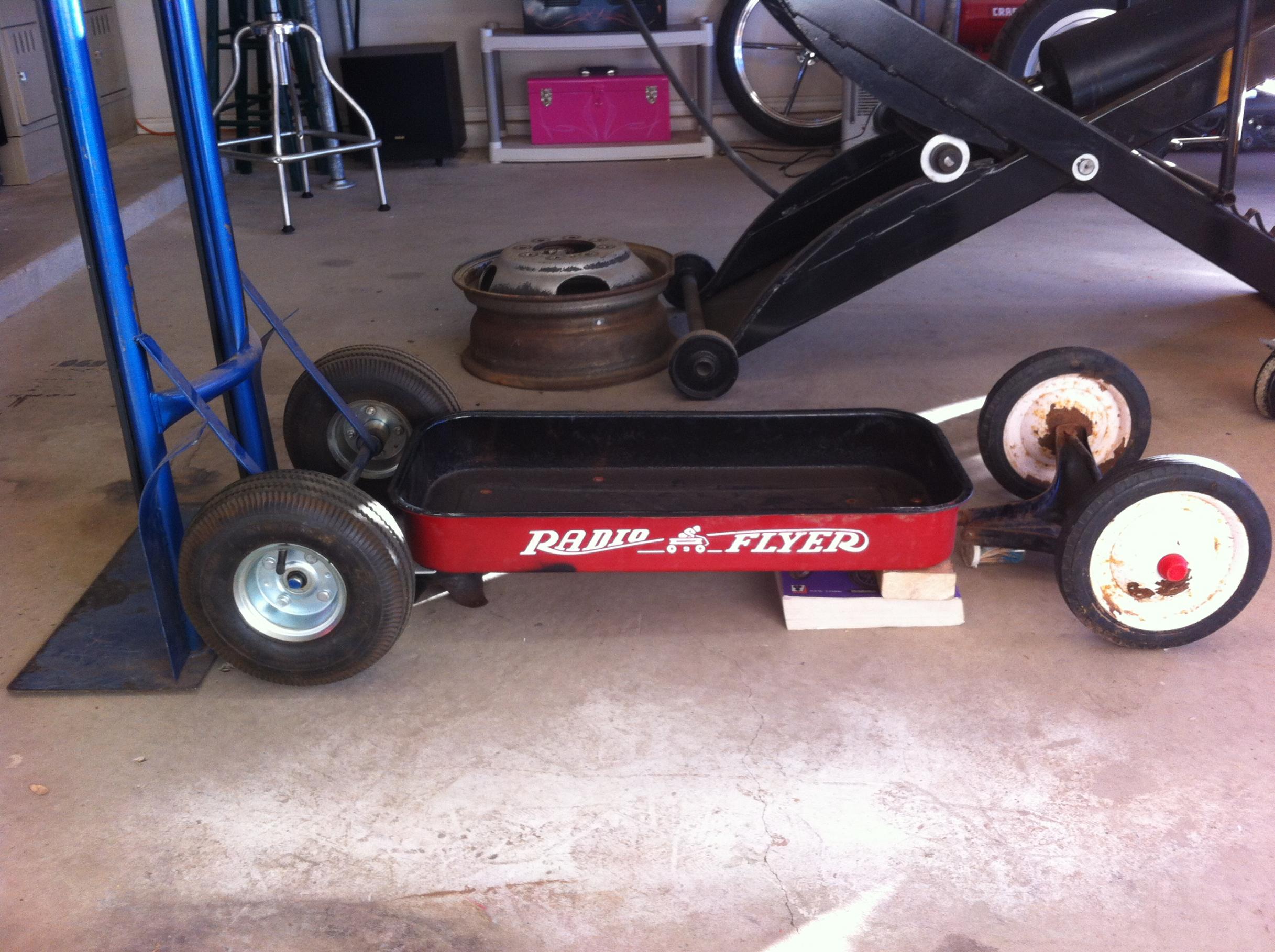

    Hello, all...New here. In short, I decided to build a wagon for my nephew. The songs remains the same..." a weekend and 25 bucks will give me...ahhmm my nephew a pretty cool wagon to cruise. I new I wanted it to pull as a wagon and to be used as a stroller. Now the fun begins.
  22. MOTODOJO
    Joined: Apr 23, 2013
    Posts: 13
    MOTODOJO

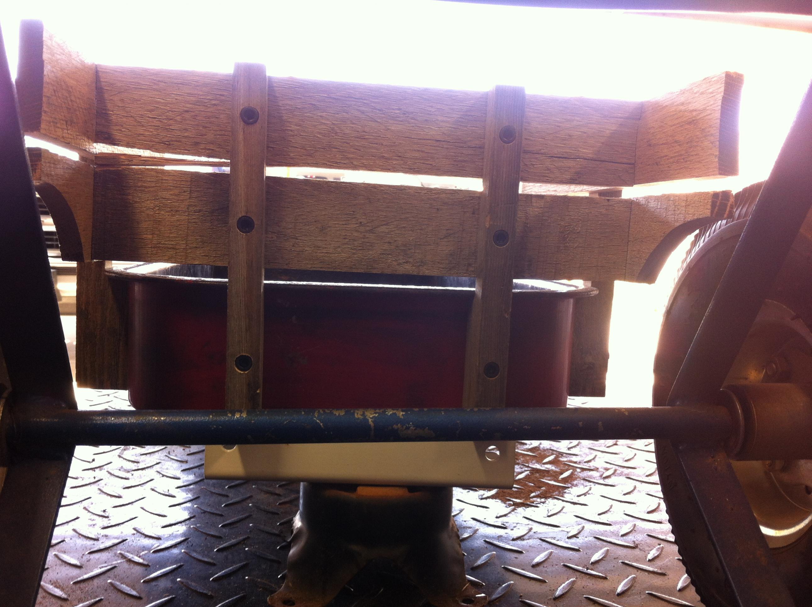

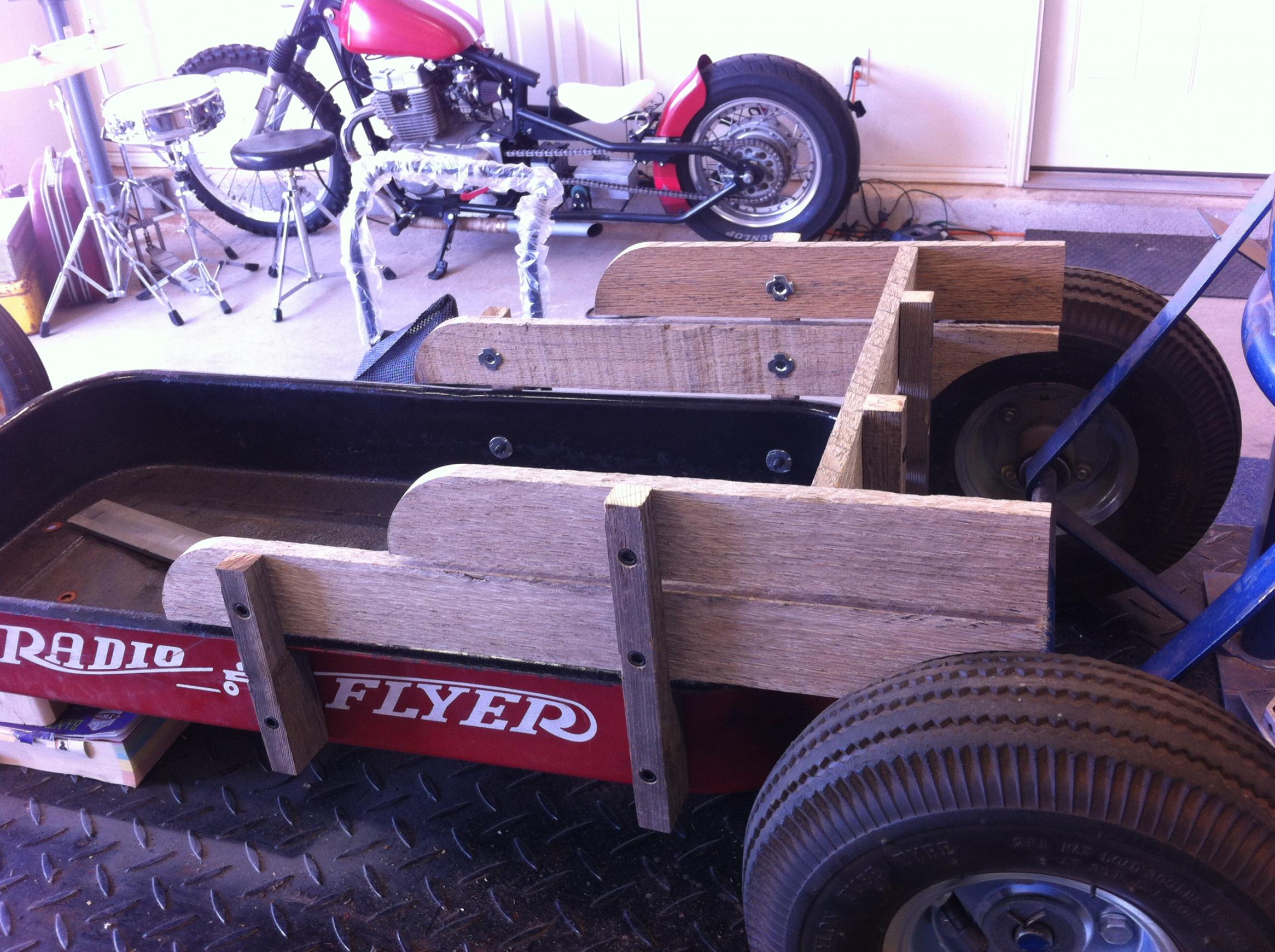

    OK, so I have the desired stance... I have a wish list. Drop I-beam axle, Z'd frame, rear pie crust tires, etc. The steering scared me so I'll worry about that later. First for the wooden "gates". Re-purposed some old pallets. I recessed black oxide socket heads into the uprights so they could rust a little. T-nuts for low profile in the tub. The fresh-cut portions of the would was aged with a rub consisting of water and charcoal. I'll shape the uprights later. Squaring off the wood in the corners doesn't appeal to me , so I carried on a "fin", and incorporated a radial cut-out that was concentric with the tire and axle.

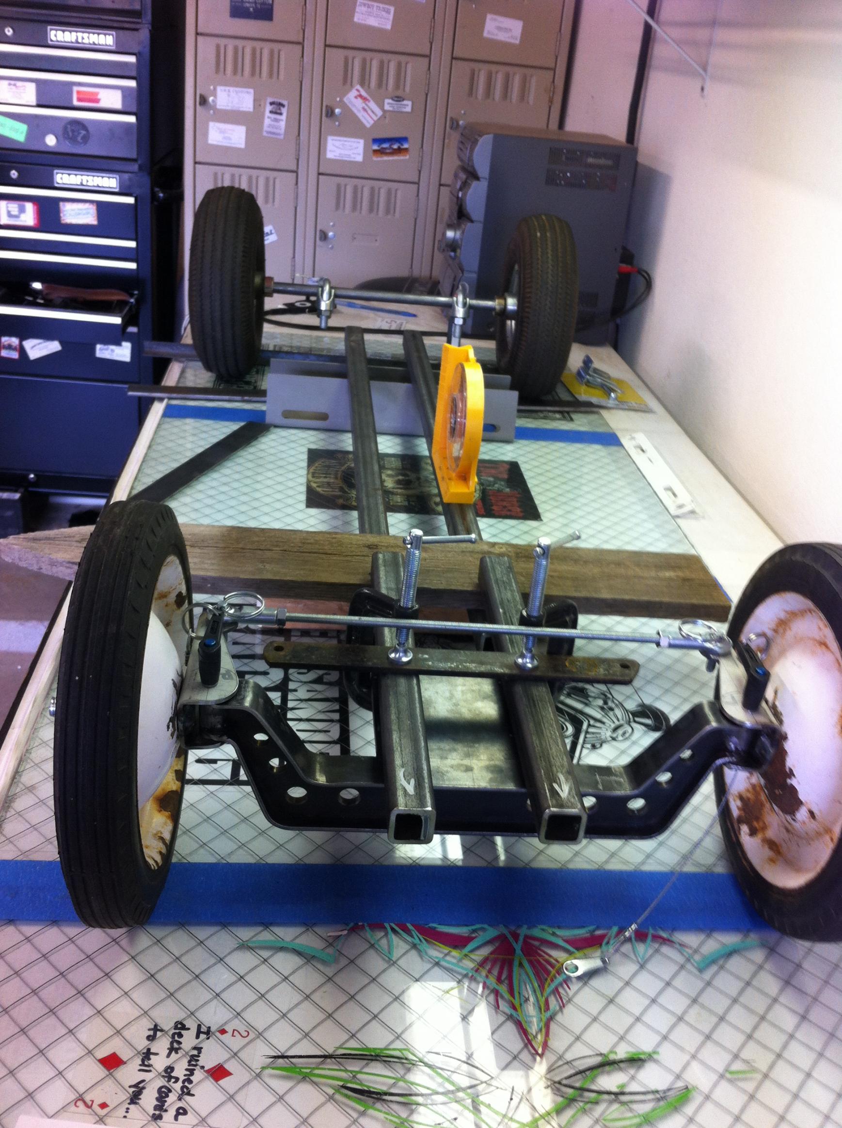

    Wicked, great frame... simple, effective. Gettin' the axle comin' around. I used strap on the bottom to make the I-beam, but used plate on the top cut to look like strap. This affords me the ability to bolt the axle to the underside of the frame.
  26. MOTODOJO
    Posts: 13
    MOTODOJO
    Done with the axle...damn bronze bushings are high!

    MOTODOJO
    Setting the stance for Z-ing the frame front and rear. measure 20 times cut ummm... twice. forward 3 deg.
