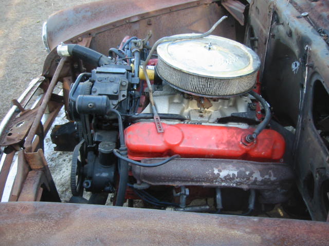

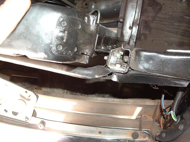

    here's some pics of what I'm dealing with. I have just enough room for the aluminum rad and clutch fan I got, but I need to move things forward a bit.

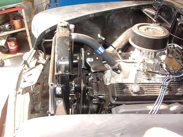

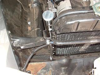

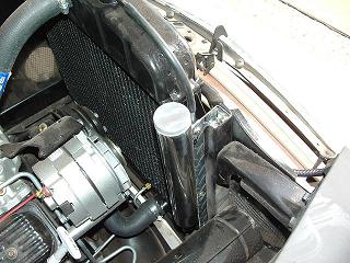

    OK here you go 55-57 chevy rad mounted in a 1950 chevy. I made brackets out of aluminum 1in.x1in. on the left and 1in.x3in. on the right drilled to mach the radiator and the mount. The long side on the right was used to mount the over flow tank. 10 5/16 bolts and nuts and there you are. A nice clean radiator install. All I need now is an electric fan and a fan switch.

    One pic too big and the whole mess gets dumped lets try again.

    ok now i have a couple ? if i may. what size engine is that obviously its a sbc and i would ***ume its a tri 5 rad right and at what temp does it usually run at idle in traffic thanks i have a 54 and i am building a new support cant afford a 500.00 rad ya know

    You're going to need to cut off the top of the radiator support to almost put the radiator through the support, or in front of it at least. That mopar will never run cool if you just use an electric fan, take my word on it. You'll need an aluminum radiator, a mechanical fan, and a good shroud. Don't be afraid to cut the radiator support. Fit first, finish later

    The engine is a 350ci. The radiator is a 4core w/trans cooler for a 57chevy. Price 225.00 at my local rad shop. I dont have this one finished yet, but the 51 we built three years ago still runs cool and has given us no trouble.
