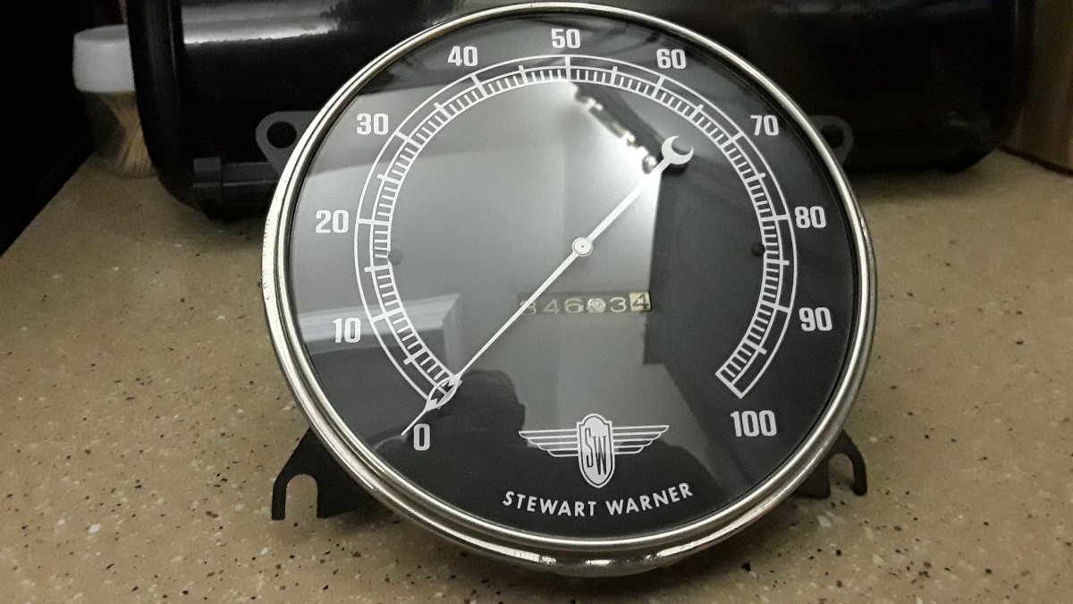

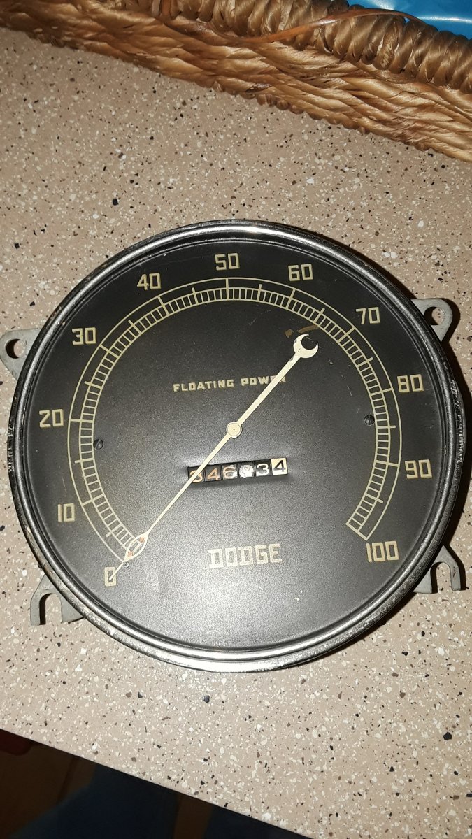

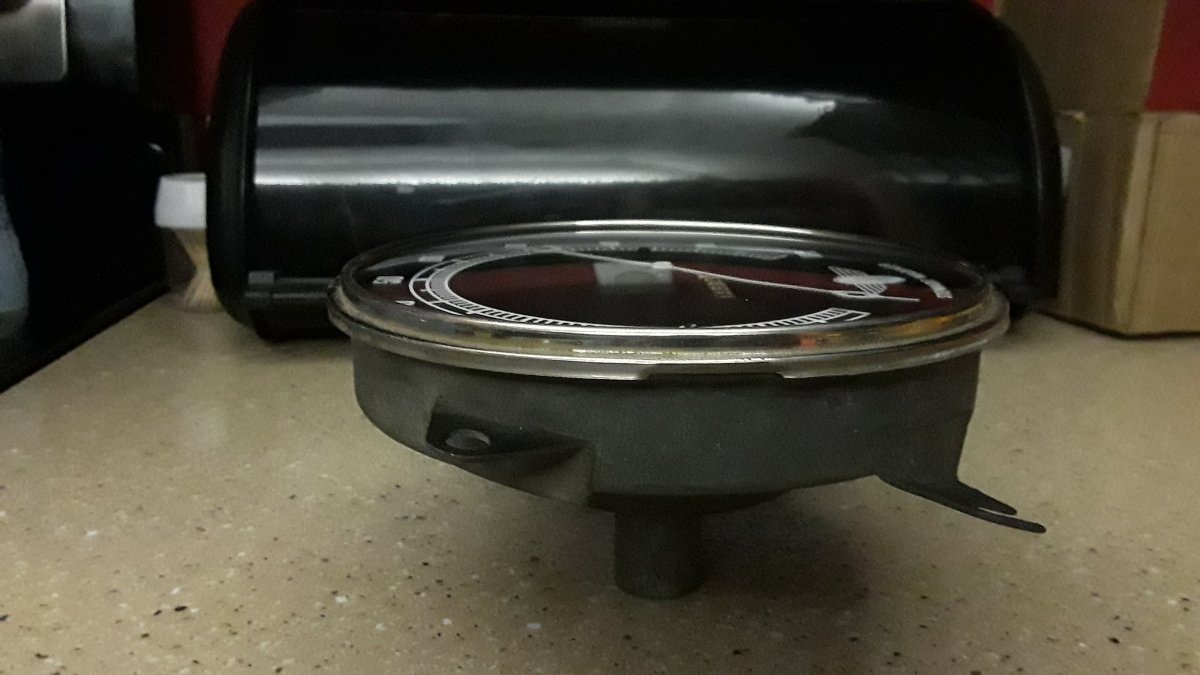

    Decided to redo the face on this 35 Dodge speedometer to match the other Stewart Warner gauges I'm using in my Model A. Made a curved lens for it in the oven. Heated the 1/16" plastic to 300 degrees and shaped it between two gl*** bowls. 20210106_185929.jpg 20210106_185904.jpg 20210106_150100.jpg 20210104_201123.jpg

    @Noah* , Nice. Can you give us a little info on how you created to dial face?

    Awesome job and please share your process

    Definitely share some pictures of how you created the face! That looks OEM, nice work!

    I make signs for a living, so I built the Stewart Warner logo and the numbers in my sign software. I painted the face and applied cut vinyl lettering.
    To make the lens, I cut the circle out of 1/16" plex on my cnc router. I removed the paper protective coating and put it on top of a t-shirt on a cookie sheet. I baked the plex at 300 degrees for 10 or 15 minutes and put it in a bowl with the correct radius. Once in the bowl I put a second piece of t-shirt material with a smaller bowl on top and let it cool.

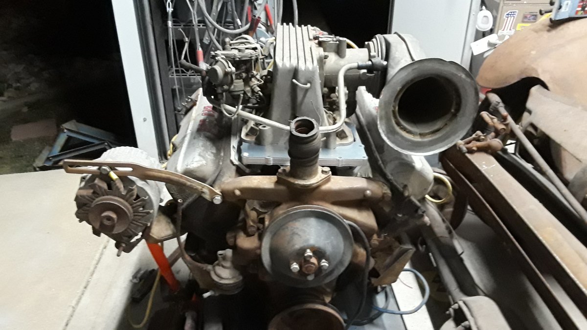

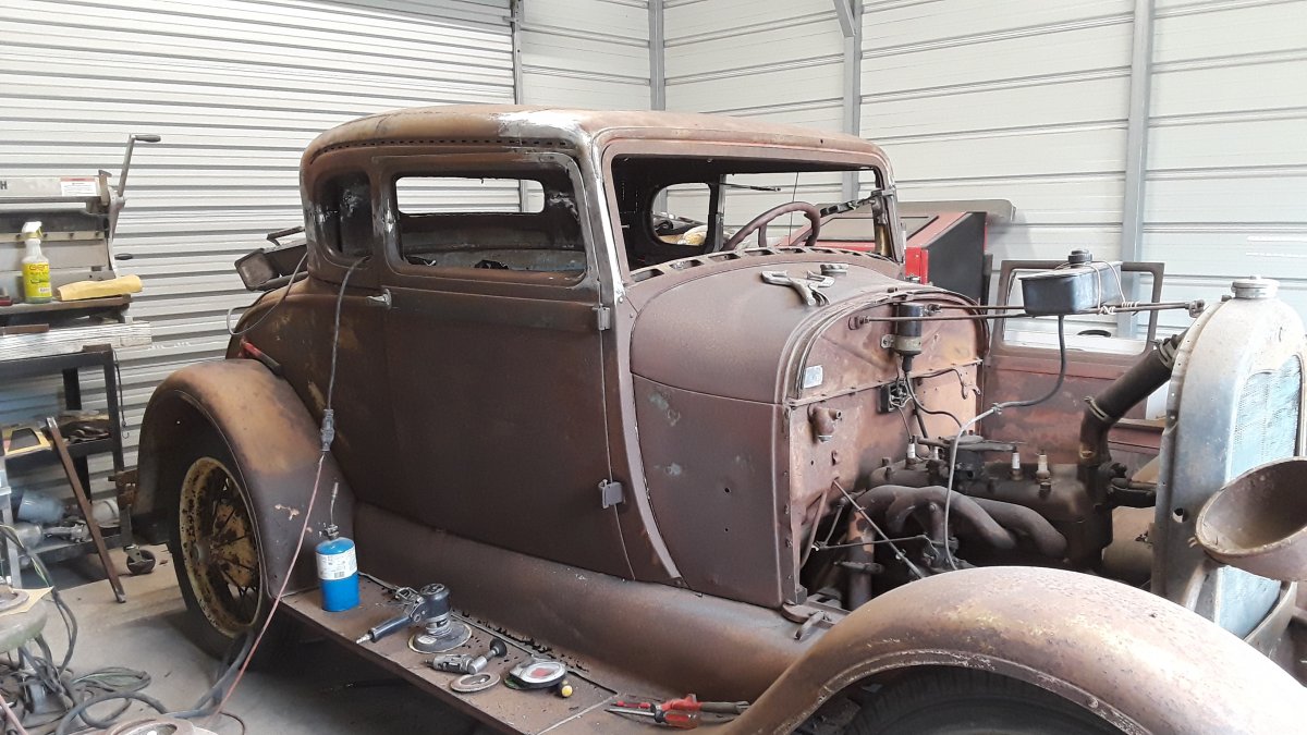

    Here's my Model A project. 32 front roof section and windshield. I have a 32 frame for it as well. 270 Dodge with a 59 Corvette Fuel injection adapted to it. Have the hemi heads to convert the poly. I made the intake. 20201025_150709 (1).jpg 20201128_180512.jpg 20201116_180219.jpg

    What are you going to use to drive the FI fuel pump?

    Cutting the fi distributor to fit the dodge

    Expensive cut!
    Can you buy an after market baby hemi tack drive dizzy and if you can would the gear ratio be enough to compare to the GM pressure?
    Count the teeth count on the gear of that FI dizzy and maybe the diameter. I would like to know if it's close to my SBC magneto's, if it is you could cut a mag instead of the FI dizzy?

    Brian B*** is going to cut it for me. He has cut several sbc magnetos to fit Hemis, this is no different.

    Personal opinion: I'd keep the Poly heads on that motor. There are a lot fewer of them in hot rods than are hemi headed. Most people have no idea what they are. People think the scallops on the valve covers of the Chevy 348/409 are cool. That being the case, 4 scallops on the Poly vs 3 on the Chevy means the poly is 33% cooler.

    I have always liked that look, and have thought long and hard about doing it that to my '29.
    Trouble is finding the roof section and windshield frame.
