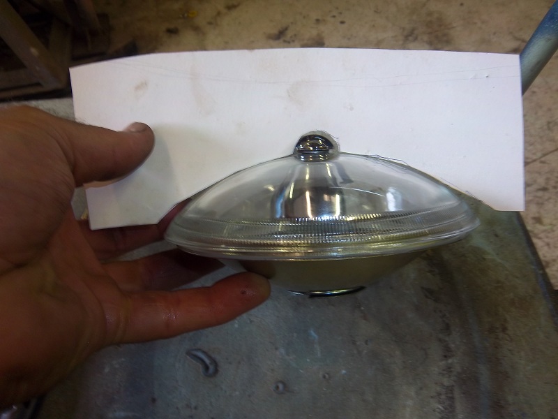

    First, I made a template of the curvature of the headlight, so I could match the tail lights to it. They were already very close in size.
