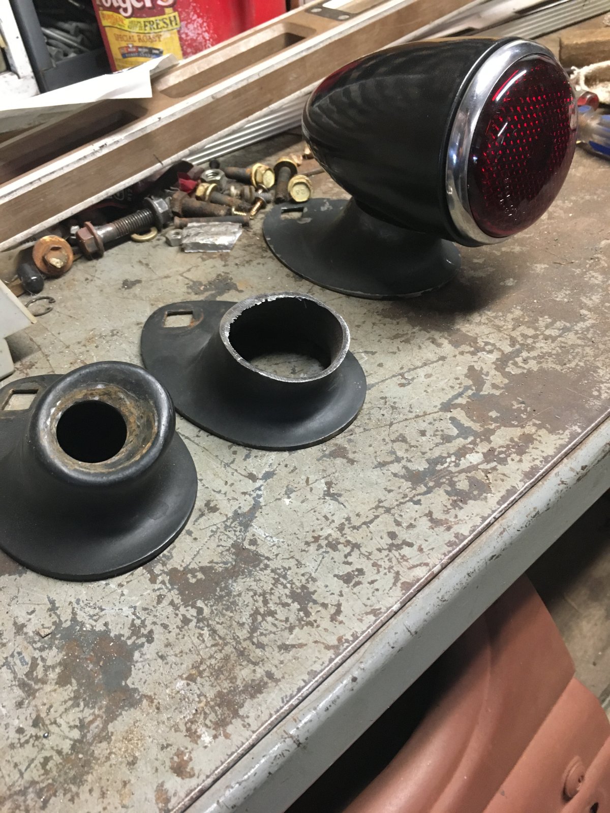

    Here’s a stock headlight stand on left. Center has been cut down on a chop saw and ground to better accommodate the bullet shape of the tail light. 82A530E5-6B84-4522-8054-5BF6D0011D17.jpeg

    I found two large flat washers and ground them to fit the opening. Measured and marked them for two mounting screws to bolt the taillights to the stands.tack welded the washer to the inside of stand. I could’ve just welded the tail light bucket directly to the stand but opted to make it bolt on in case I didn’t like the end result.I had to use an Allen screw for easier access to tight area. 4372CE76-4C9A-4049-8A9D-695D76C3B4EF.jpeg E688B1EF-FA78-4516-B256-5D5D1FC83402.jpeg

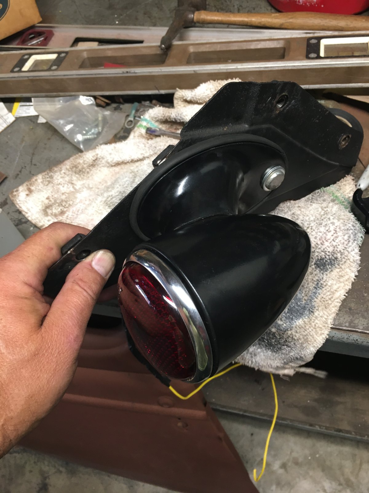

    Added a second hidden tab with stud to secure the stand to my rear body gussets. Tight squeeze but you can still remove screws to dis***emble tail light. 43CC38B2-1A62-4EE1-A0CD-7357F2221B1C.jpeg 021EE89C-01A7-4E9E-BF9F-FC0B88293E1A.jpeg 7AE1E6E1-024F-4D19-96F9-4D6BFAA2E58A.jpeg 87D4336A-1964-46E4-B973-F7467925C942.jpeg

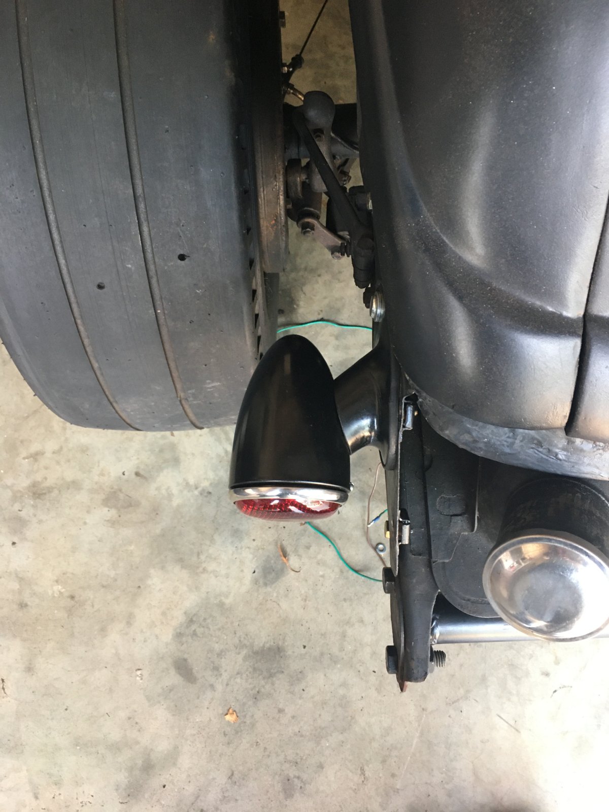

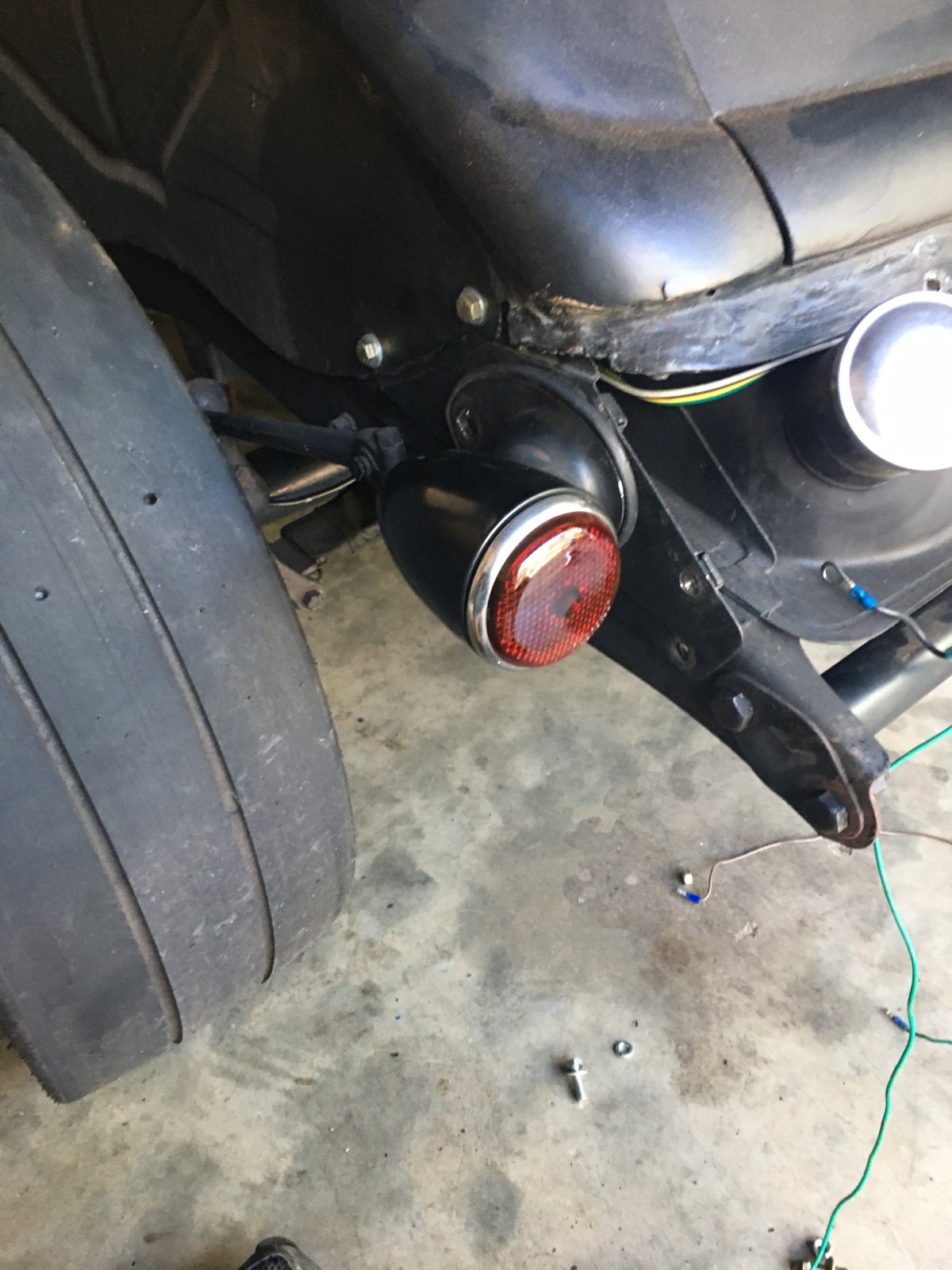

    End results. I hope this illustrates how I made a cool and unique pair of stands . EA7DAF2F-3598-48C9-A8E6-E9AD201BE8A9.jpeg D1CBB765-5018-42C4-A540-B99A1634AB94.jpeg 95F82B17-CDDF-42B2-A9D0-FBDF73EF672D.jpeg 900C7CBE-098A-4450-8B55-97127085B300.jpeg
