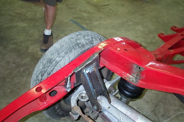

    Wow. Just Wow. I've seen/ fixed a lot of suspension messes, unfortunatly a lot of them out of so called "pro" shops but this one takes the cake. Too be this bad and to charge you that much is just sad. I wish shop owners like that could face criminal charges, he robbed you of a lot of money, don't see much differance if just pointed a gun at you and took the money!
  3. badshifter
    Joined: Apr 28, 2006
    Posts: 3,637
    badshifter
    Shops like that are the reason my shops Product Liability Insurance is so DAMN HIGH. This seems pretty clear cut, not a he said she said. Call em out! Name names.

  6. 8-9-duck
    Joined: Mar 25, 2008
    Posts: 63
    8-9-duck
    please DO NOT DRIVE this thing! call a wrecker service or rent a trailer ! wholly **** ,i'm scared just looking at it. jr

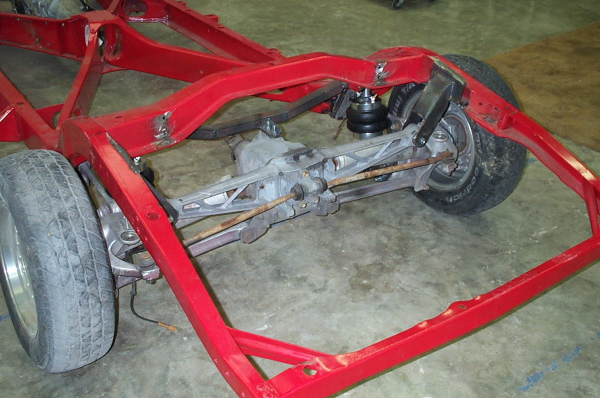

    That's just so retarded. I'm trying to think of what he was thinking. How can the center of a rear-end be bolted solid to the car?! [well he saw it on a corvette IRS once so figured it would be okay.] Just goes to show you don't have to p*** an IQ test to open a business.
    And the money you spent is just crazy. Always get at least TWO estimates.

    Also whats up with the shocks being mounted so close together? is it just me or does it look like they are like 6" apart on the upper mounting points

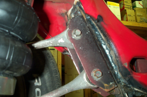

    O.K. I adjusted the the brt/cont on the photo and I still can't figure out what the **** he's done here.:rolleyes:
    Is there a hinge bolted in there?

  14. Wow ... this is one situation where the term "FUBAR" actually fits (****ed Up Beyond All Recognition) ... It actually took me quite a while to figure out exactly what it was that I was looking at in those pics ...
    I am speechless ... absolutely speechless

    I can't figure this out either. Looks like there may be a bolt that fits "loosely" through both plates?

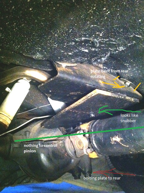

    Looks to me like the 2 steel plates act like a badly designed pinion snubber. One is bolted to the body under the back seat, and the other is bolted to the rear end above the U joint. It may have a loose bolt that goes through both plates to try to keep the rear end centered. A 3rd grader could design a better setup then that for a push cart. Like the people before me said, do***ent everything before you fix anything. Don't drive it anywhere as you will be libel, now that you know how ****ed up it is. Good Luck.

    It looks like they tried to make some sort of pinion snubber? The bolt sticking through on the lower plate is a bump stop and the plate above is what it's supposed to hit or ride on? What a mess.

  25. To me it looks like the plates have moved from their original ill fabricated design.
    as the rear end wanted to rotate up the plate would stop that by using the floor board drive shaft tunnel to stop it. A snubber would allow movement then stop it
    It looks like That was fitted tight so that no movement was possible, but was unable to control the movement and bent. The bolts appear to be puling thru the floor board and are now loose.
    Whether that was his original design, or second thought after inital failure. Some one knew the problem was the rear had no torque control and that's the best solution ***hat could conceive at correcting the problem.
    Just picture the end of the plate being tight to the pumpkin and you'll see what's been bent

    this is what i guess is going on in the picture

    If that's the ride height, it musta vibrated like hell with that positive pinion angle as well.
