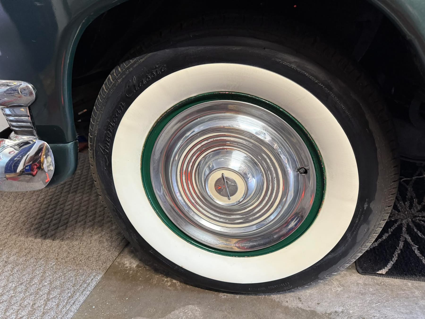

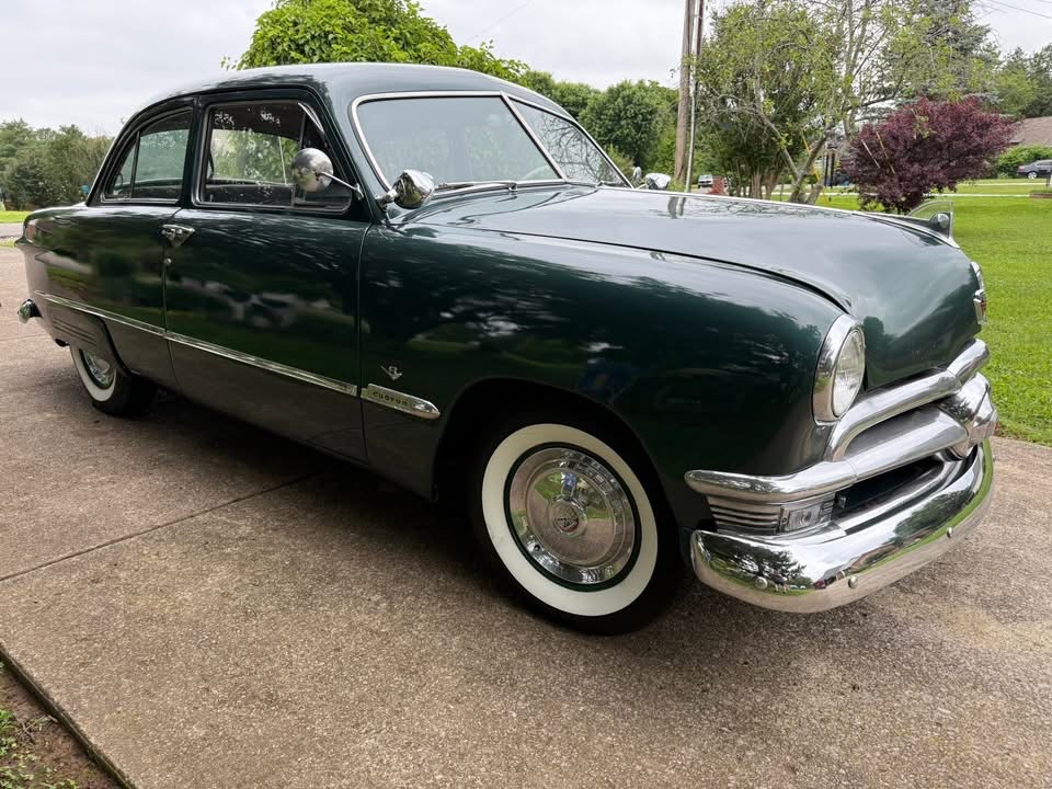

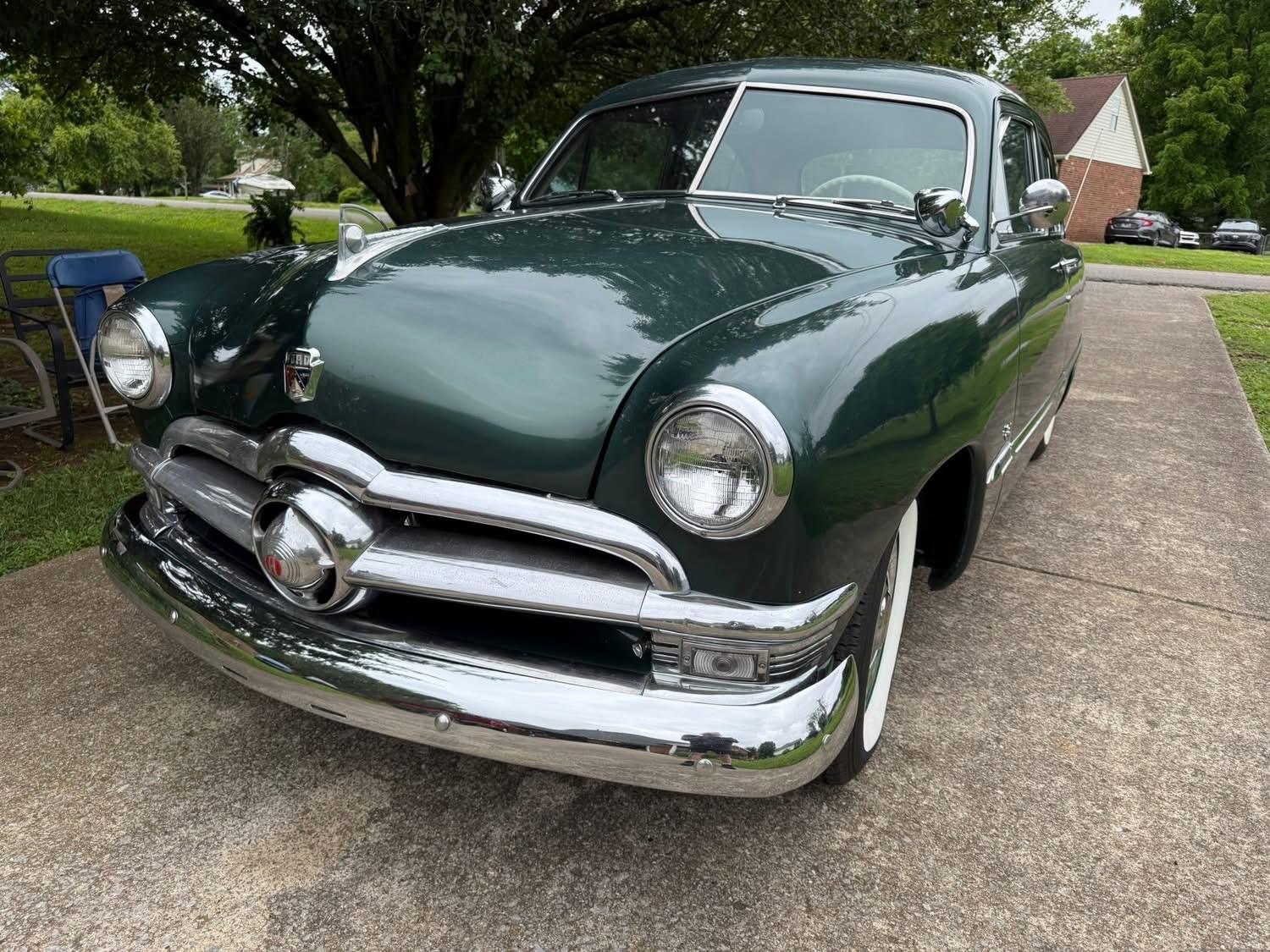

    I have a 50 shoebox that I want to put custom wheel covers on. I seem to be running into a problem with fitnent issues. It is not fitting my wallet nor the wheels. I don’t want to keep buying wheel covers for them not to fit. I am running ford wheels although I don’t know the year they are 15” wheels
    So far I have gotten and tried:
    1956 Cadillac wheel covers. Much to deep but they have the right look.
    1953 Oldsmobile hubcaps with spinners. They have the right look as well but they are also too deep, just not deep as the caddy covers.
    1955 Olds wheel covers fit Fine. But not really the look I want to go for.
    I don’t want to buy anymore until I know they fit. Some others covers I like are
    1957 Lincoln Premier wheel covers
    1957 Dodge Lancer covers
    1959 Dodge Lancer covers(I really like)
    1949-1954 Polara covers

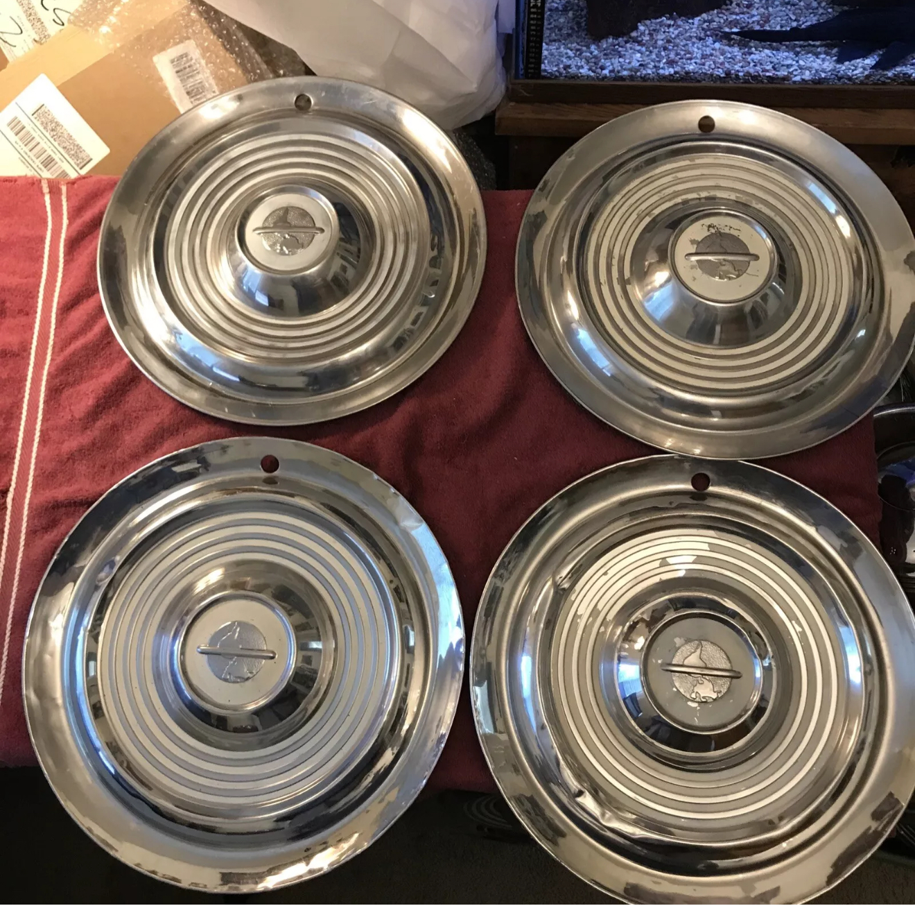

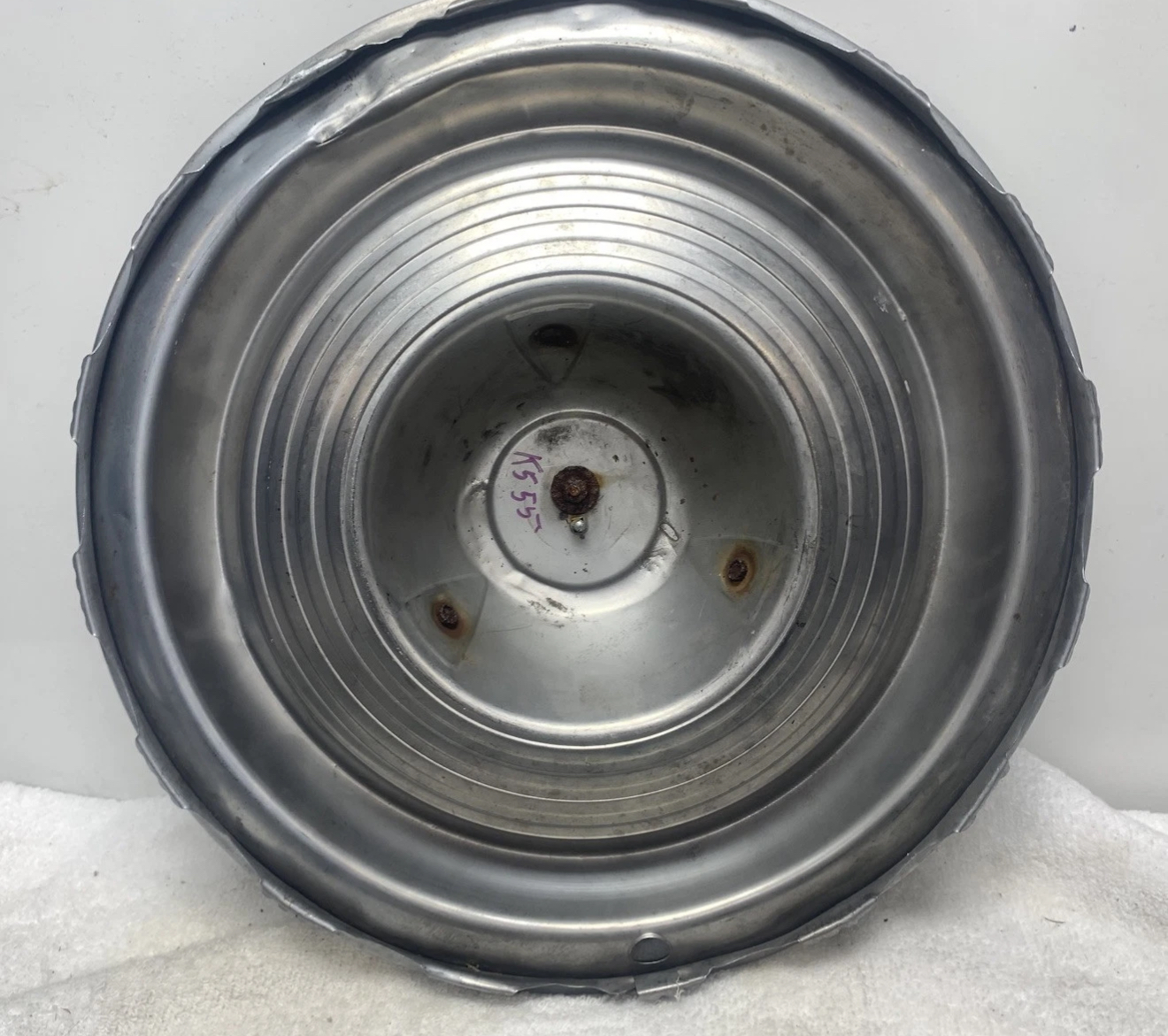

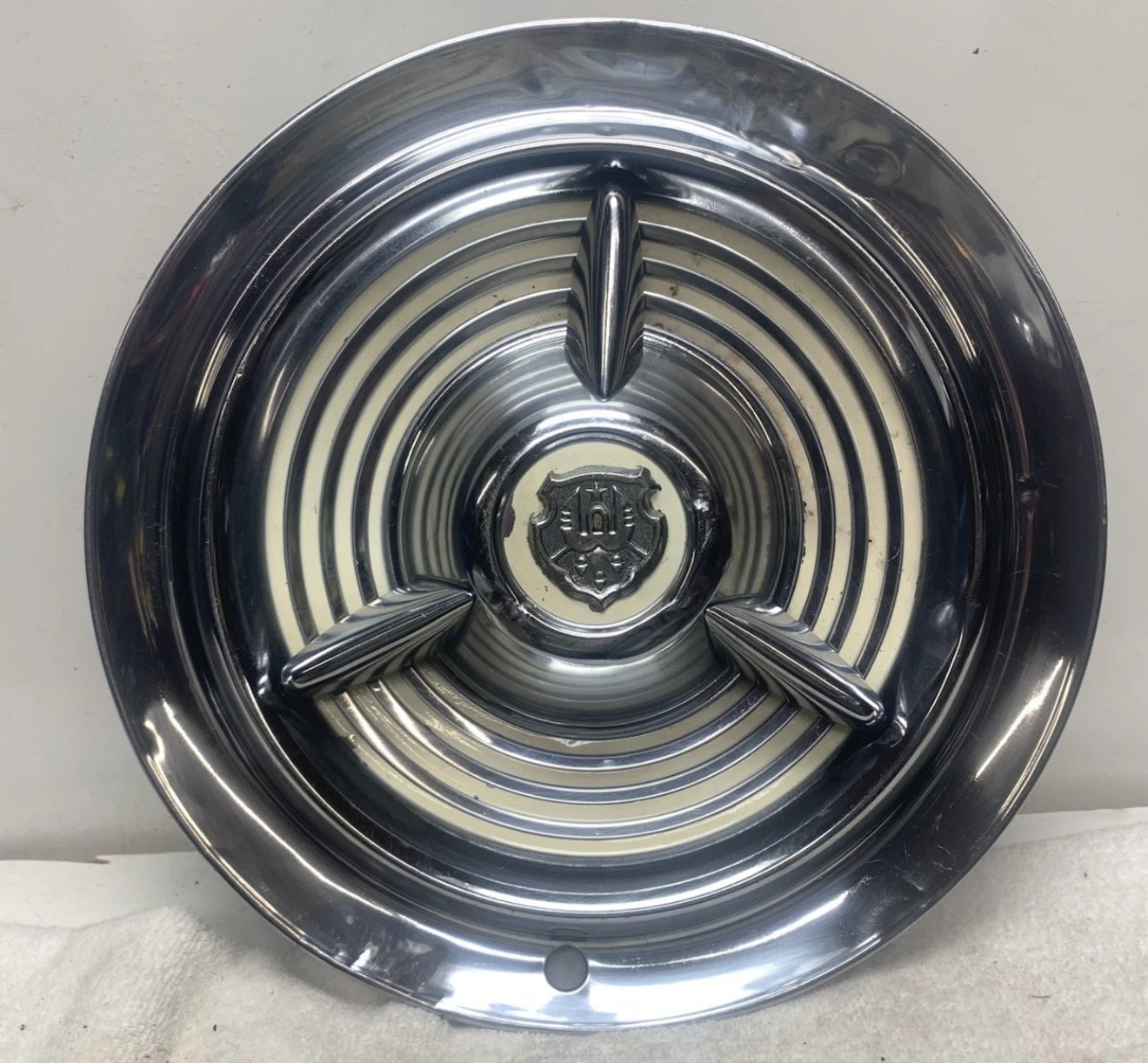

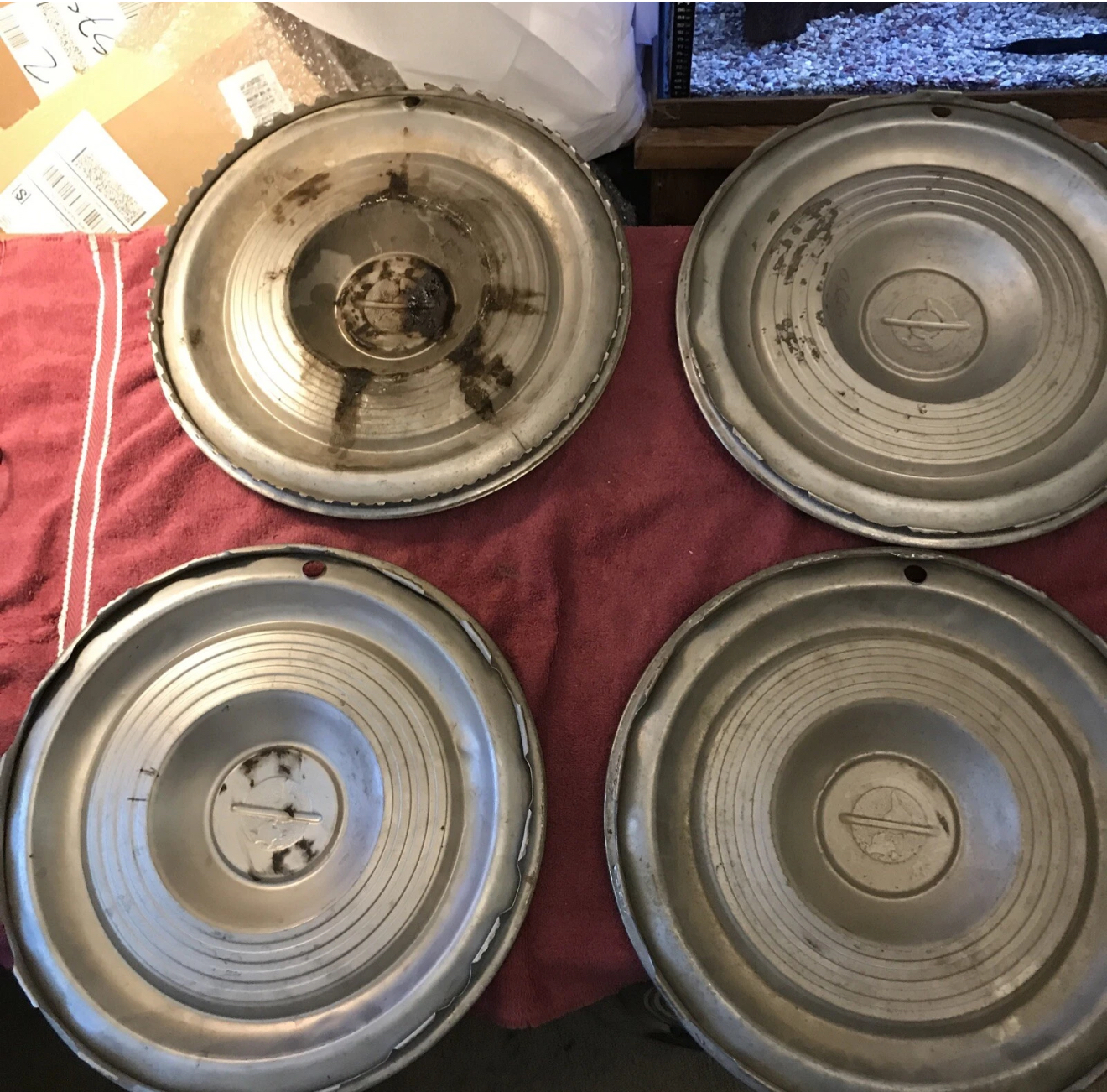

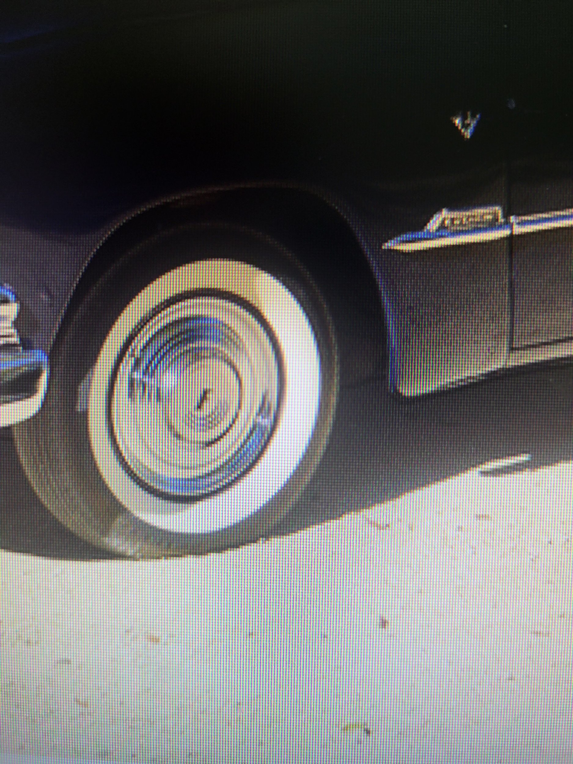

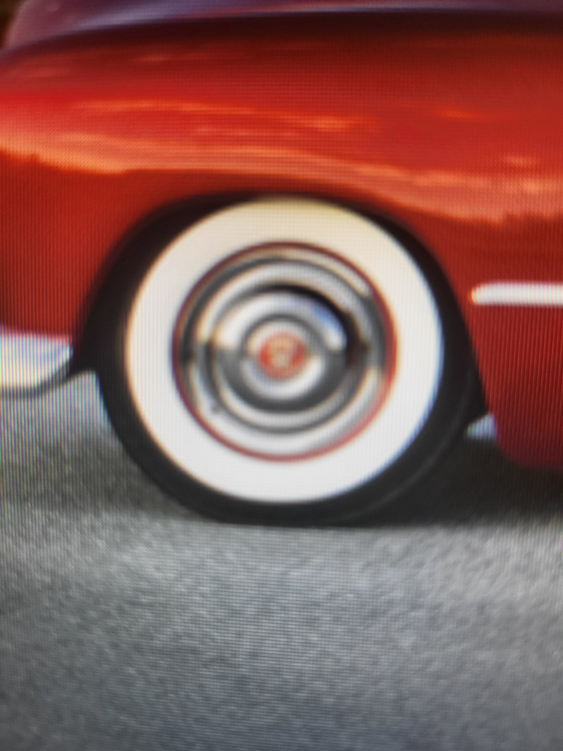

    Some online pics others can help identify. 20250617_161027.jpg 20250617_160912.jpg 20250617_160857.jpg 20250617_160657.jpg 20250617_160513.jpg

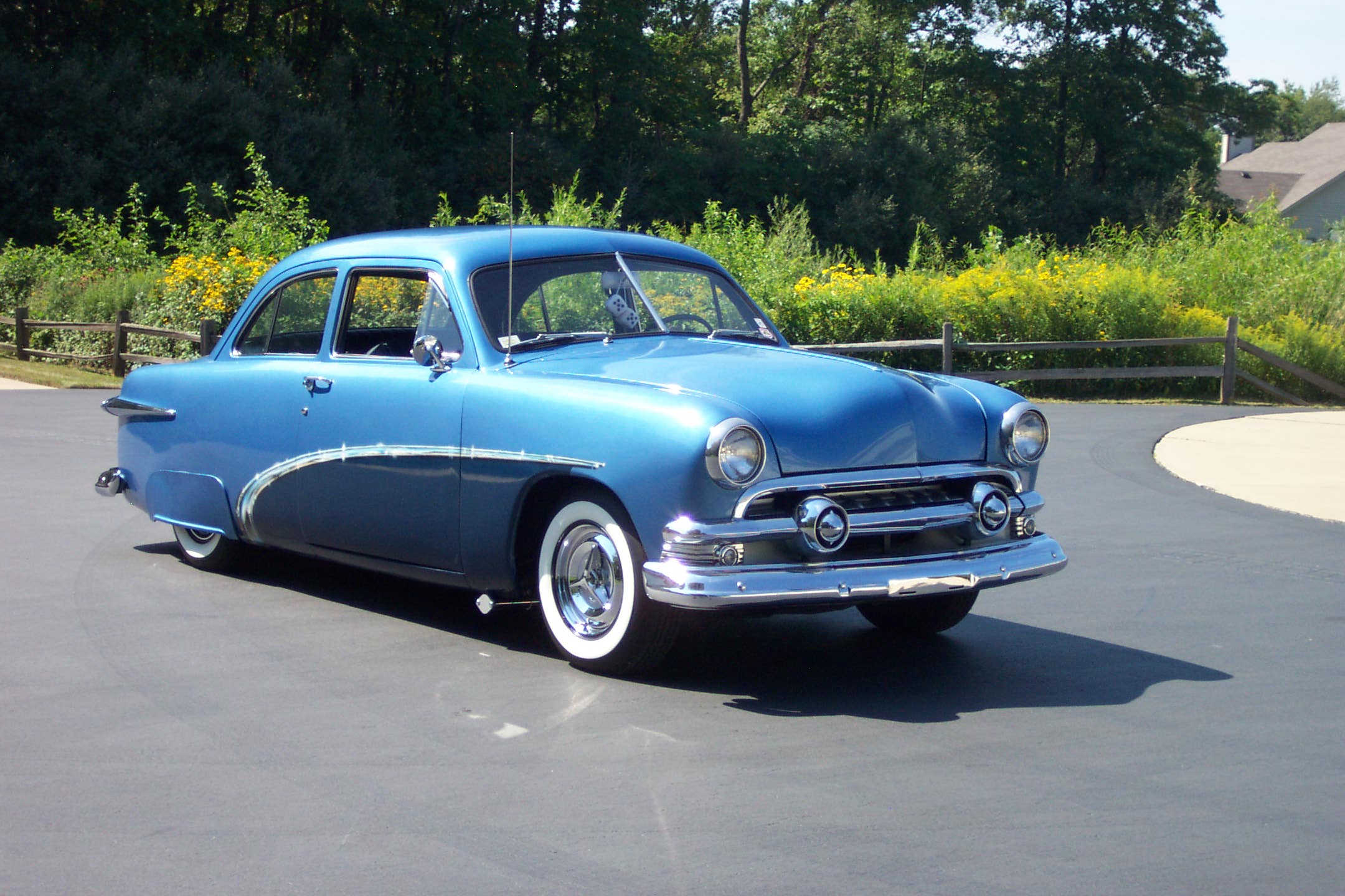

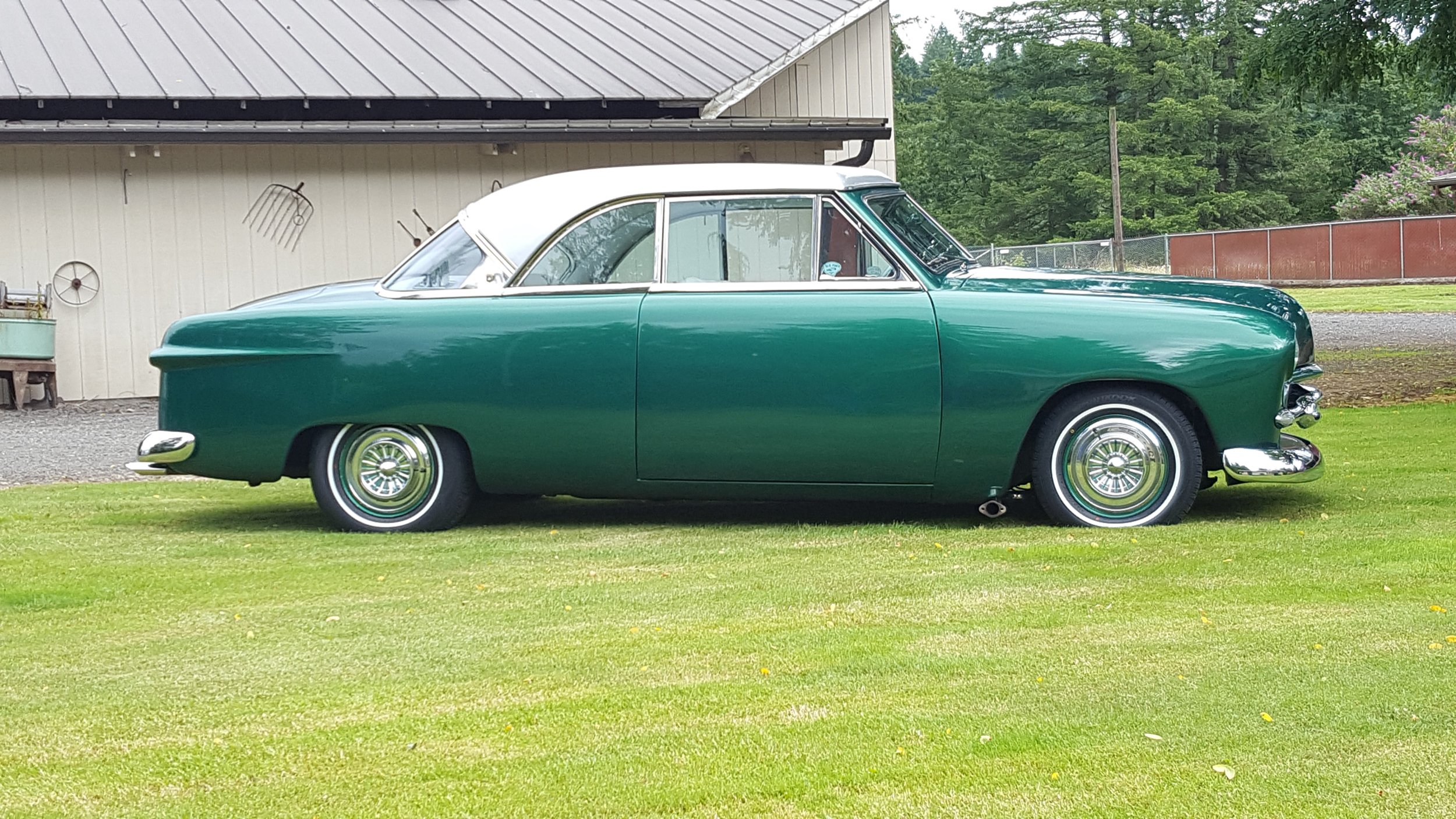

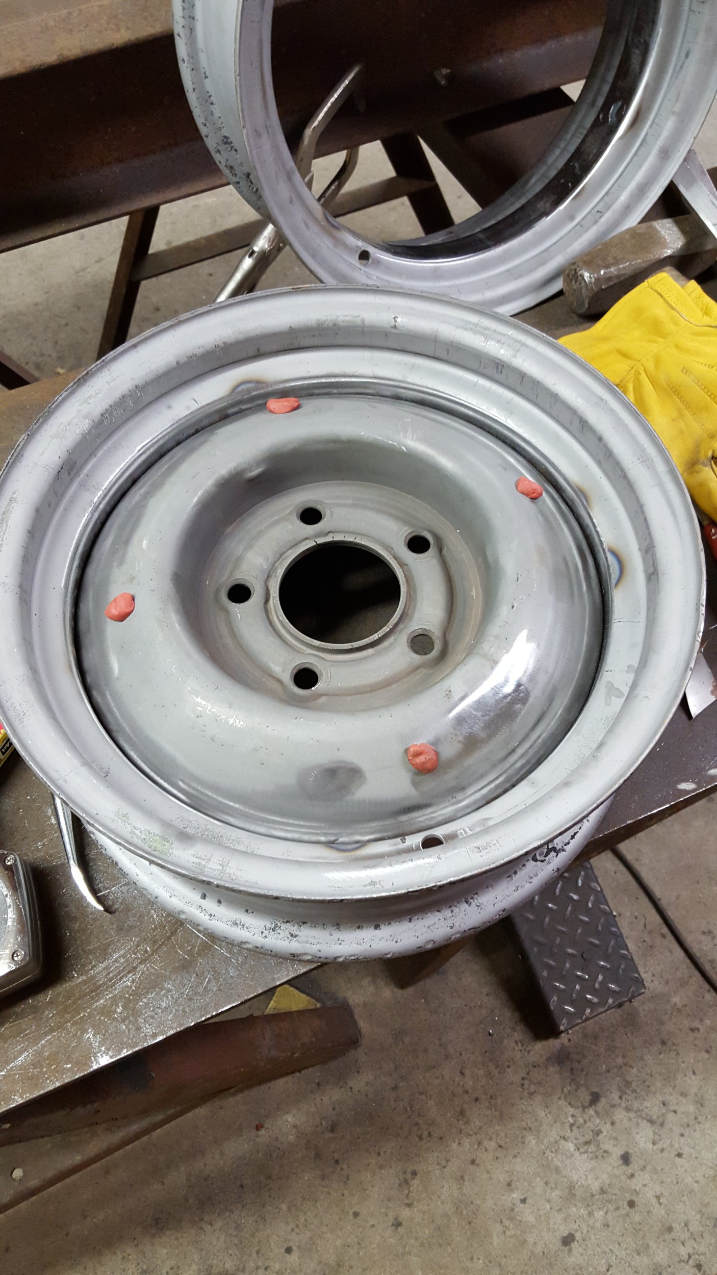

  7. As you are learning all wheels as well as Hubcaps are not created equal. Like all things in the world of changes, do your homework before you open your Wallet. When choosing a hubcap first study the Wheel it was intended for. Then compare it to what you're wanting to put it on. There are so many variations you can't list them all. Some wheel hoops have a deeper drop to catch the hubcap fingers in. Some have deeper centers than others for a reason. Then the obvious is the bolt patterns often won't let you use the intended wheel. Your next move is to build a wheel or make a different choice in covers. I choose to build an appropriate wheel, so I also like the fit.
    For my 51 I chose 57 Chrysler hubcaps simply because I liked the look and they were not a common used one.
    Because of bolt pattern I had no option but to build a wheel plus I needed to not rub my fenders at full turn stop.
    An appropriate wheel center was found and a hoop that worked with the cover. Then the back spacing began.
    Without the center welded but trued you do test fitting for fender spacing. Once that looks good then test fit the hubcap.
    20151229_141657.jpg I have learned that wheel's flex some and the way I drive 1/4" seems to be a good gap space to keep from spitting off a cover. Find the contact point, use some modeling clay to check gap. Once happy weld them up. Make sure to spin balance them without a tire on. Once you have lead weights in place you add a little weld if needed and grind to correct weight and you're done. Yes, it's a day's work but what isn't?
    20 years and over 85K miles and haven't lost one yet and I still like looking at it. I call that a win. Being Kool isn't always a Nutz and Boltz deal.

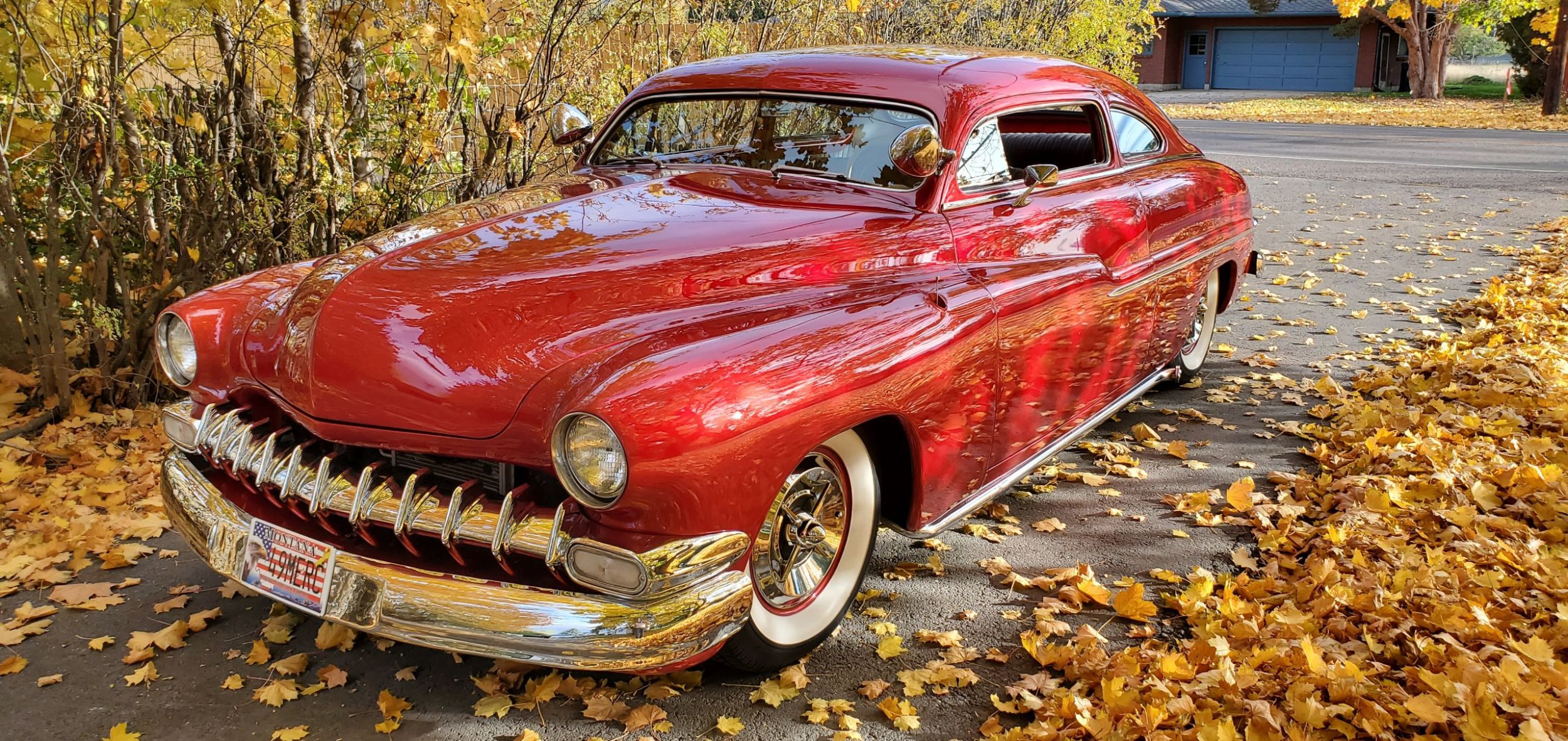

    I've got 15" Ford wheels and the Lancers from Mooneyes on my car. I did have to bend the "tangs" with a dead blow hammer all the way around the cap to get them to fit inside the rim to get them on.
