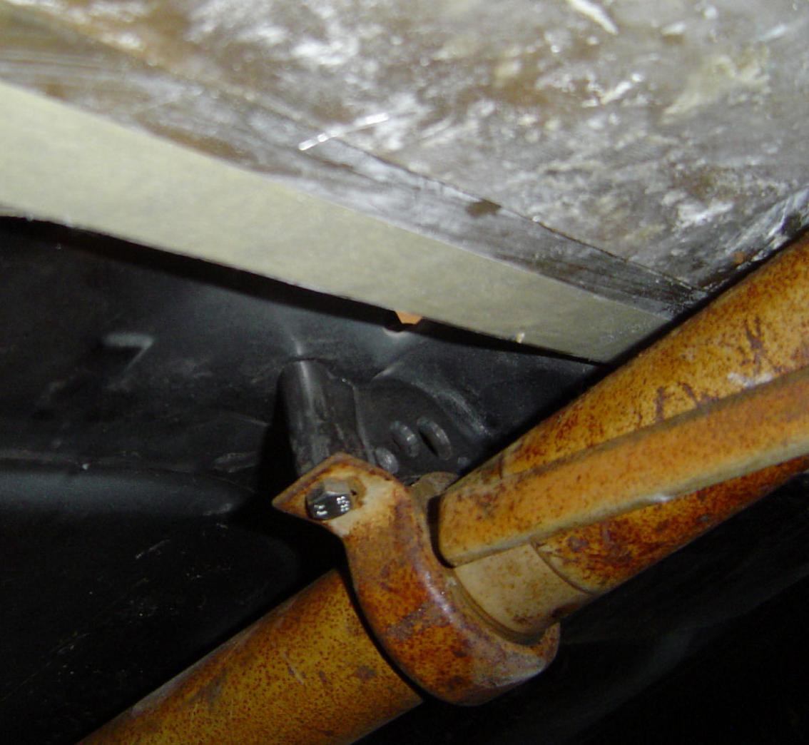

    Some steering column updates. Cory made a snug fitting Drop down bracket with beauty holes drilled everywhere. Beauty holes.
