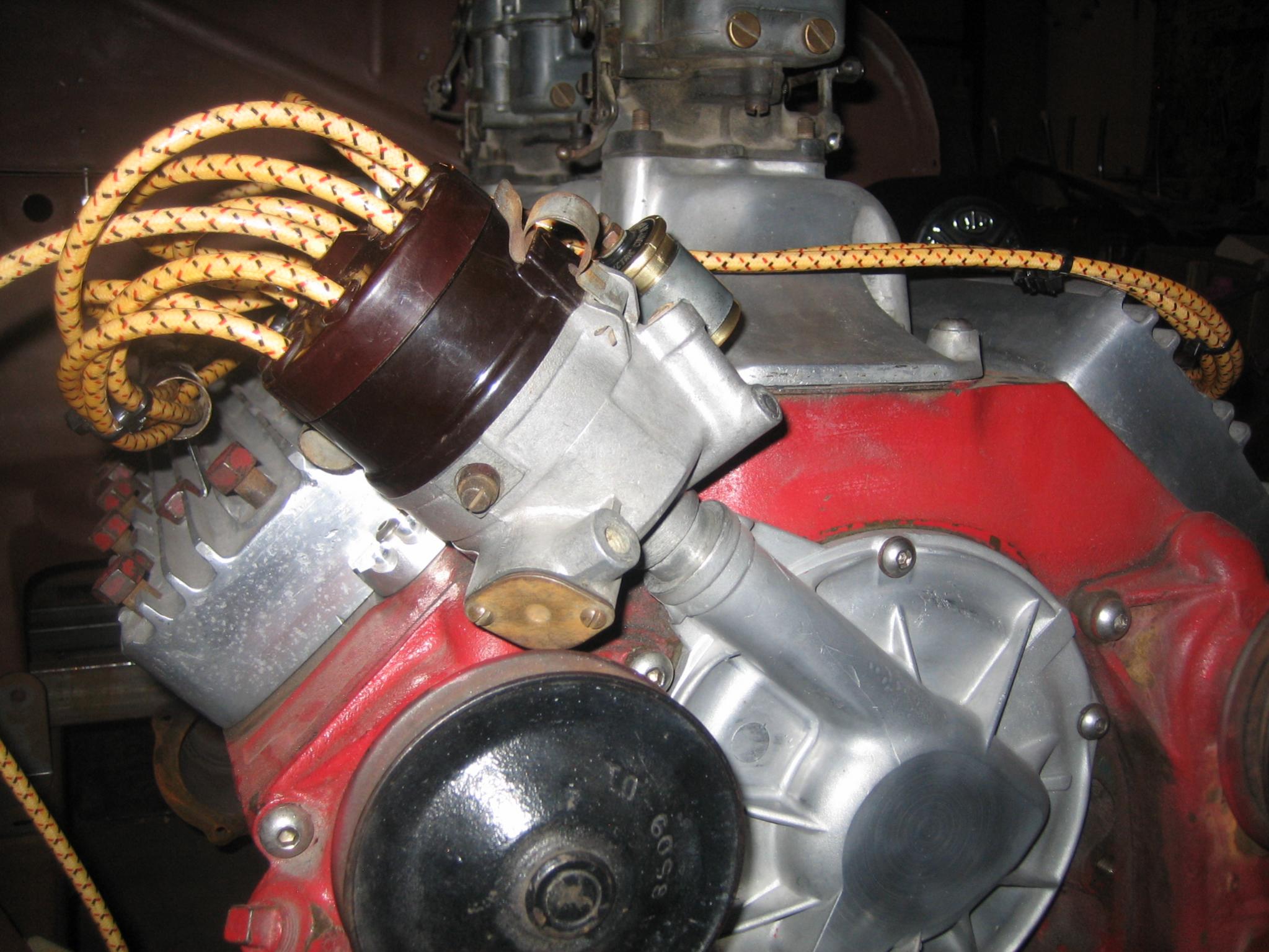

    I wanted to see what else you guys have made for you mills cause you did'nt like what was on the market and you also wanted a custom touch. Here is a picture of the crank pulley I made at work cause I wanted to run a double belt setup on my 53 flatty. now I am in the proses of making matching water pump pulley's for my new drake pumps.

    I figured on making the flatheads aluminum water pump pulley's the same dia. size as stock so there wont be an issue with turbulence from the impeller spinning to fast and churning the coolant.

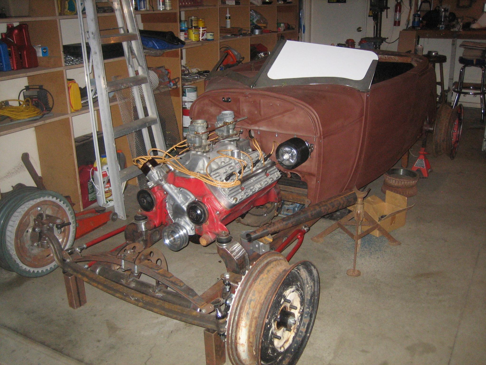

    Thanks! The Hallock is in the process, Made the hallock type frame out of 3/16 cold rolled sheet metal. Hope to grind and sand it for a clean chrome job. I raked it at 35 deg. to me the Hallock is awsome but I wanted even more streamline.

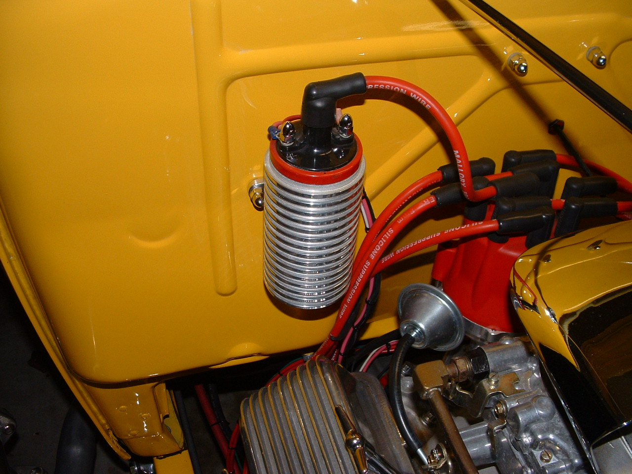

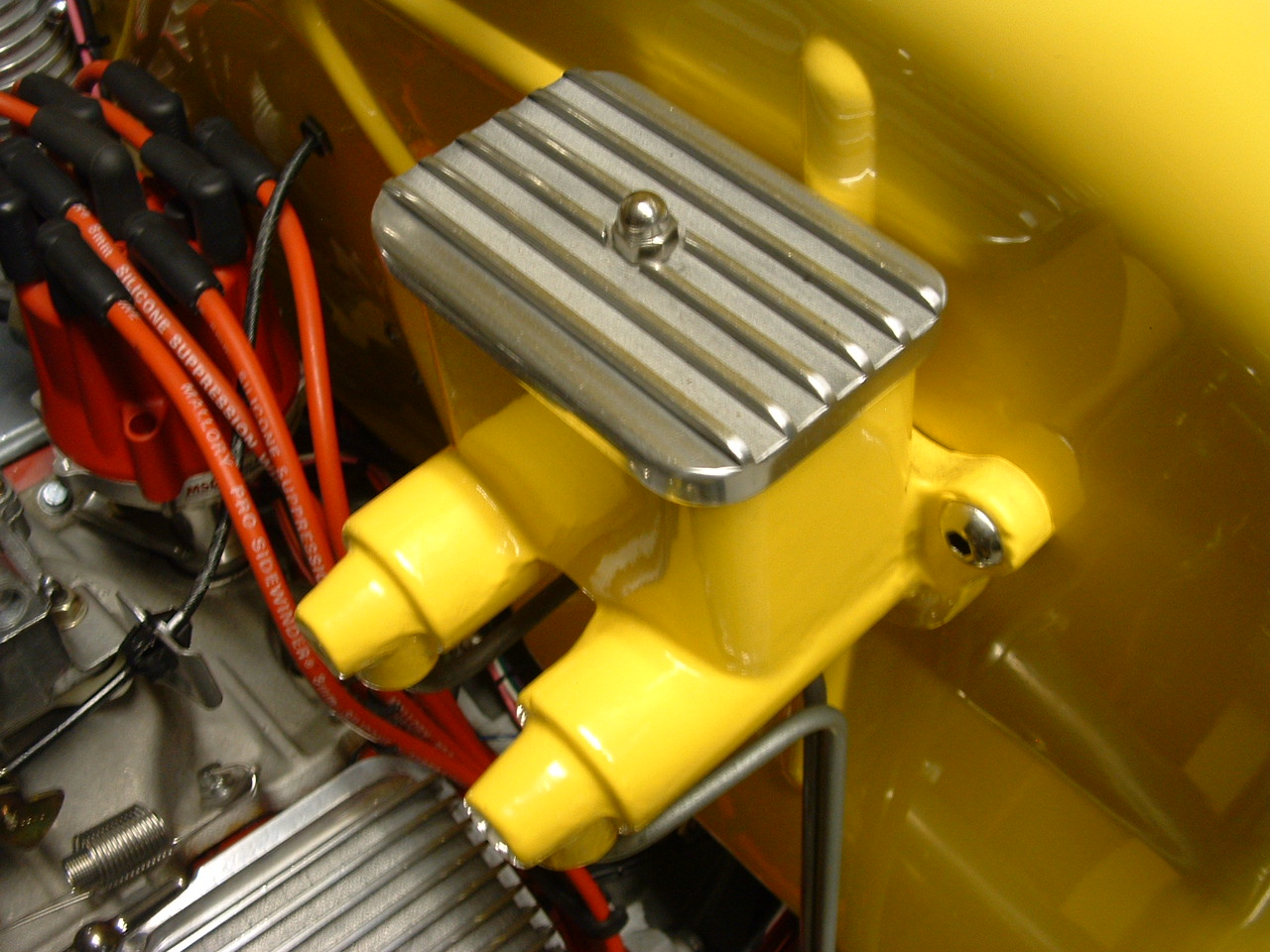

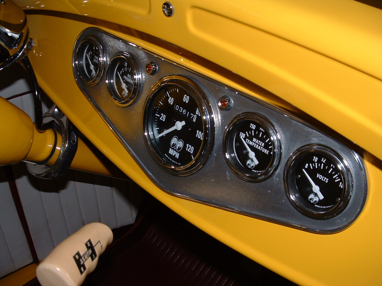

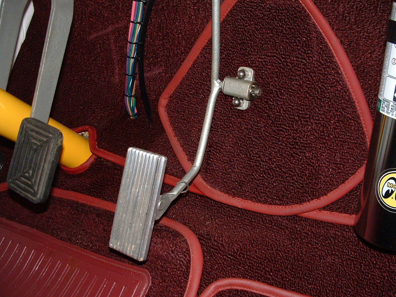

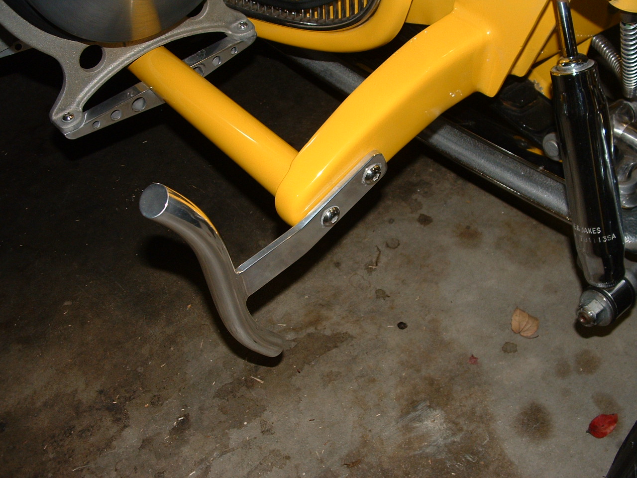

    Finned master cylinder cap, coil cover, nerf bars from aluminum tubing and flat stock, Moon tank mounting brackets, gauge panel, finned gas pedal.

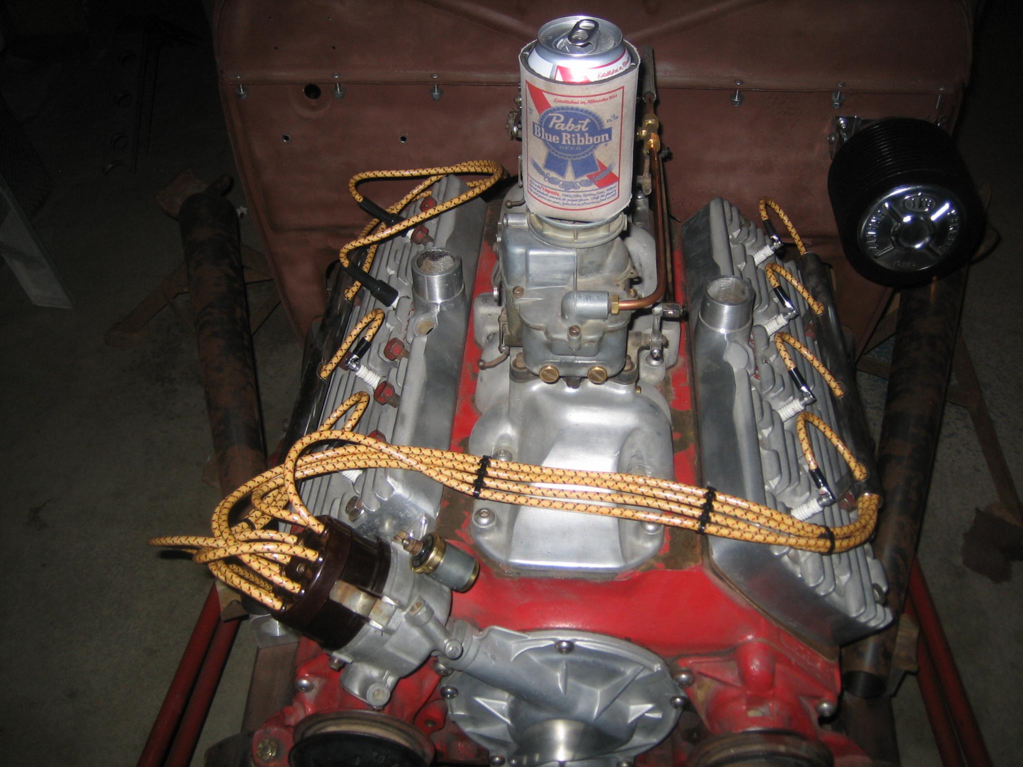

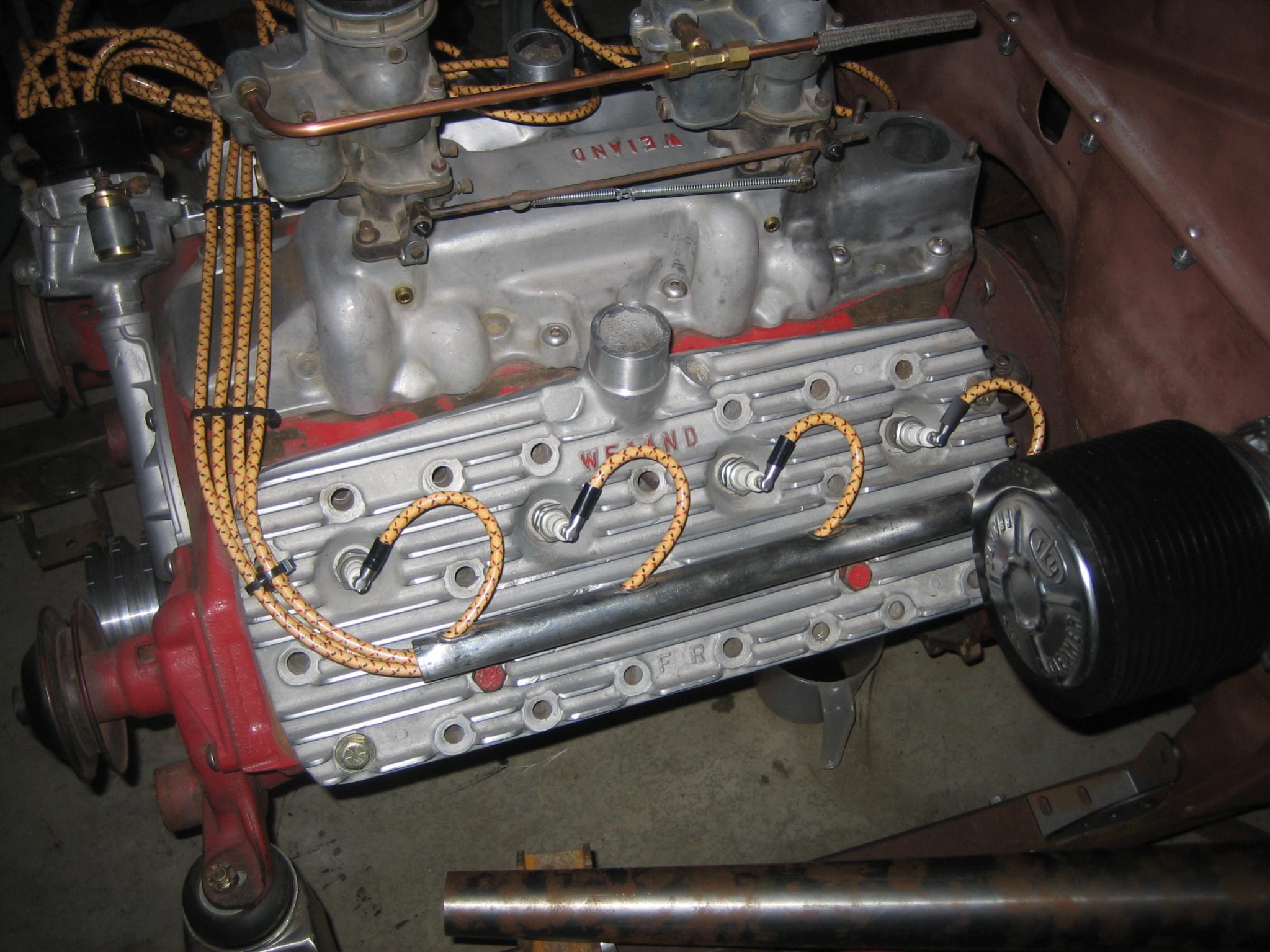

    Just finished the driver bank touching up the braided plug wires. Tomorrow the passenger bank. Man I love how they look flowing into a Mallory 2 piece cap!

    I was thinking on making a fuel rail out of billet. It would look good blasted to give the cast look. The more heat sink fins to match the heads the better I think. Whats your opinion?

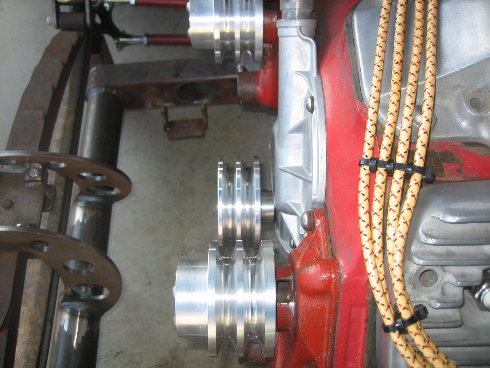

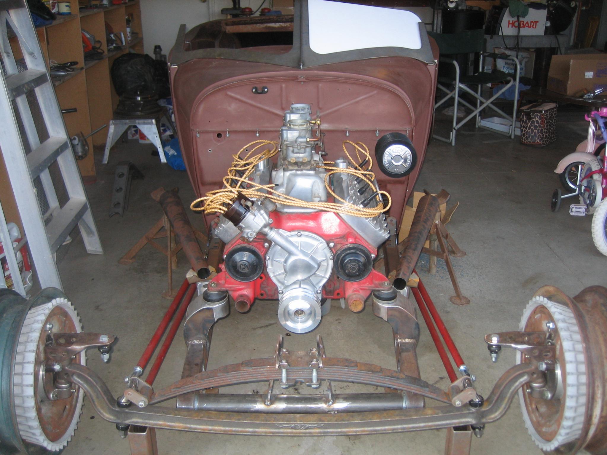

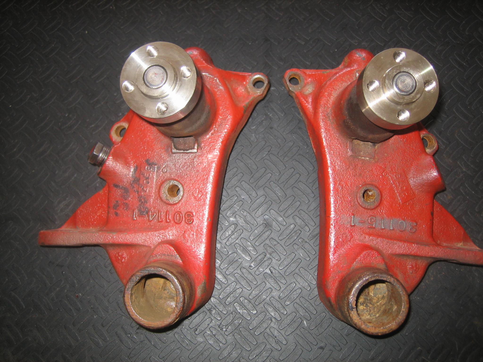

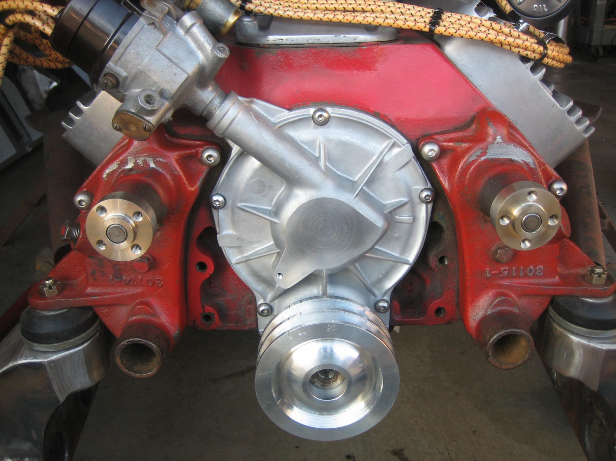

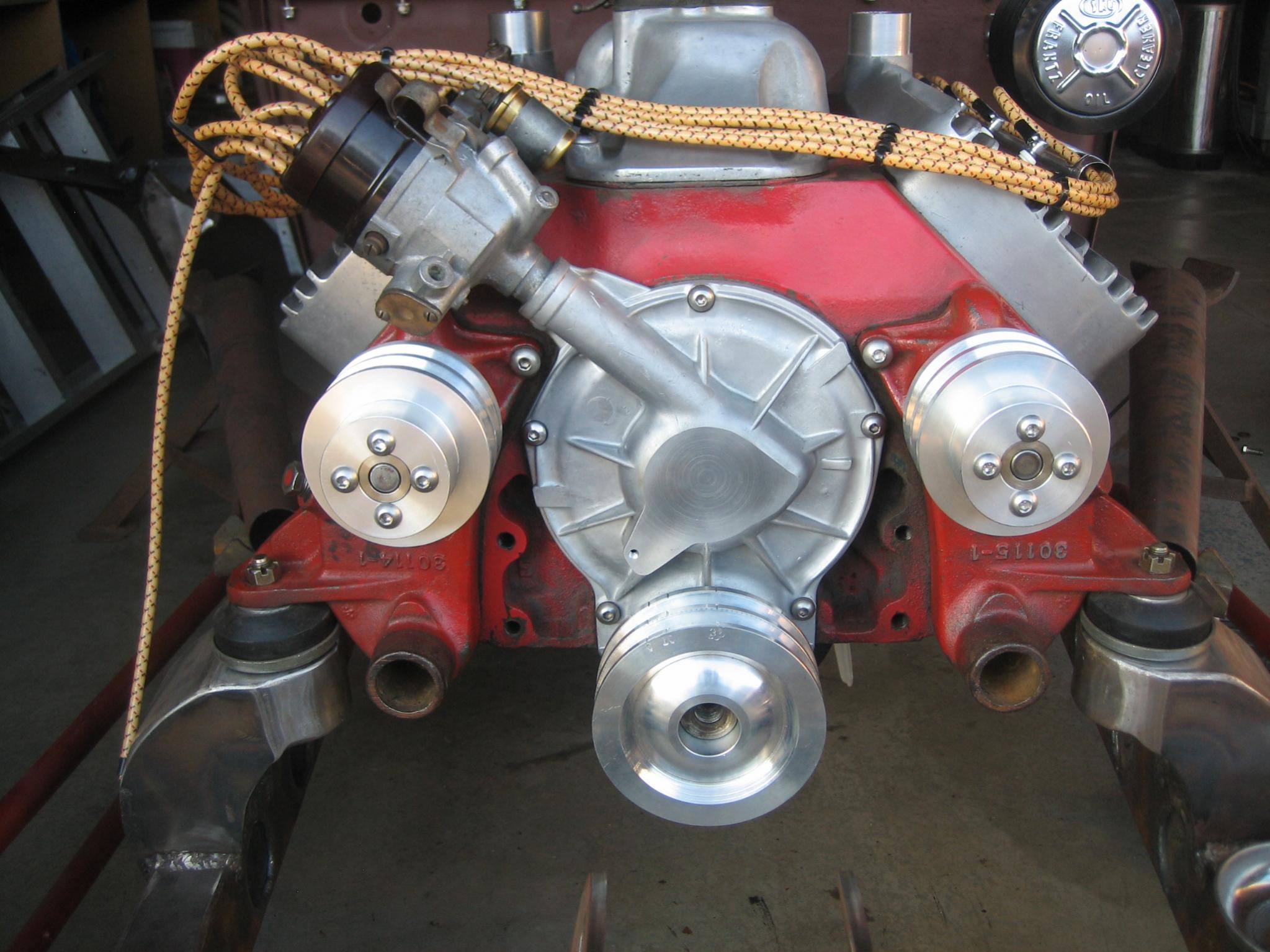

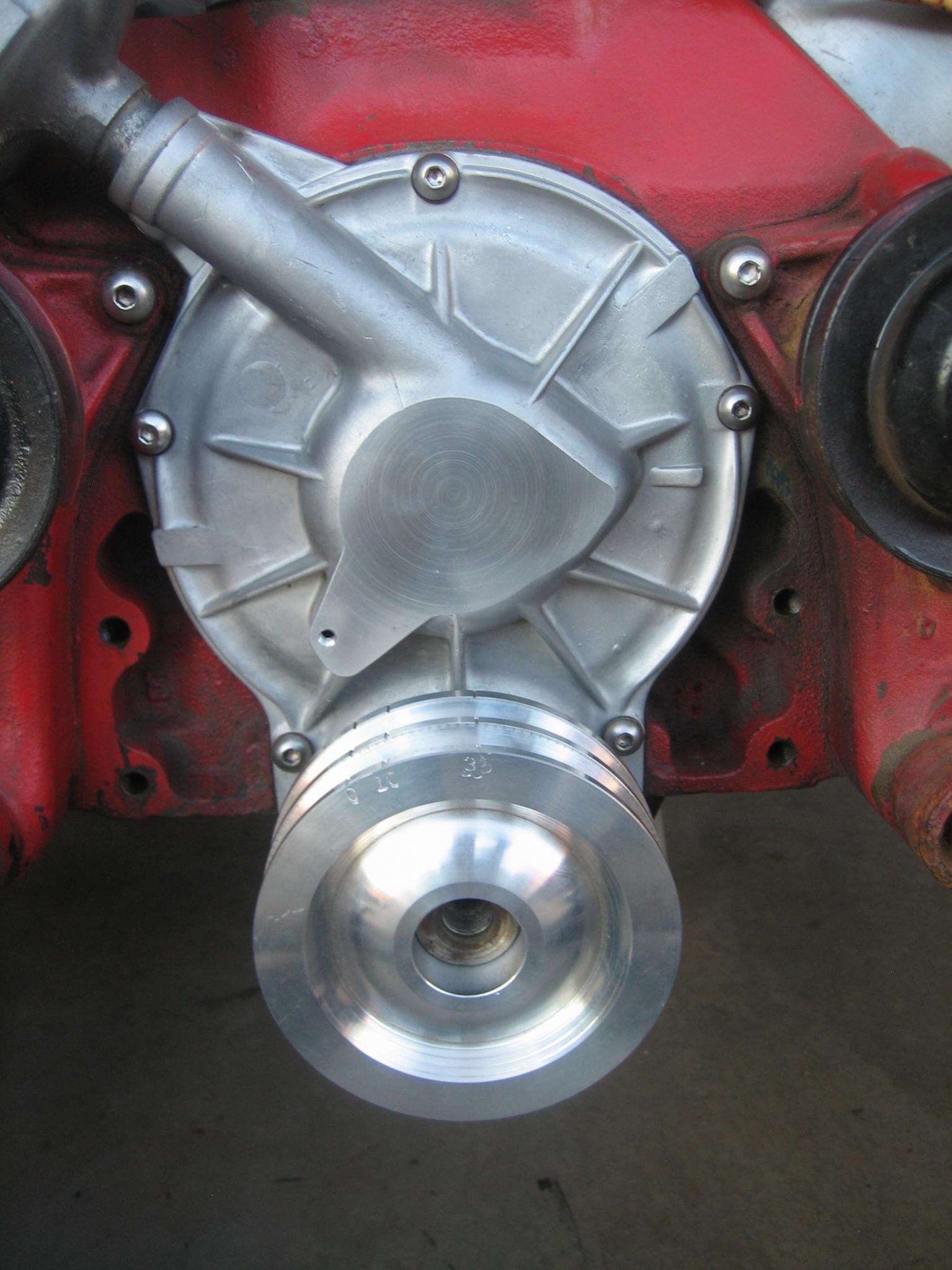

    Just finished the water pump pulley's for the flathead! I made a pair of 304 stainles steel hubs to mount on the water pump shafts so I could bolt and remove the aluminum pulley's for maintnence on the mill. Double 5/8 V belt grooves to match the crankshaft pulley. I was thinking on making the tension pulley to run tucked down near the bottom corner of the block running a shaft driving the alternater behind the mill. I like the look without the generator or alternator jumbled in the way like an eyesore.

    Nice job on the pulleys. Anytime you can make a piece that is functional and cool looking..... winner.

  29. Nice work. Stainless is a bitch to machine. Hard and gummy. What kind of taps do you use?
