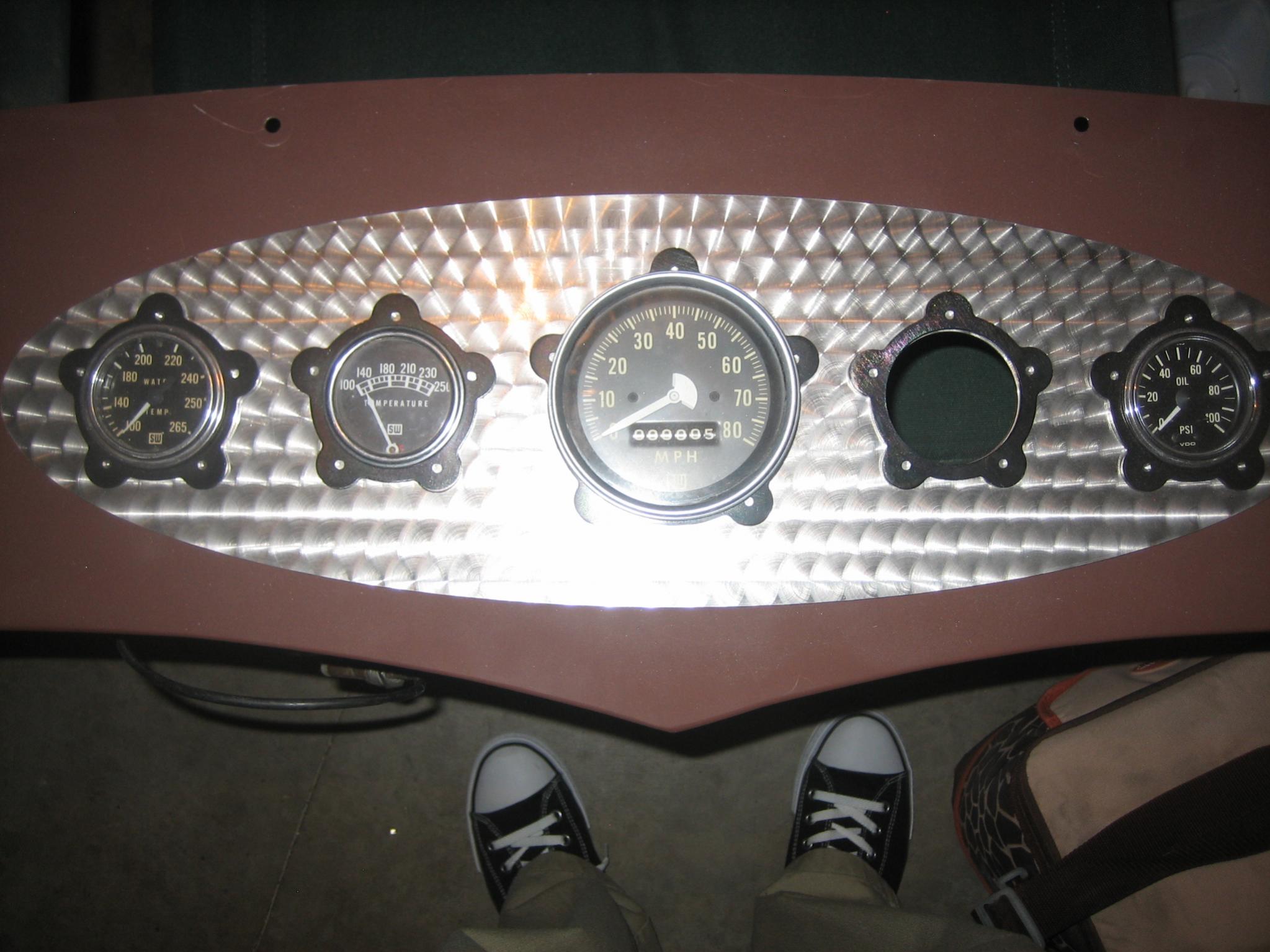

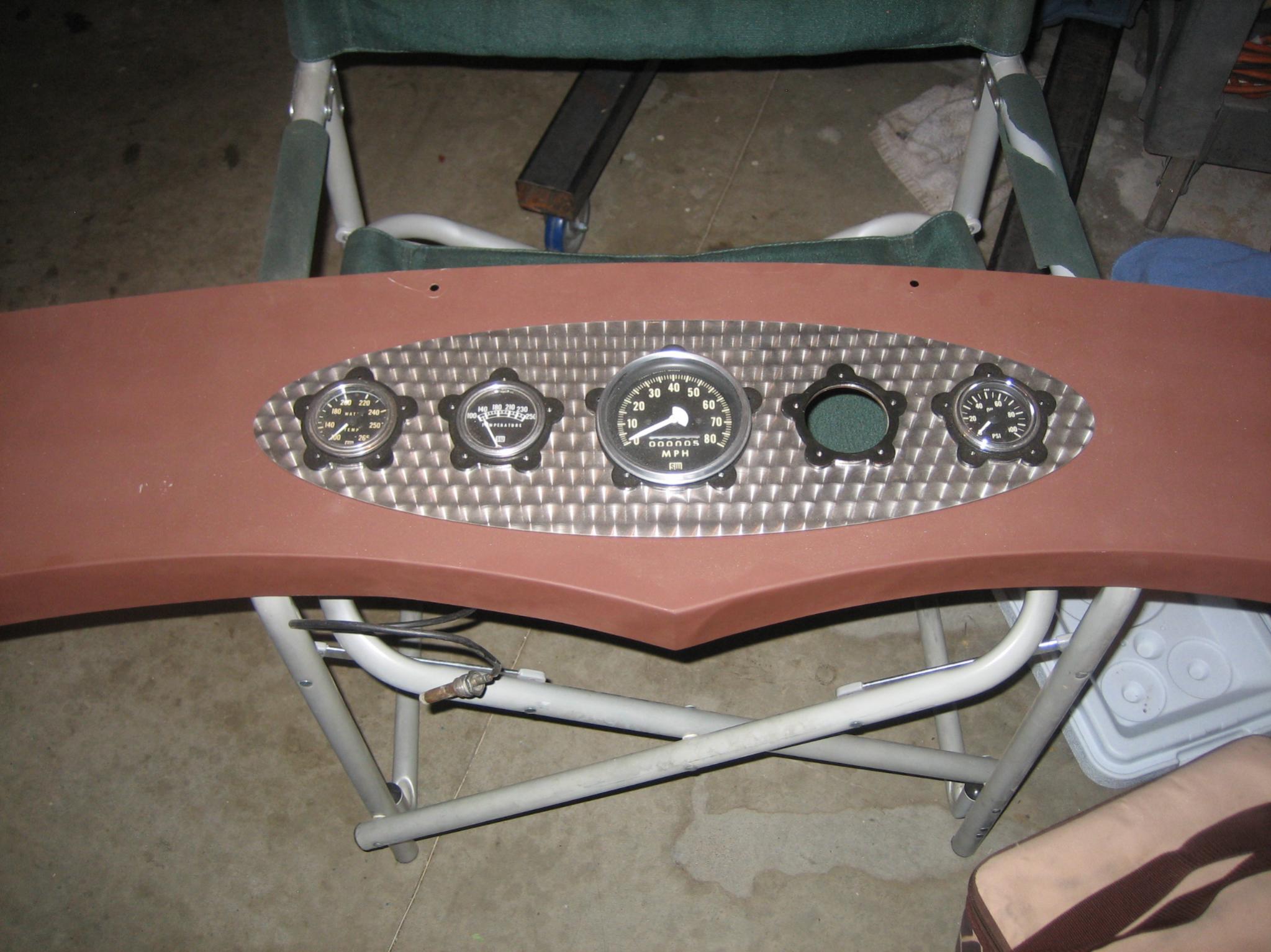

    Been working on my homemade dash today. Made a oval stainless insert that I engine turned for a vintage look With laser cut bomber bezel's I made from work last week.

    I know its not part of the motor, but its the next part of monitoring the vitals.

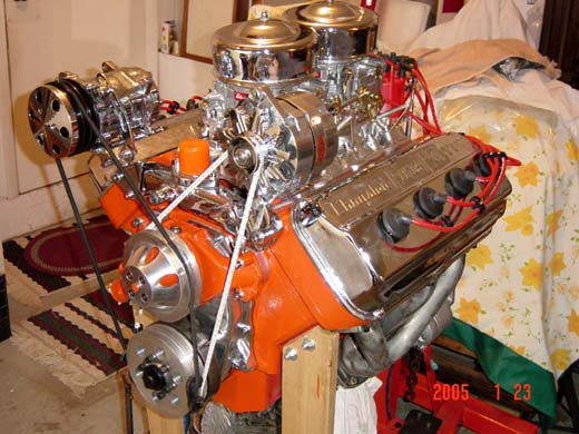

    Here's a home made fuel log for the hemi.

    I like it! And I like the intake manifold.

    Thanks. I'll be selling the intake with two fours with S&H aircleaners , A/C bracket, alternator bracket and power steering bracket in about 6 months, I hope.

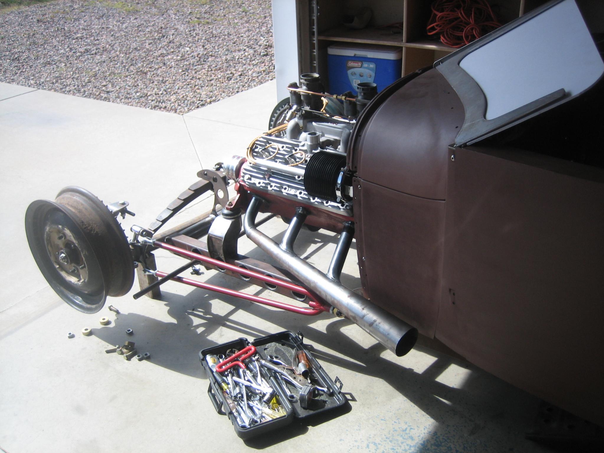

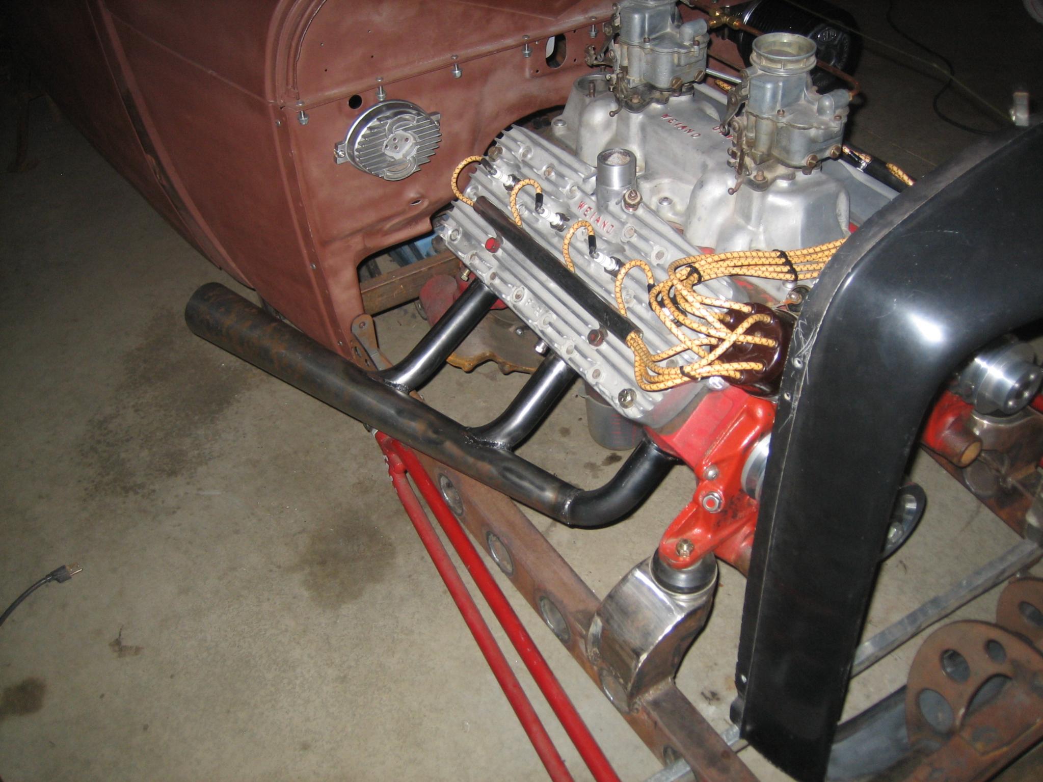

    Finished the headers tonight! Made a set of lakestyle headers with 1-5/8 16 gauge tubing on a set of 1-5/8 to 3-1/2 30" long 16 gauge megaphones with 1/4 custome cut flanges.

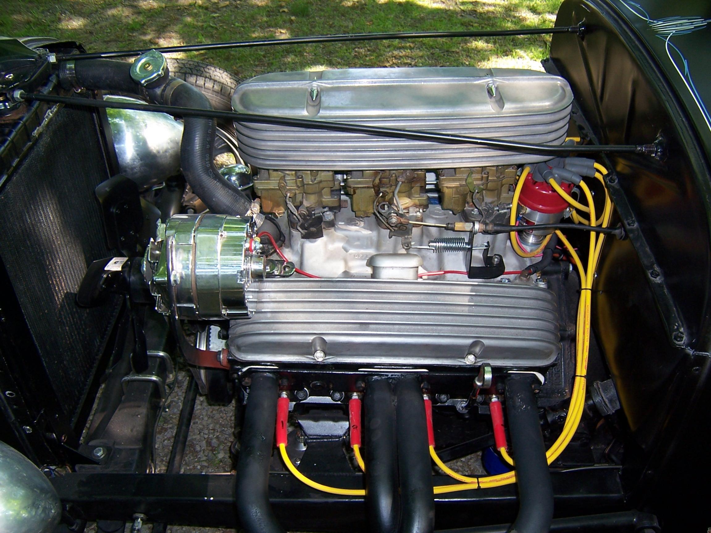

    Hers a air cleaner I make for my three duce nice match with my cal custom valve covers LOL

    Very inventive! I think it looks cool. Better than a lot I have seen on the market.
