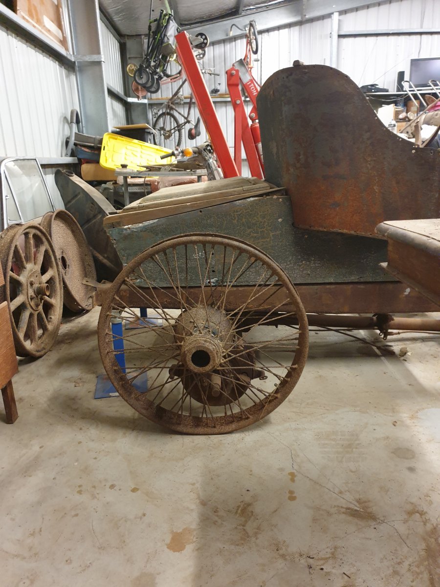

    Here's an unusual topic, what does everyone know about car modification before the birth of 'hotrods'? I have a 1905 car body that appears to have been extensively modified in the 1910s to keep up with fashions and make it faster. It was converted from a 4 seater to 2, seating position lowered, and engine swapped from single cylinder to a twin.
    I only have the remains of the body now and as hard as I search, I haven't been able to find any images of modified cars in this era, despite the fact that I understand it was fairly common practice. Does anyone have any knowledge or photos of modified vehicles in this era?

    It's an Australian Innes, which partook in one of the Dunlop Reliability Trial of 1905. Largely a rebadged Lacoste et Battmann. No real history after that until it was found modified in a field in 1958

    This is a neat project. I think it was fairly common practice to put new "coachwork" on old chassis back then, since automobiles were so expensive and fairly rare yet. The problem is, photography was also still fairly rare, so not a lot of records were kept of it, and even fewer ever made it onto the internet. Not like now, where photographs are practically unlimited and sharing them can be done almost infinitely.
    Looks like that body fits the TT frame very well, and there's plenty enough of the body left to fill in the gaps and rebuild it, that is certainly a cool find.
