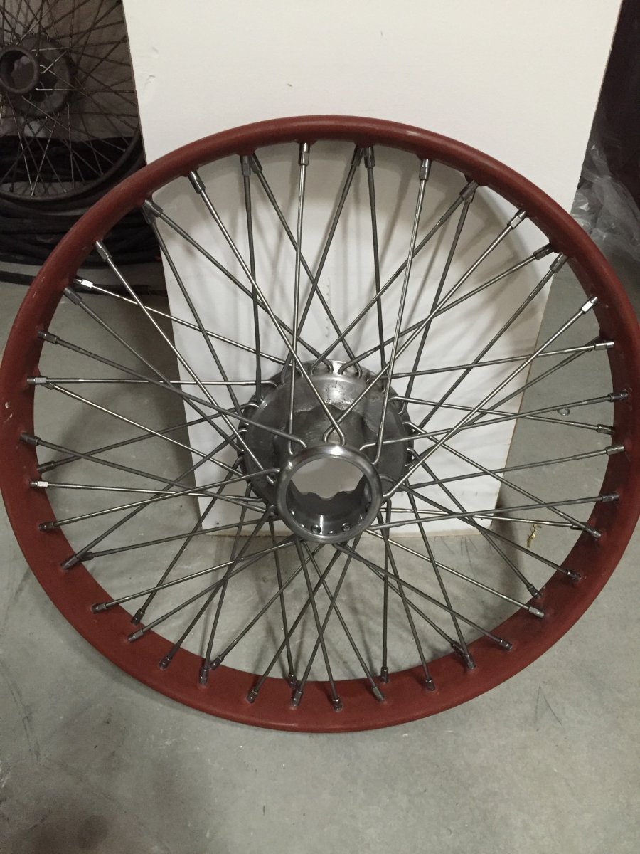

    Here is a more straight on shot of a Buffalo to compare with the Bugatti above. You can clearly see how much more the spokes cross, providing the torsional strength.
    Motorcycles use these same principles even to this day. Front wheels are typically straighter spoked like the Bugatti, while rear wheels have much more angle (or crossing) to support the drive torque.
