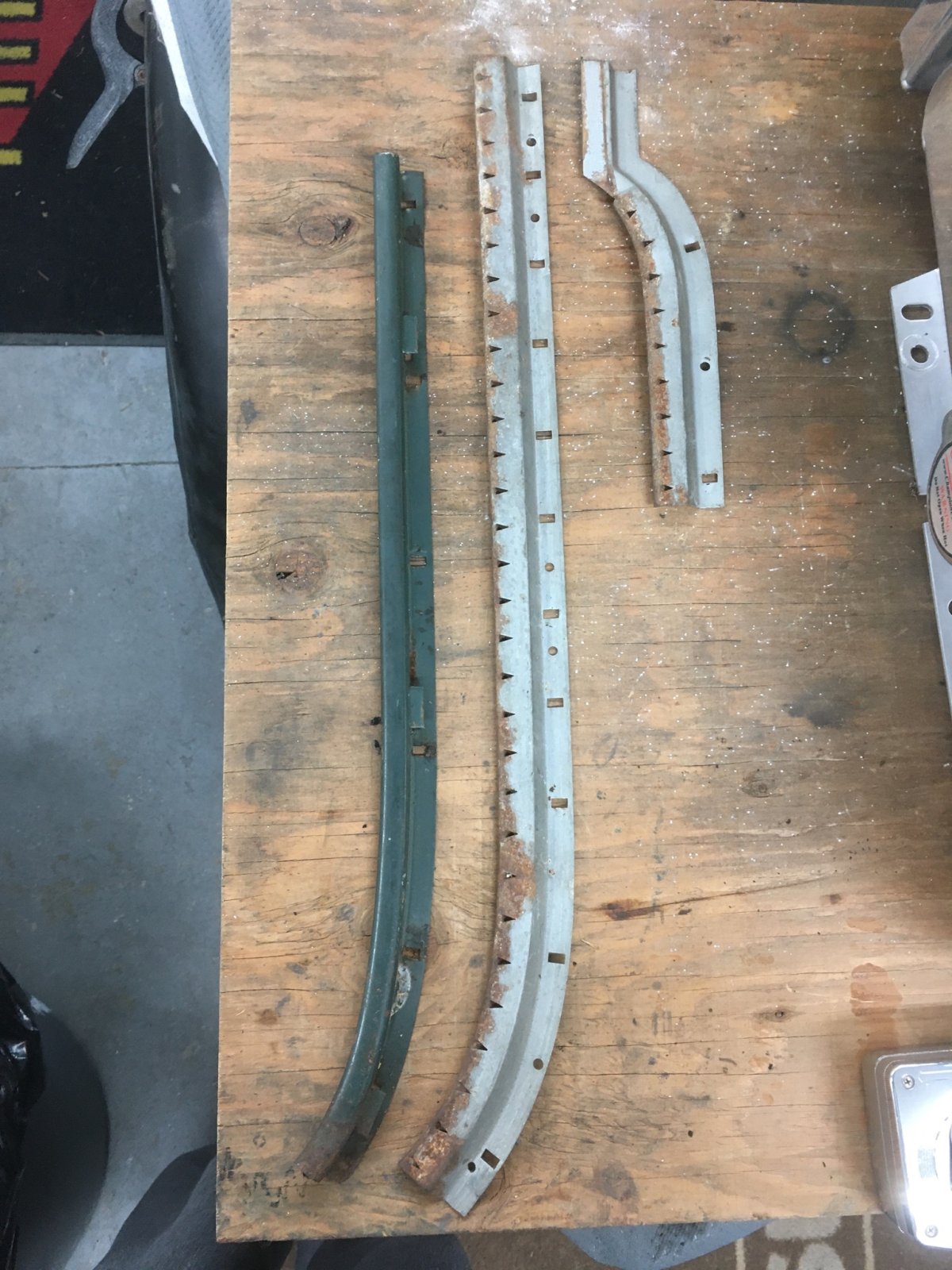

    Hey all! In a pickle here. A while ago I drug home a 1954 Ford Customline and a lot of boxes of parts. (so many boxes).
    Now it’s time to deal with the last of the headliner. Q: does anyone know where the green part on the left goes?
    Thanks?

    1. 1952-59 Ford Social Group
    What body style Customline? Tudor, Coupe, Fordor, Wagon?

    SillyBabbit
    Ah, yes. Two door sedan.

    Squablow
    I believe it goes down by the kick panel, should be one on either side. One edge of the kick panel tucks into the open edge and the windlace stuffs in behind it.

  6. What Squablow said. Here is a picture of where it goes. The one in your picture is for the driver's side.
