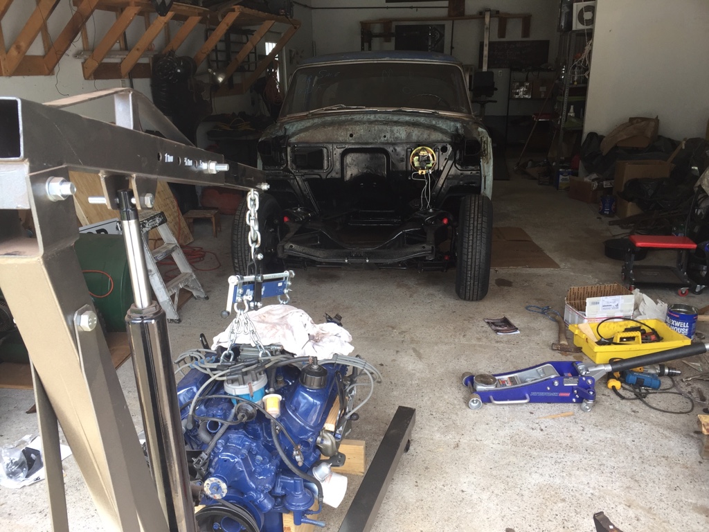

    Just used above kit in my 53... had to use fram PH16 oil filter and grind the edge off drivers side motor mount... this motor is a 302 out of a 78 f100 with a front slum oil pan and a 4 speed o/d ****** behind it... had to cut the floor and round out the crossmember with an 8lb sledge to get clearance... but it works..[​IMG][​IMG]
