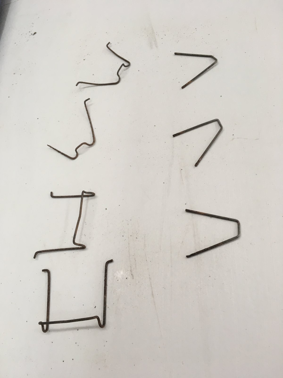

    98DAD069-F2F7-491B-9EE5-BF4297A002AA.jpeg Hey all,
    Anybody have a desc. pics of the headlight trim and stainless trim go together? I have these clips (pic) and can’t figure how they work. Do they clip into the three slots somehow?
    Thanks again all!
  2. On my 53 it uses 3 of ones you have two of pictured on the top left. The open-end hooks onto the lip of the trim ring and the closed end then snaps into where you have circles drawn. Yours are a later year.

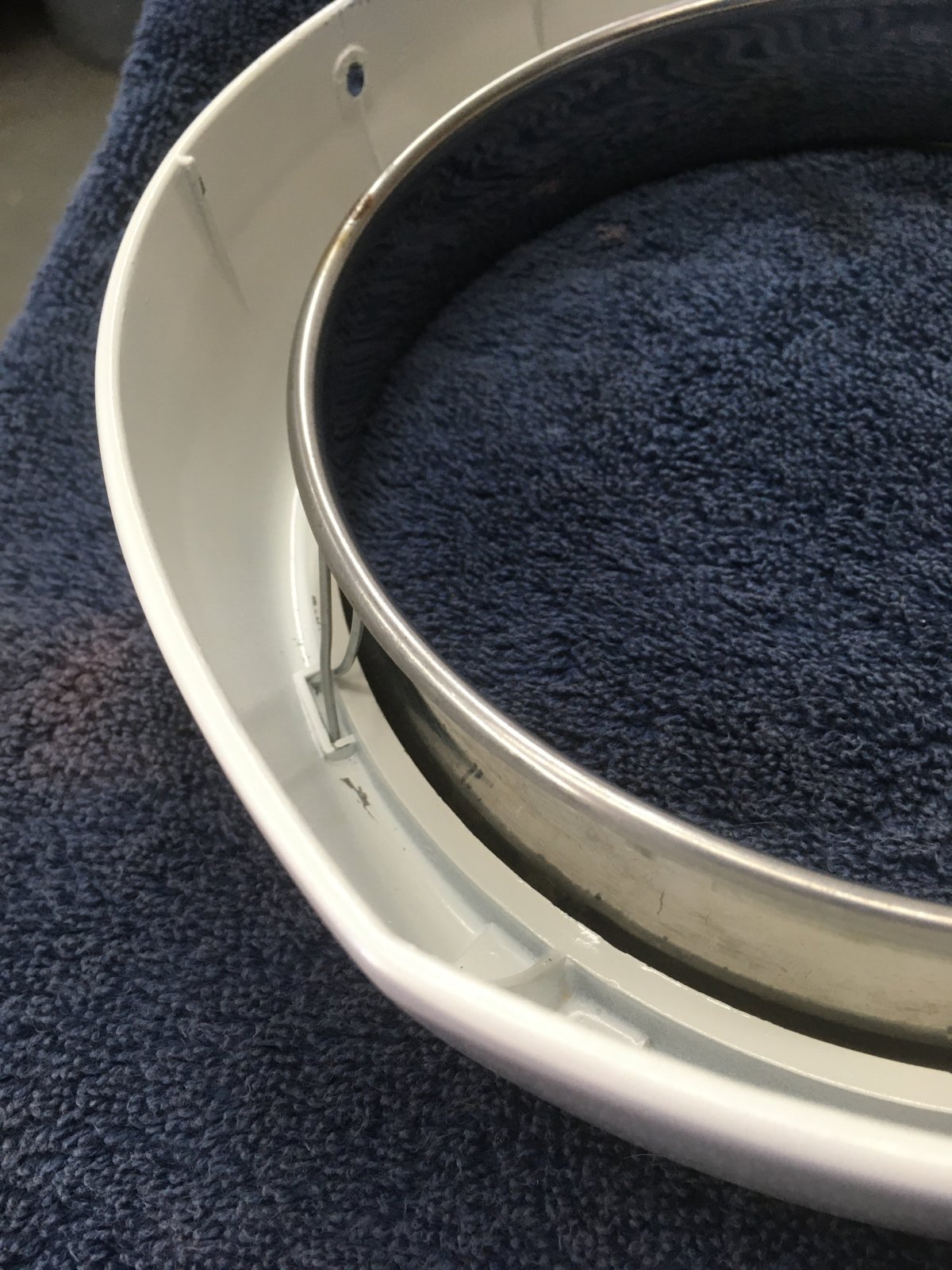

    Thanks banging,
    I went ahead and had a beverage or four while I was thinking about it since I only had one and a half of the six clips I needed.
    A guy on fleabay wants $30 for a set of nos clips…. no thanks.
    So I took some wire I had and designed new clips. A pita but they’re in.
    Thanks again. C81D68E1-5A49-4147-910F-E346D7FCCE8E.jpeg 25571CCC-E2EE-4639-B19E-535CE2B9D9B3.jpeg
    TrailerTrashToo and 2Blue2 like this.
  4. That is the way my spring steel ones install. The spring steel keeps them snug, but that way will work also.
