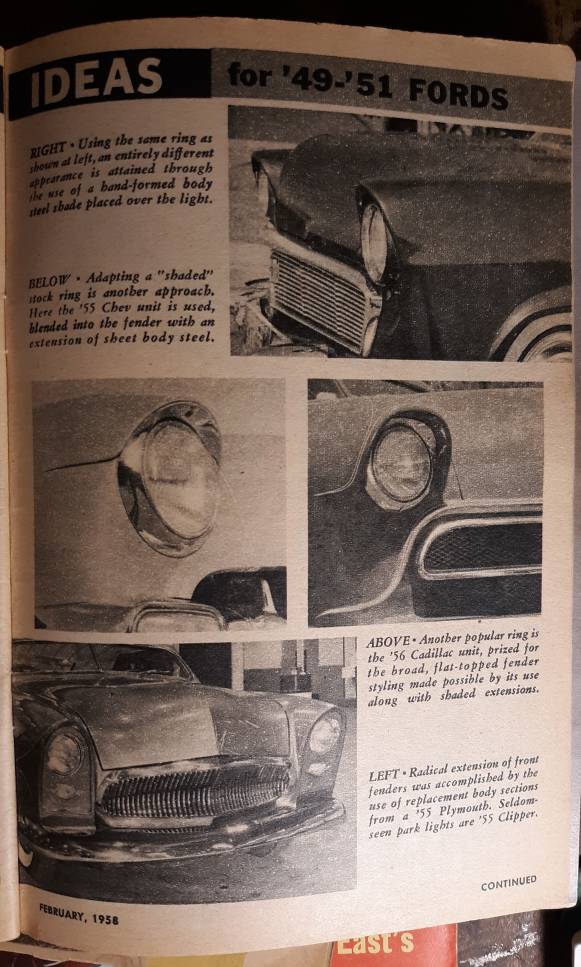

    Hellfish is correct, and I can help you out with that.
    I have several ,alot, of the old magazines .
    This particular one has pictures of several custom tricks of the day.
    Here's the headlight section.
    If you want to see any of the other stuff let me know..also when I run across anything that may interest you I will post them.
    If you ever consider doing frenched tunneled headlights ...I made some for my 50 Chevrolet that are frenched,tunneled and adjustable & removable from the front...no taking them out from behind.
    And they don't look like them aftermarket ones with the big ugly spacer ring around the light.
    Mine are basically frenched, tunneled, 54 merc inner ring with a 57 ford outer shell/ring and..if interested I can tell you more + pictures.
    Or you can search on this site and probably find them. 20210315_104622~2.jpeg 20210315_104545~2.jpeg 20210315_104606~2.jpeg

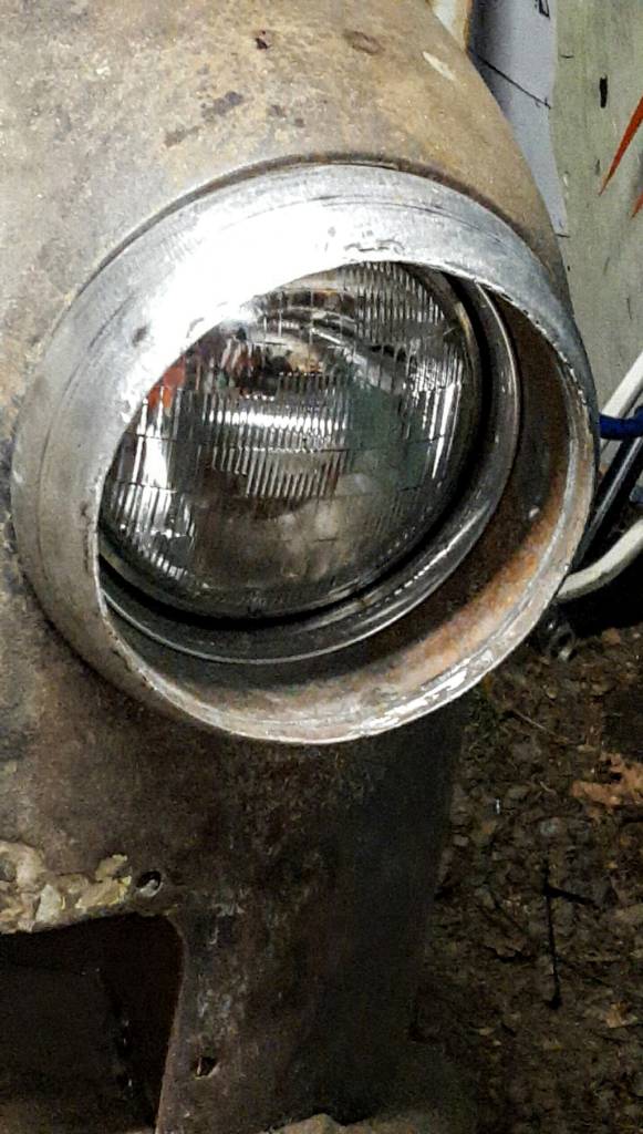

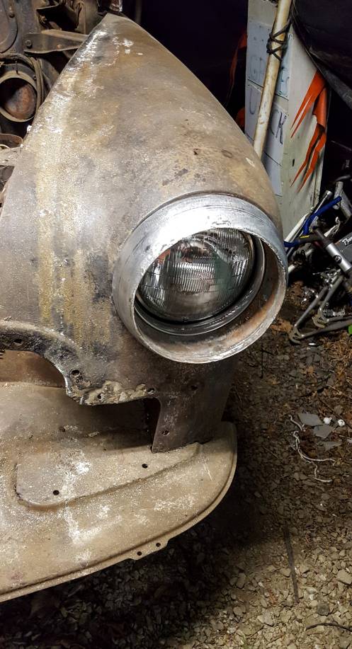

    Here's my Frenched, tunneled 54 merc, 57 ford, 57 Hilman....yes Hilman..that's the key to making them front loadable & adjustable
    I will post some shots of the break down of parts and how it all goes together next.. 20160410_025430~2.jpeg 20160410_025537~2.jpeg

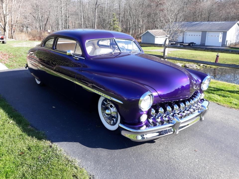

    My friend found a mint pair of 56’ Olds fenders Resized_20201114_102352.jpg for his 50’ Merc, I would have maybe second thoughts on chopping them up, but the results are Stunning!

    Sweet!!!!
