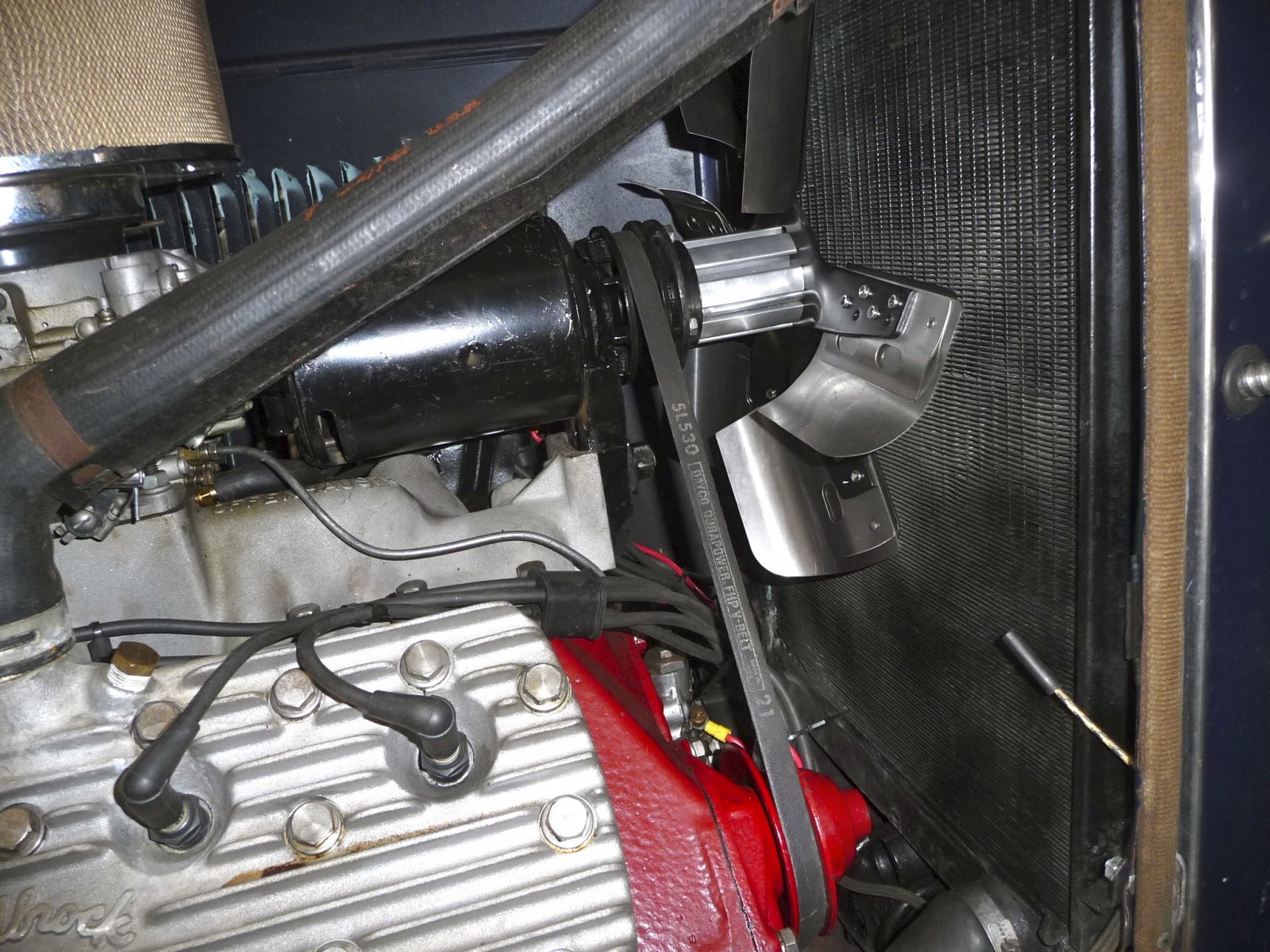

    I had at trim off some length from the blades of the gen mounted flathead fan in order to get it to clear the rad inlets. I made a templet and use it to trim each blade the same.
    I'm sure it's now unbalanced (not sure if they ever were- LOL).
    Looking for ideas on how to check the balance. The hub is too deep to use one of the lawn mower blade balancers. I've read before of using a nail.
    I'd ***ume a machine shop could check for this as well or is that not necessary?
    I just don't want it to come apart due to vibrations of being unbalanced.

  12. Why are you ***uming it's unbalanced after t*******? Was there a riveted or welded-on weight on the end of one of the blades you removed? If not, and you trimmed exactly the same amount off each blade, it should still be balanced however good it was to start with.
    I swapped the flex fan on my avatar for a clutch fan a three years ago (primarily to reduce noise, but it did improve cooling) and had to reduce the new fan overall diameter by 1.25" for clearance. I did the same thing you did; carefully removed the exact same amount off each blade. I've had zero balance/vibration issues.

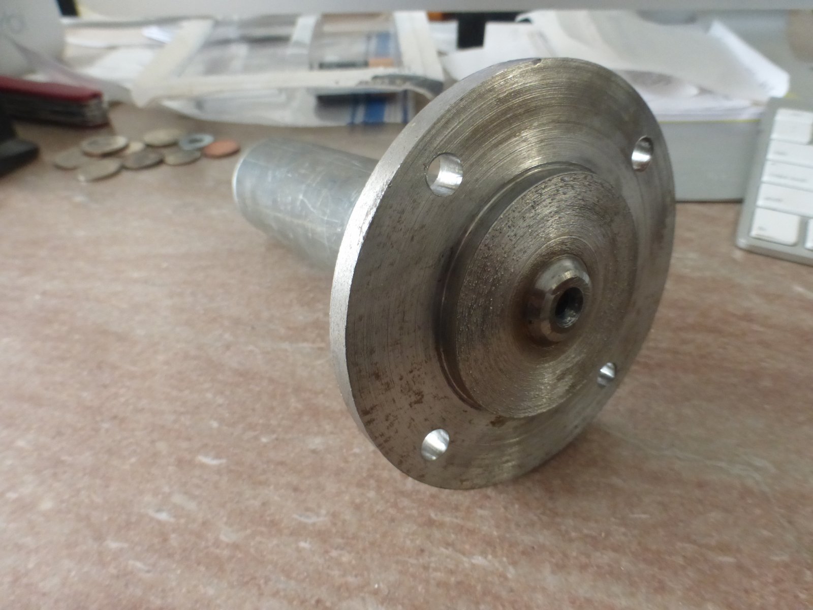

    I had hell with a fan on my 32 5W. It was modified from a crank mount to a gen mount. It shook like hell. I made a test arbour to spin it. It was just some bearings on a shaft with a flange. I could spin it with a drill. It was so far out I switched to a late model fan. I made an adapter that would bolt to the gen and the fan and extension would bolt to that. The drawing is incomplete as it was just a sketch for machining. The stainless fan still shook a little. I put the plastic fan on and it ran smooth and really moved some air.

    You might consider having a machine shop build the adapter I showed. You end up with a balanced, lighter, brand new fan. It pulls more air and is quieter. You can pick the hub length.
