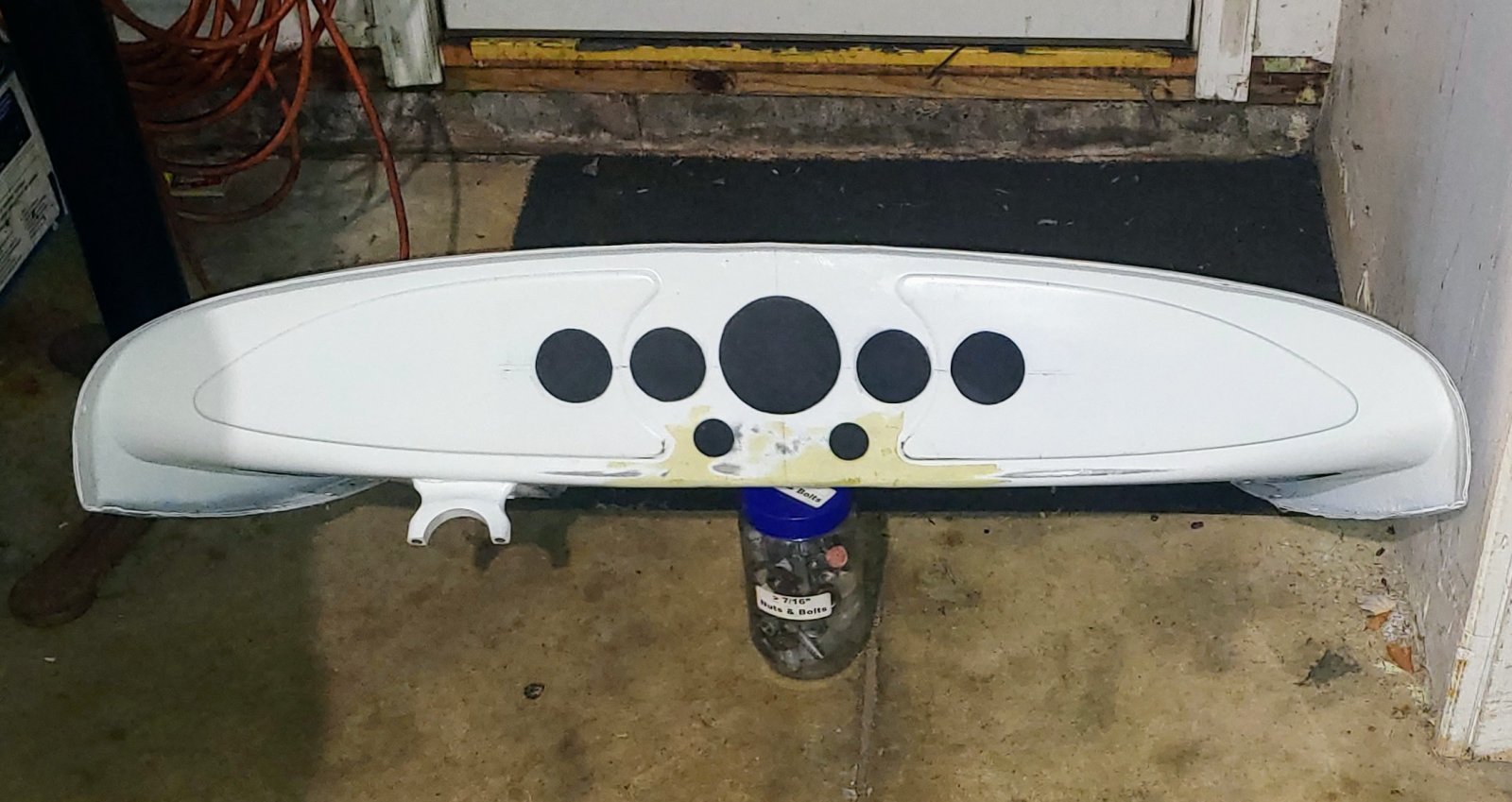

    Found a ‘32 style aftermarket dash for my ‘29 CCPU. The original tank is full of rust and I installed a new 10 gallon tank in the bed of the truck.
    I need some guidance on cutting out the front of the stock tank. Any pictures or advice would be helpful. I suspect that the ‘30-‘31 tank modifications would work for my ‘29. IMG_5080.jpeg

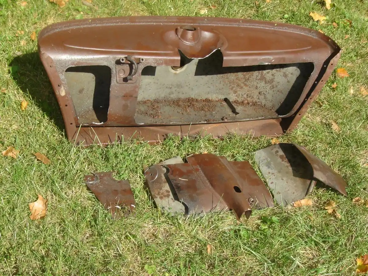

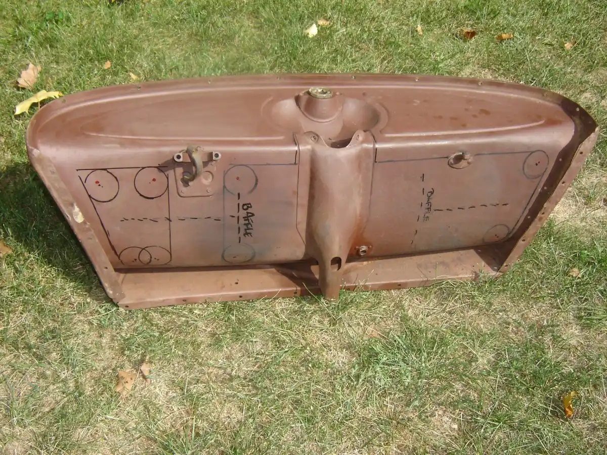

    There are baffles on the inside that you will likely want to remove - can get kind of messy.
    Not sure what you mean by "I suspect that the ‘30-‘31 tank modifications would work for my ‘29". (?).
    1928-29 Ford Gastank CUT OPEN #1.jpg 1928-29 Gastank - Cutout for repairing.jpg

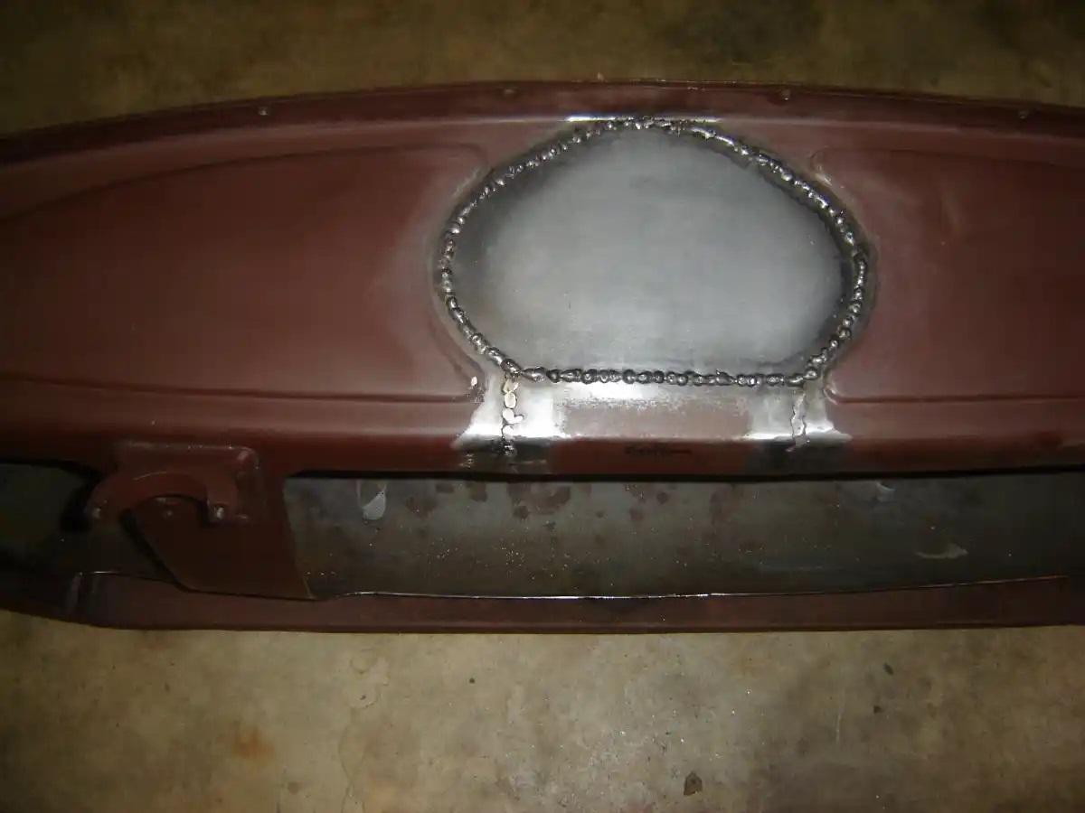

    Washed out with soapy water, followed by a spark-throwing cutting wheel on a 4.5" grinder:
    20071114_01.jpg 20071114_02.jpg 20071114_03.jpg 20220228_180017~2.jpg 20220404_204126~2.jpg
