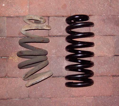

    Here's the result of "torch slammin" by the PO of my '63 C-10 next to a new spring. Suspension was bump rubber only and it ****ed.

    Cutting them screws up the spring rate & heating screws up the heat-treat. Call up Eaton and get springs w/ desired drop and the correct rate. It will cost more, but worth it. At the same time, the other methods have worked for decades I guess...

    Heat kills coil springs. My brother in law loaned us a '68 shortbox once with heated springs. The thing rode like a 2x4 on rollerskates.
