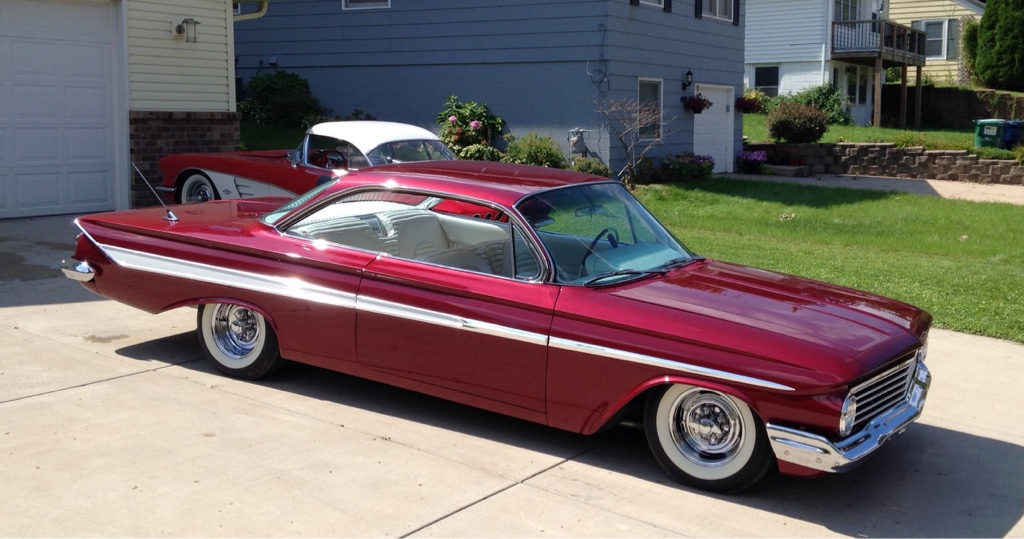

    I have been cutting springs on cars since the mid 70's . Never ever had a problem. you want them stiffer because the suspension travel is shorter so a stiffer spring helps to keep it off the snubbers. I cut the springs on my 61 Impala 40 years ago, and it drives great
