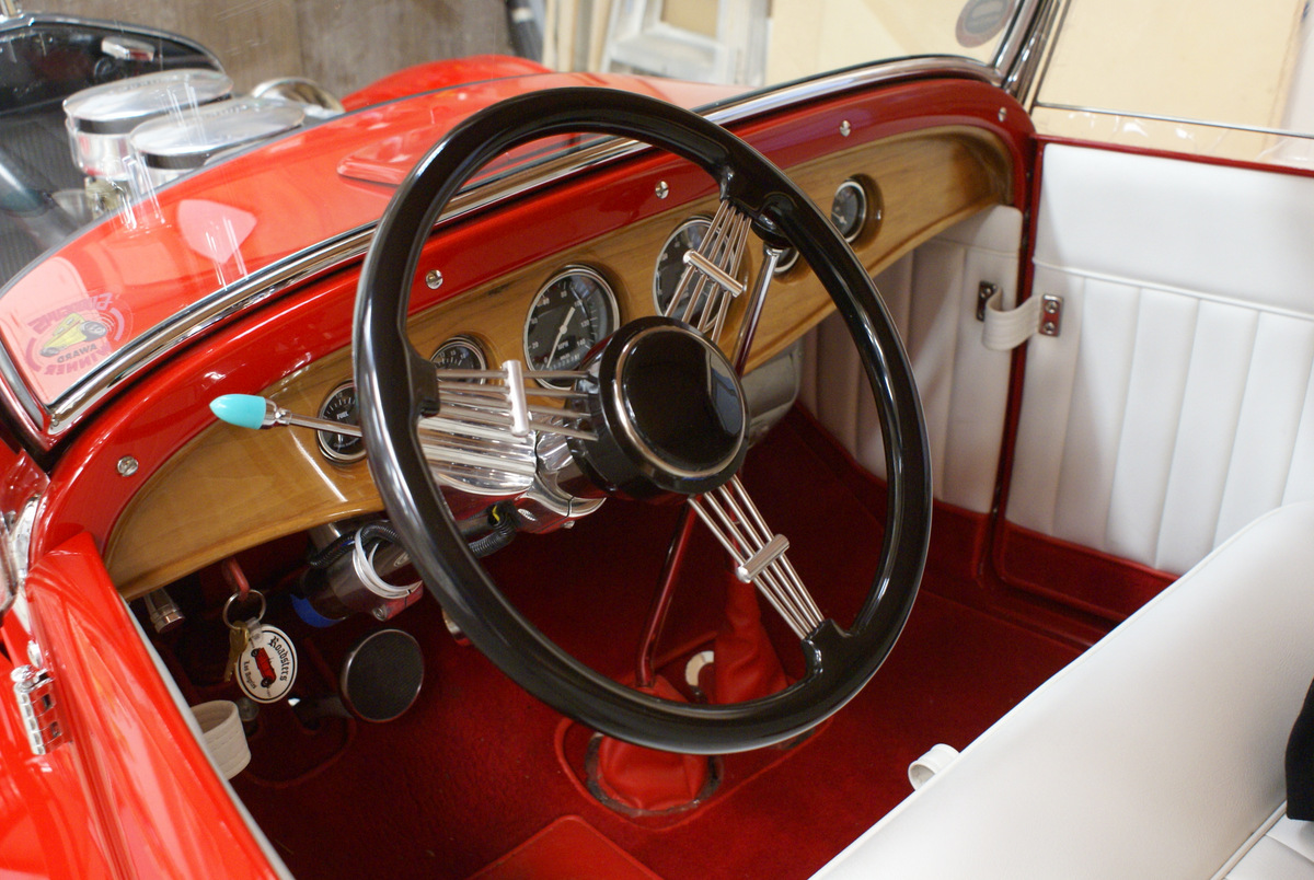

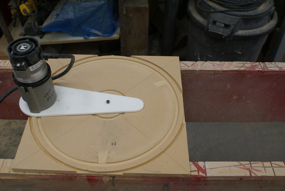

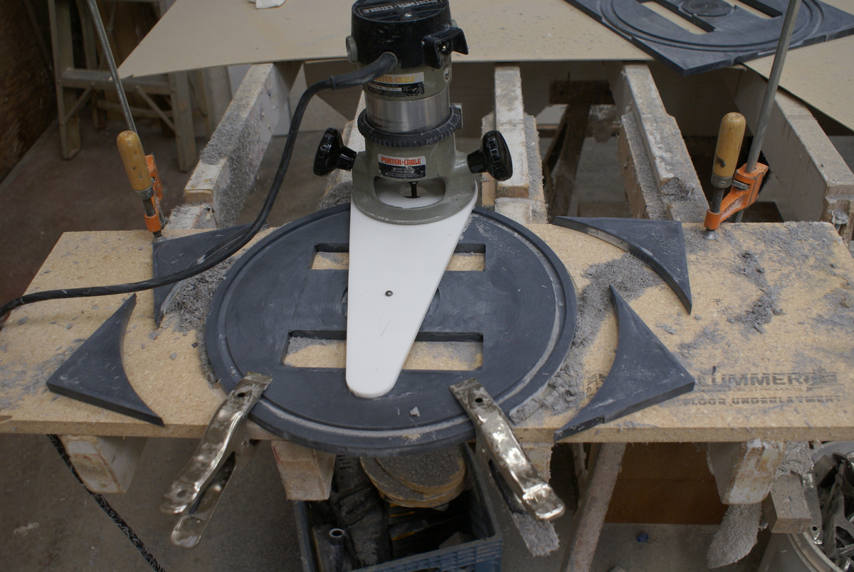

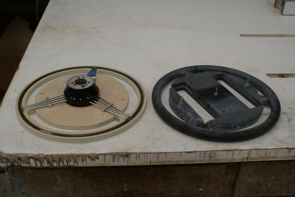

    I found a steering wheel I liked but it was too large (15 1/2") for my 27 roadster pu.

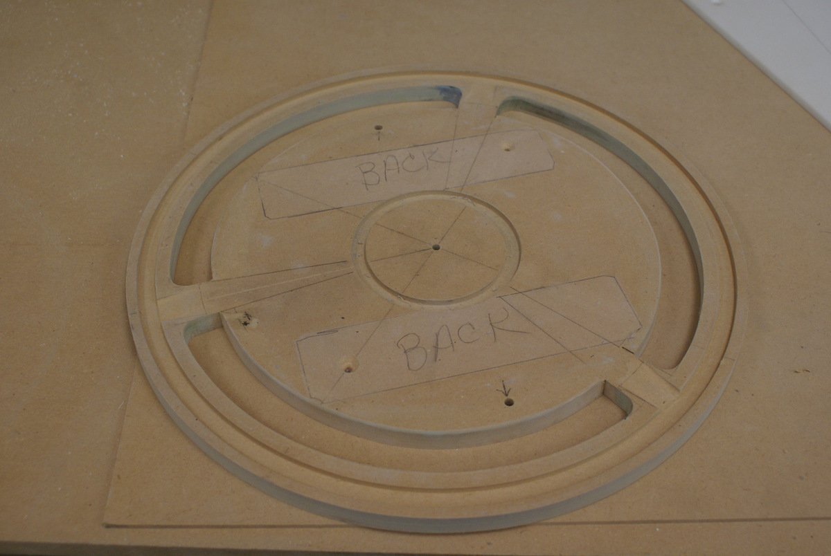

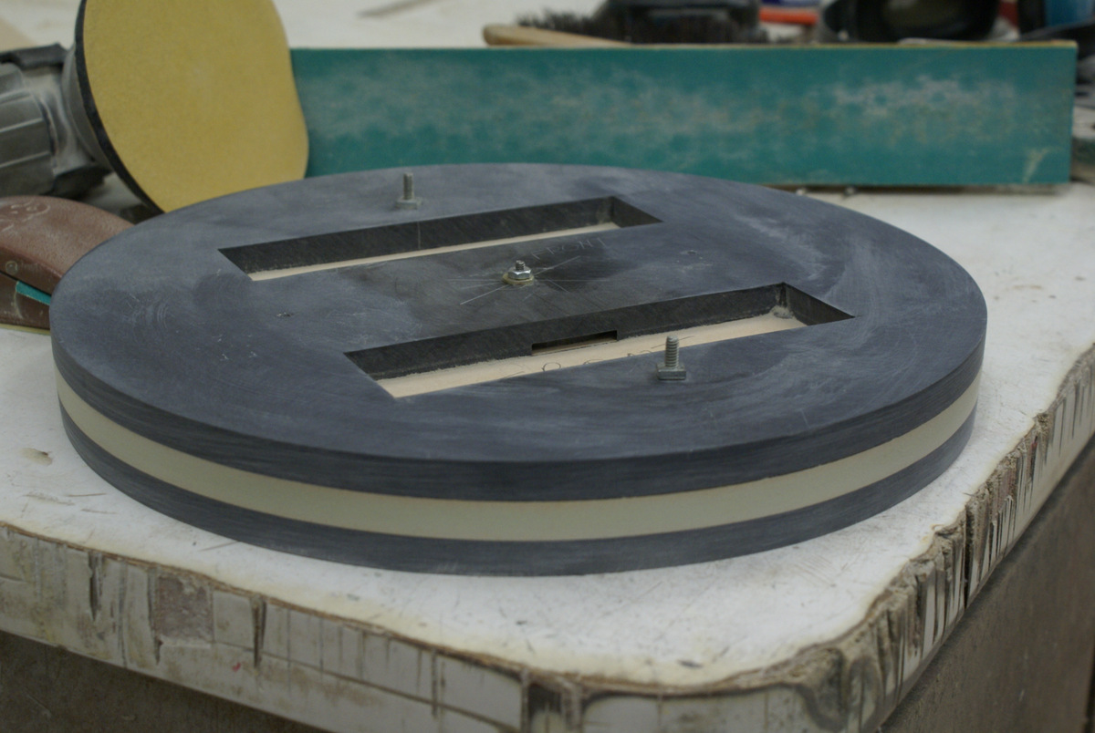

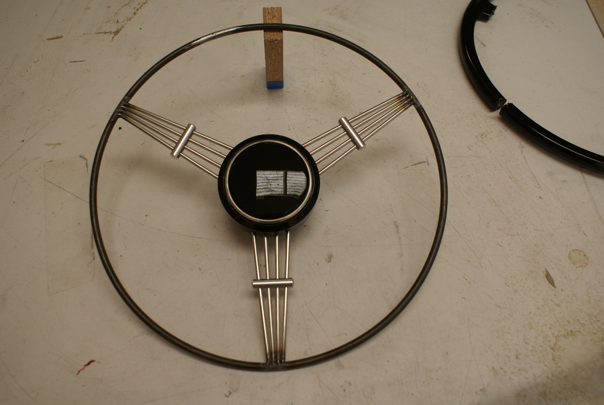

    I cut it down and made a new 1/4" hoop and for the rim I used 1/2" DuPont Corian countertop material (2 halves).
    I started by using MDF as a template and as a router guide. It ended up being 14" diameter. DSC08648.JPG DSC08654.JPG DSC08657.JPG DSC08664.JPG DSC08665.JPG DSC08668.JPG DSC08678.JPG DSC08681.JPG DSC08694.JPG DSC08732.JPG

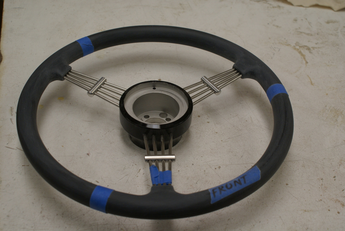

    Were you able to get finger ribs in it, if so how??

    Originally I was going to add finger ribs but when I taped it up (pic 7) and tried it, my fingers touched together so I figured I wouldn't need them. After driving it I'm happy I didn't.

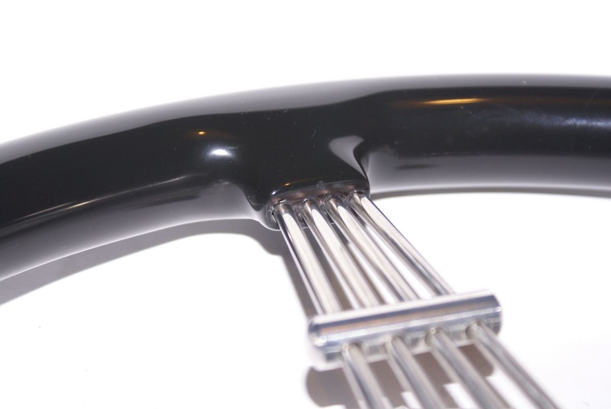

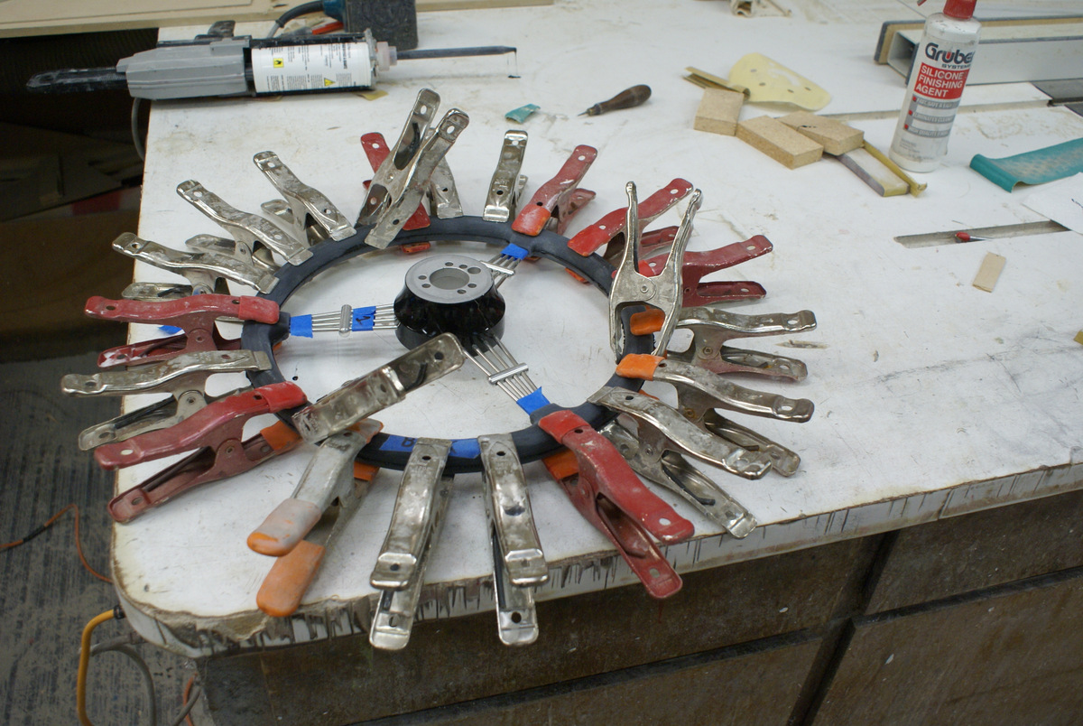

    46int... I used Corian joint adhesive (color matched)
    blackrd....The adhesive did flow around the spokes. To make a dam I stuck tape on the underside then used small dabs of hot melt glue to fill in the gaps

    The wheel came out beautiful. I looked at the pics several times and you either left out some steps or i'm just dense, I don't get the procedure?
