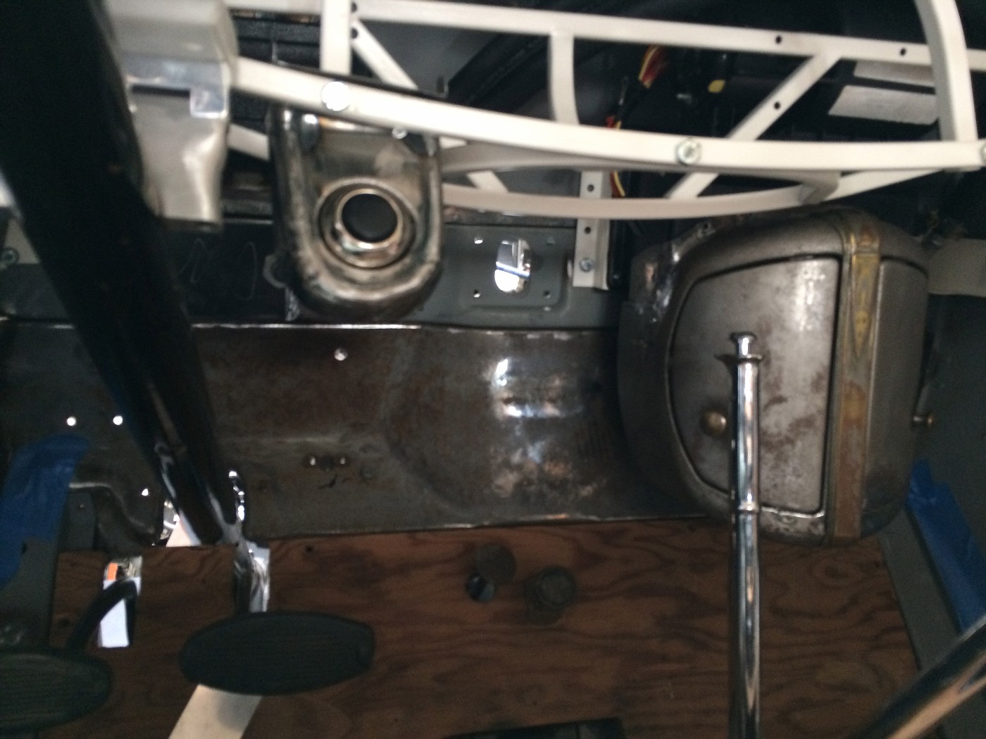

    For safety while cutting, you might want to toss dry ice in the tank to displace flammable vapors and oxygen. Even an old dry tank can support combustion. Dry ice is used also for cutting up old gas station steel tanks safely.
    I cut my ‘29 A tanks almost completely, leaving an edge around the top of the tank just enough to give the cowl top support to maintain needed strength. I build a bit of internal framing to give the cowl lateral strength and support for a solid steering column mount. The ‘32 ford style dash sheet metal stampings are great for mounting any instrument panel you like.

    I know it's an old post, but what tool(s) did you use to curve that tubing so nicely in the under dash structure?
    Just Gary likes this.
  10. Russ B
    Joined: Jun 13, 2010
    Posts: 1,651
    Russ B
    Another photo of the gas tank structure. I manually rolled the tubing in a device with three rollers, with a hydraulic cylinder on the center roller to adjust the radius. I used the same tool to roll several steering wheel rings, including the rim for this car’s steering wheel.
    I looked through my photos for a shot of the tool, but was unable to find one. I am currently unable to get to my shop due to health issues for at least another few weeks.
    It is kind of like a slip roll and is on a stand. I searched a bit on eBay to find one, but failed. Definitely a handy tool. Next time I am able to get to my shop, I will take a photo. Sorry I can not provide much help right now, but stuff happens when you are 80 years old.
