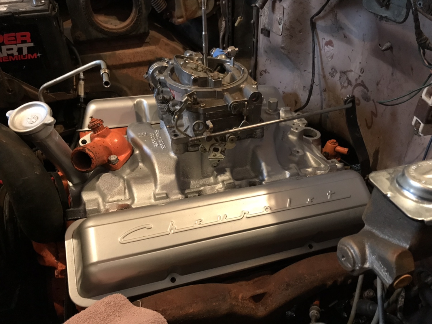

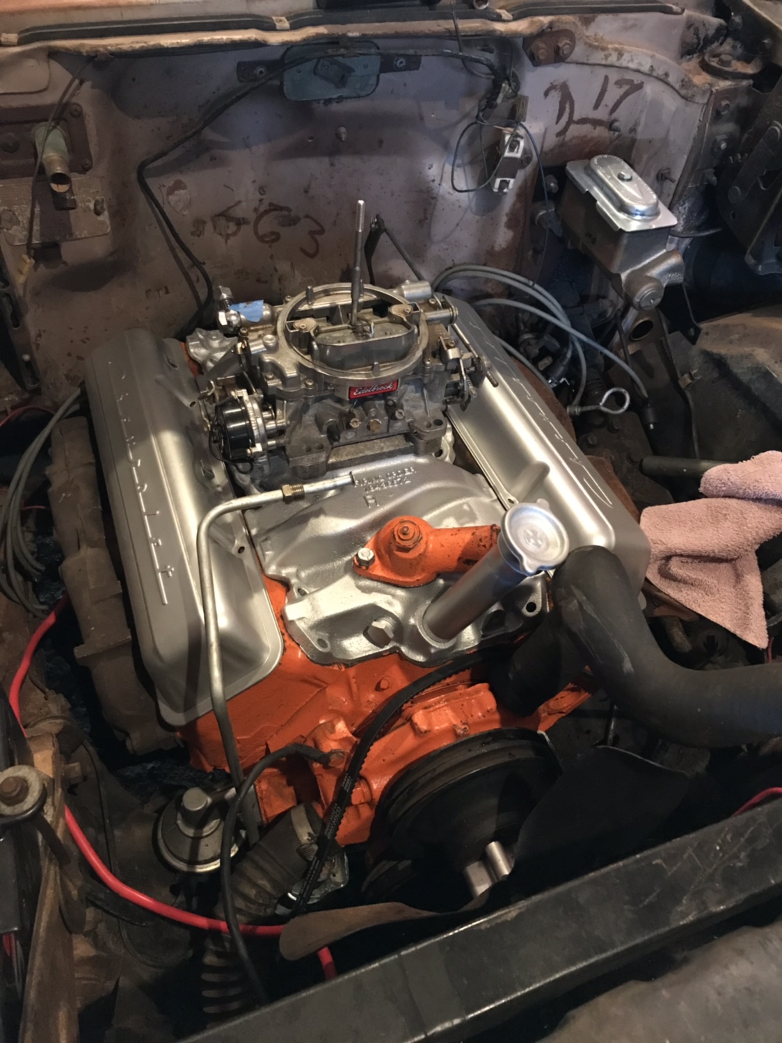

    I got the intake installed, was a lot easier than i thought and everything seemed to line up pretty well. The adapter i bought seems like it isn't going to line up, so i may have to find another one. I put it all together and the secondaries get caught on the plastic piece that actually does the square/spread conversion. I'll mess with it when its warmer out there. I had some 50 degree weather earlier but it's back down in the 30s again.

    Kinda late to ask this, but did you put the draft tube baffle back in.
  30. You may be able to clearance it with a file. Just remove enough to clear and have a little wiggle room. Do not do this with it installed on the intake. The plastic probably would go through the engine OK but why chance it.
