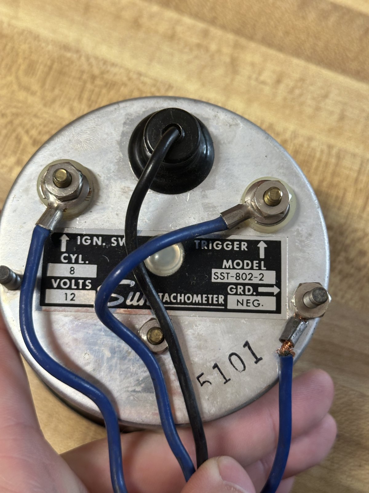

    Reading up a bit on old Sun tachs, not sure if what I have is going to work. I’ll post a photo but I’m trying to figure out if this tach needs one of those transmitter boxes or not. It specifically says it’s for an 8 cyl. I wish I would have known to check for the transmitter box when I pulled this in the junkyard several years ago. I know it came out of a 71 or 72 El Camino that had some sort of SBC.

  15. Moriarity
    Joined: Apr 11, 2001
    Posts: 35,570
    Moriarity
    SUPER MODERATOR
    that tach does not need a transmitter. you hook the trigger wire up to the - side of the coil and the other to 12v hot with the key on.
