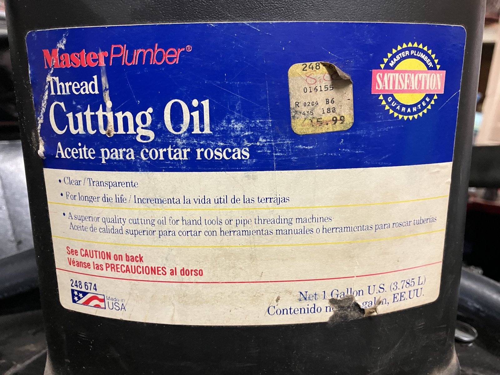

    I use plumber's thread cutting oil on my lathe and drill press. When making a through cut with a 3/4" end mill on my mill, I couldn't get my cutter to "bite" with the cutting oil so I tried plain water as a coolant. It worked good but the shavings and my table were rusting right away. I switched to some 50/50 anti-freeze mix for its anti-rust properties and it worked fine. I still use the cutting oil on the mill for light cuts.
