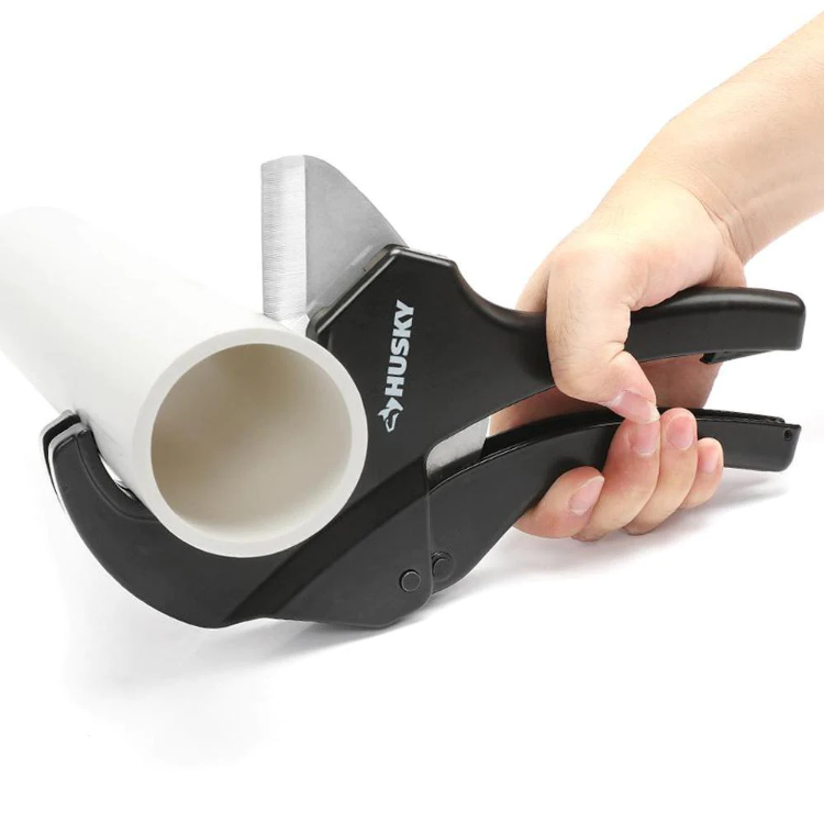

    Would a 2" PVC pipe cutter work?
    Lil32, Desoto291Hemi, bob b. and 4 others like this.
  7. That style is for ridged pipe, but I bet we could get them to do the job.

    As suggested, PVC cutters might work , IF you first insert a s**** piece of PVC pipe inside the hose so it won't collapse.
  19. Almostdone
    Joined: Dec 19, 2019
    Posts: 998
    Almostdone
    I use the PVC cutter. It works perfectly.
