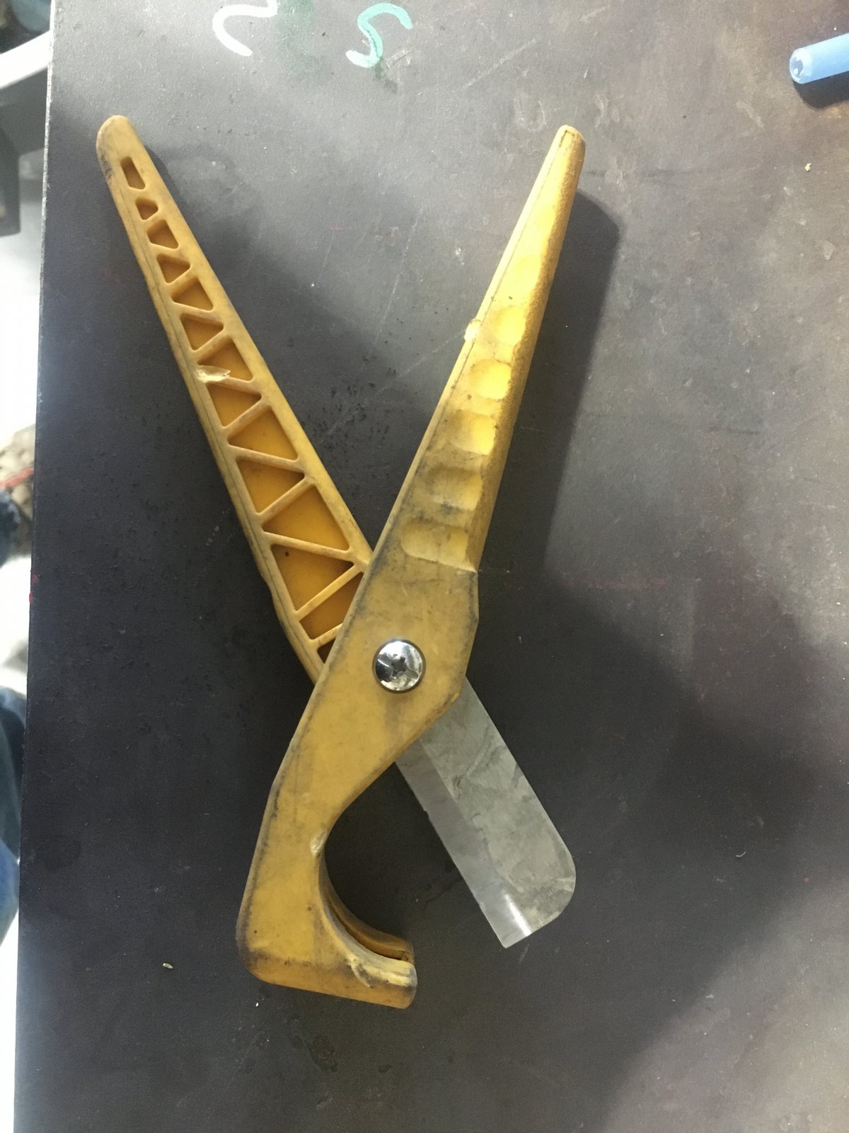

    image.jpg These are poly hose cutters. They come in different sizes. Worked in the marine business for a long time and automotive. I can’t tell you how many hoses I’ve cut with this style cutter. It’s the only thing I’ll use.
