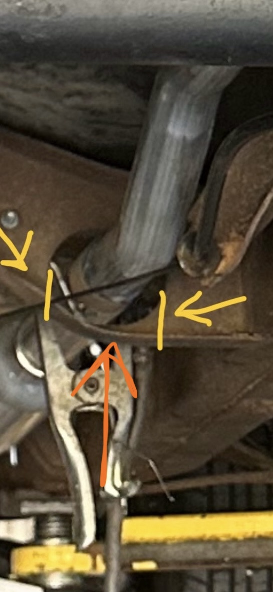

    What do you think guys? If I cut this section out on both sides would it cause any issues? IMG_7229.jpeg

    I dont think so. Looks plenty strong looking above .

    If you HAVE to cut it out, I would be inclined to weld a strap along the edge of the hole to replicate the upside-down 'T' or 'L' section that was there before on the edge.

    I want to get rid of the bottom edge to make exhaust removal easier without having to cut the pipe. What is the actual purpose of the crossmember? I've read it was just for rear seat support

    My thinking is Ford thought it important enough to put a return on that panel to increase its strength, it looks pretty thick material too.
    For the sake of just to make it easier to remove an exhaust, I'd do it properly and fit a bolted flange joint in the exhaust just before or after it.
    that's just me though;)

    Cut it out, use some 3/16" steel sections welded to the removed section, drill some holes, and make it a bolt in deal.
    or
    Weld a V-Band exhaust flange on the exhaust pipe near that crossmember so you can easily take the exhaust system apart to remove it and not have to modify the crossmember.

    You think Ford would put it there if it wasn’t needed? What’s more important to you, a strong frame or easy to remove exhaust?

    Cut the exhaust

    I thought about a flange but that piece of pipe would still be stuck in the hole. I'll probably just leave it though because honestly how often
    theyre welded solid

    You can do it right, or you can butcher it. Your choice.
    Why not cut the pipe, and install a V-band clamp ?

    You’ve been given multiple proper ways to fix your problem, oooooooor you can ignore it and hack up the car out of laziness
  14. I just used a large hole saw to cut an opening big enough to allow the pipes to go through and made the exhaust able to be separated in the rare event it needed to come off. The cross member still has its integrity and the exhaust is quite serviceable. I can't imagine doing it any other way.

    Guys have been replacing the exhaust on those shoe boxes and putting duals on them since late 1948 and you are the first guys I ever heard of who was too damned lazy to just do it right. You can cut a little out of the web on the top side if you need more clearance for pipes that are too big for the car .
    If you are having trouble welding it, you made the pipes wrong or have too long of a muffler .
