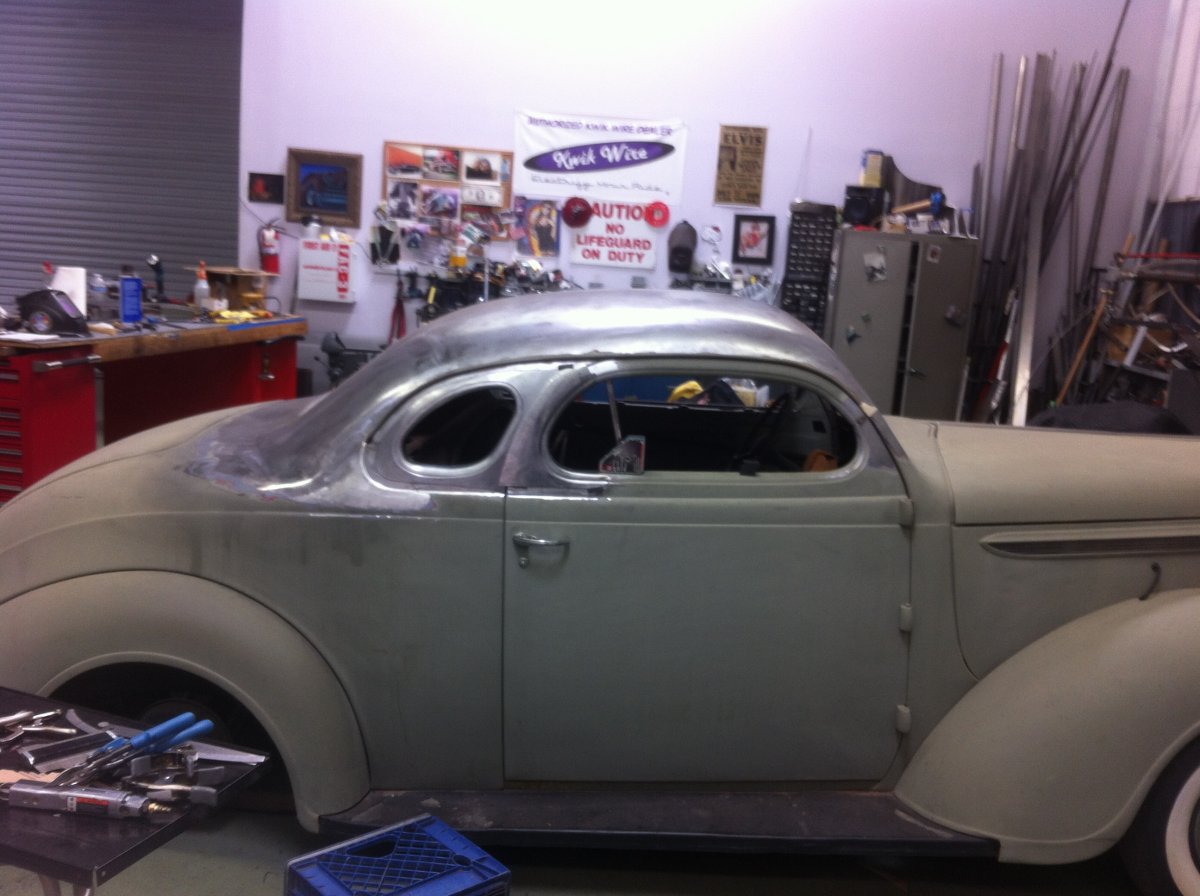

    Here are more pics: We will dial in the metal work after we get it back from sandblasting and get it back on the frame after fixing the floor etc. This is a full build.

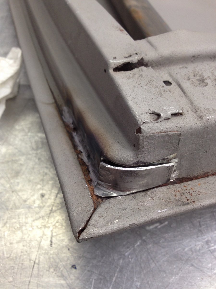

    Here are more pics after media blasting. Clark's been doing some rust repair on the fenders, body etc. He mocked up some kustom running boards. We will make kustom skirts as well, these were just to get a good visual. IMG_0887.JPG IMG_0891.jpg IMG_0893.jpg View attachment 3397058 View attachment 3397059 IMG_0969.jpg IMG_0973.jpg View attachment 3397066 IMG_1068.jpg IMG_1080.jpg IMG_1090.jpg IMG_1099.jpg IMG_3344.JPG IMG_1240.jpg IMG_1289.jpg IMG_3389.JPG IMG_3391.JPG

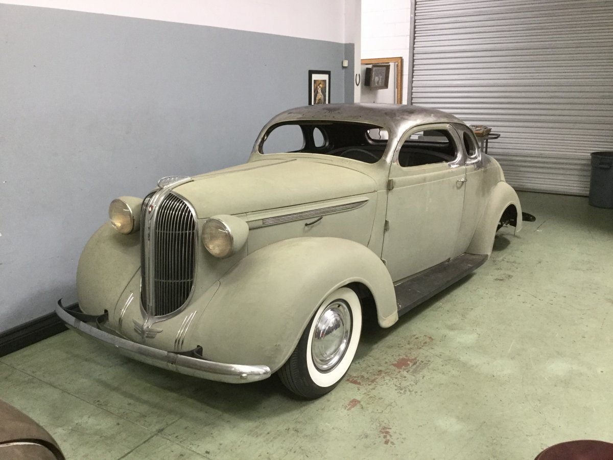

    Here are more unfinished progress pics: IMG_0571.jpg IMG_0573.jpg IMG_0574.jpg IMG_0577.jpg IMG_0578.jpg IMG_0580.jpg IMG_0585.jpg IMG_0803.JPG IMG_0804.jpg IMG_0806.jpg IMG_0807.jpg IMG_0808.jpg IMG_0810.jpg IMG_0811.jpg IMG_0814.jpg IMG_0820.jpg IMG_0822.jpg IMG_0825.jpg IMG_0831.jpg IMG_0833.jpg IMG_0834.jpg IMG_0835.jpg IMG_0836.jpg IMG_0839.jpg IMG_0840.jpg IMG_0842.jpg IMG_0934.jpg IMG_0938.jpg

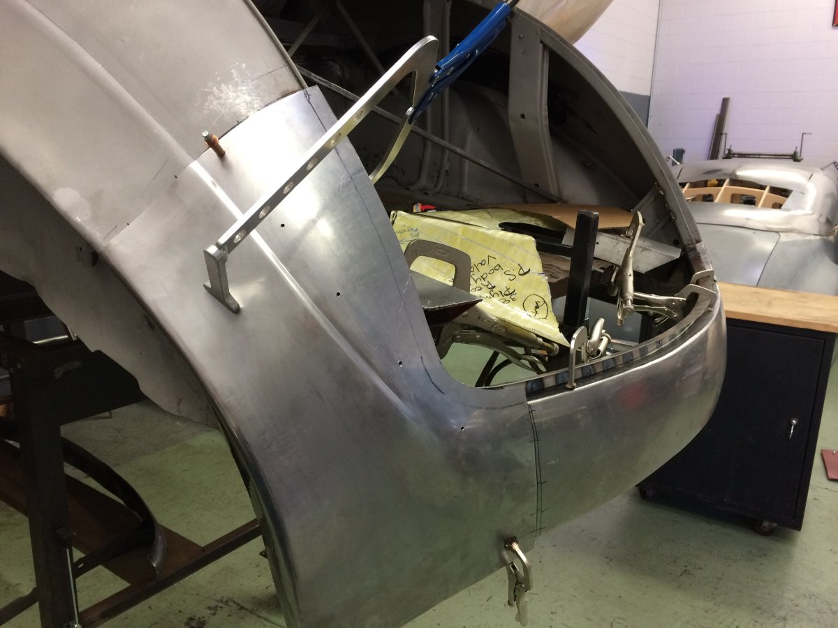

    Here are some progress pics:
    IMG_3512.jpg IMG_0357.jpg IMG_0358.JPG IMG_0437.jpg IMG_0438.jpg IMG_0439.JPG

  16. Wow. Great job you two, absolutely awesome. Reminds me of a woody a friend of mine built using a '47 Diamond T truck cab as a starting point. Once again I like it, I like it [emoji56]

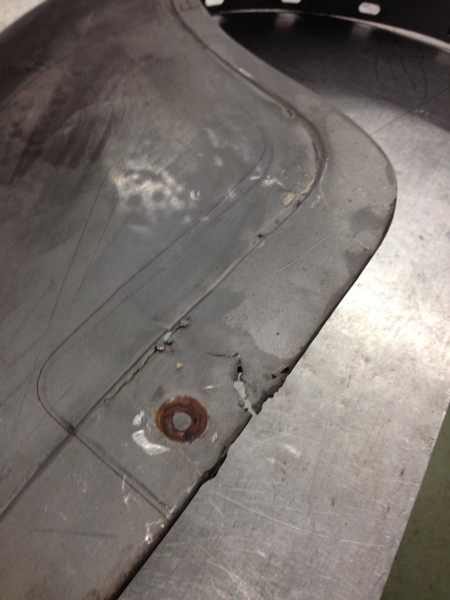

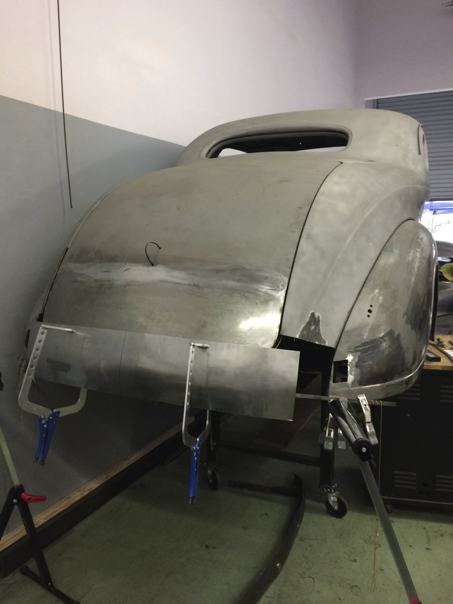

    Now thats some amazing metal work! I am really interested in lower rear valance I will be working on this same area on my 37 Plymouth. Thank you for posting the pics! Hobo Jim

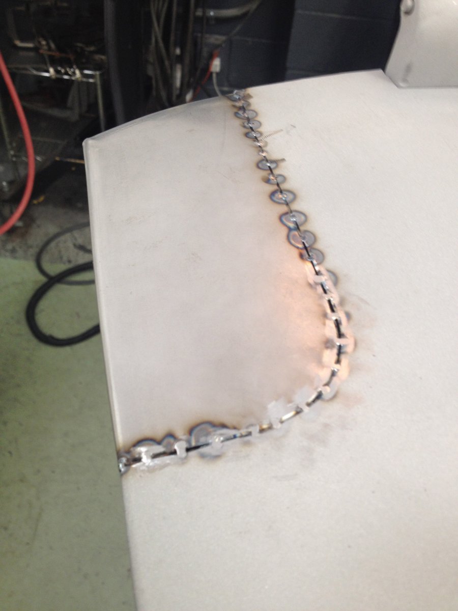

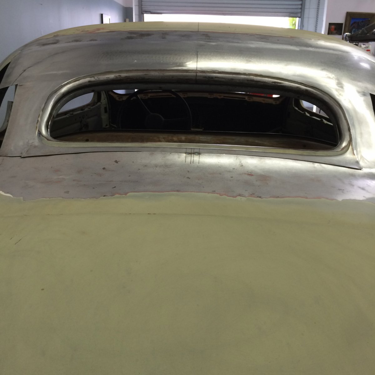

    I have to asked, are you using a TIG welder, I do not see much build up of material on your tags. Also your welded seams look very narrow, if you are using TIG, what size tungsten electrode are you using, must be a one with a very small diameter.

    I love the welding, it looks beautiful, if I start practising now, I might be that good in 5-10 years.

    Yes, we TIG weld all of the sheet metal. We use 1/8th with a very sharp point for panels and if we are welding sheet metal all day then we will use 1/16th. It just depends on what we are doing.

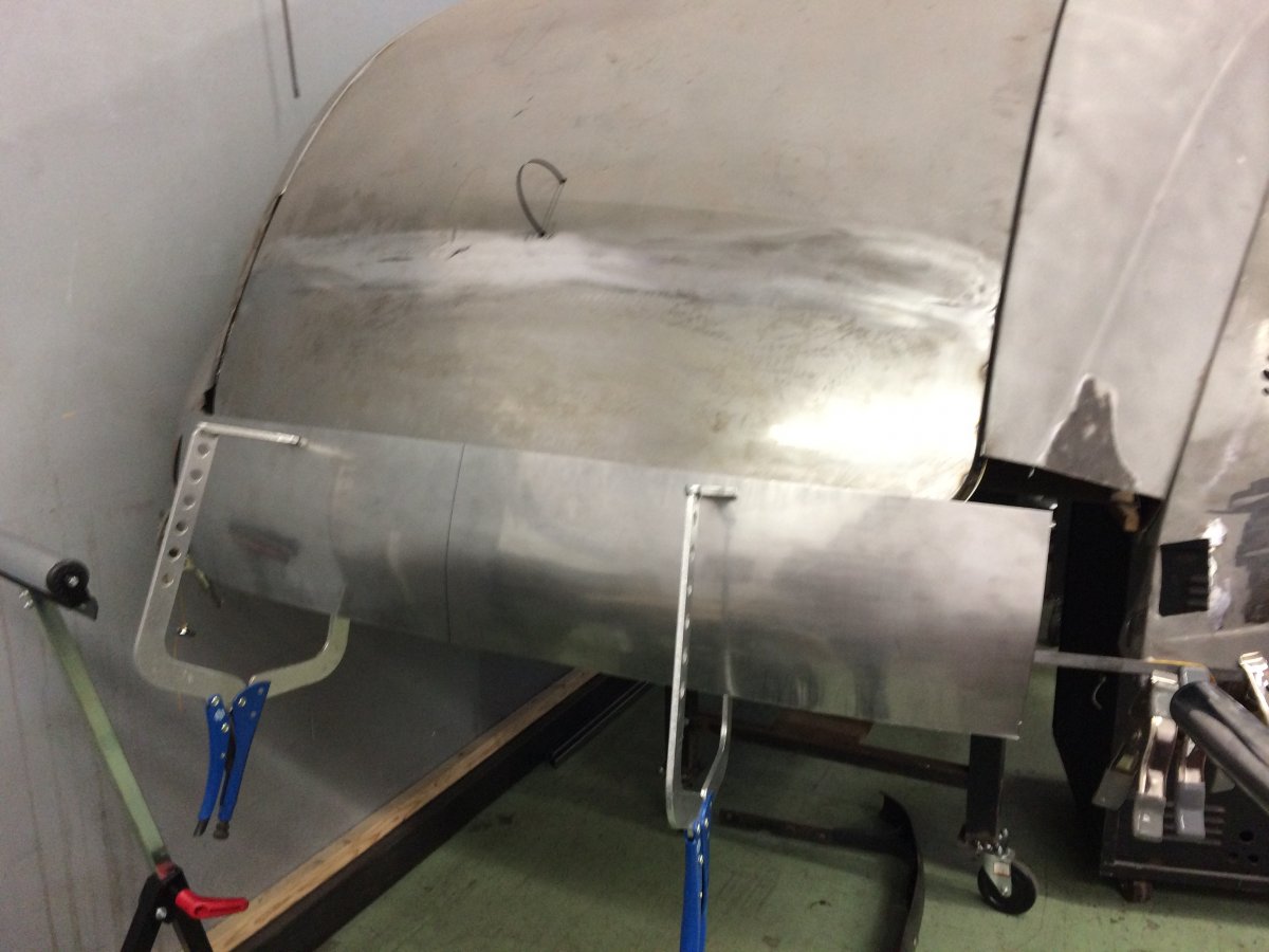

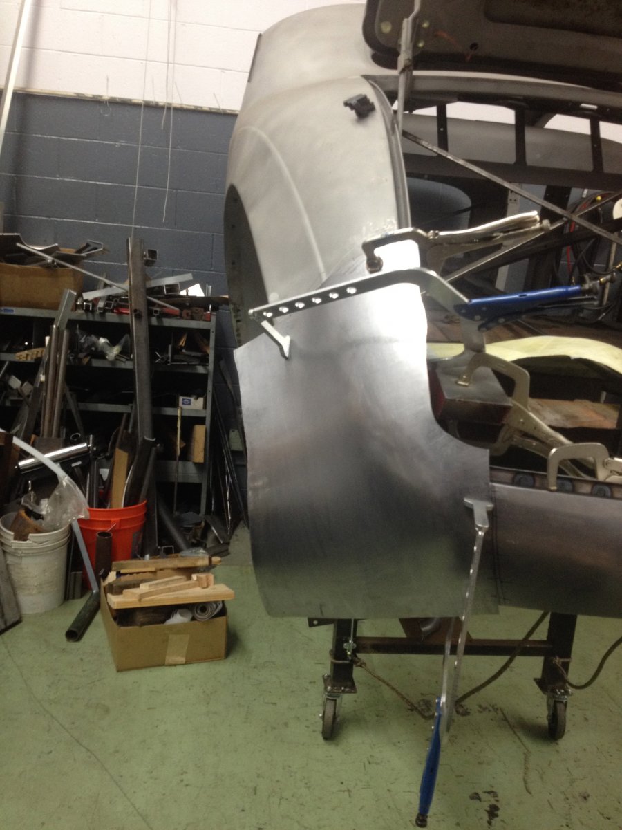

    Are those long , blue handled clamps aluminum?? Make?
    I've got some 18" clamps that are handy as hell , but awkward to use because of the weight ( and if over tightened they tend to twist) not that I would ever do such a thing (!)

    Yes they are. They work well. They are on the auction site:
    Napa P829 11" Clamping Locking Welding Pliers Bulk Spain
    Here are some more progress pics:
    IMG_0493.JPG IMG_0497.jpg IMG_2007.jpg IMG_0561.JPG IMG_0563.jpg IMG_0564.jpg

    very nice work on the shaping of the patch!
