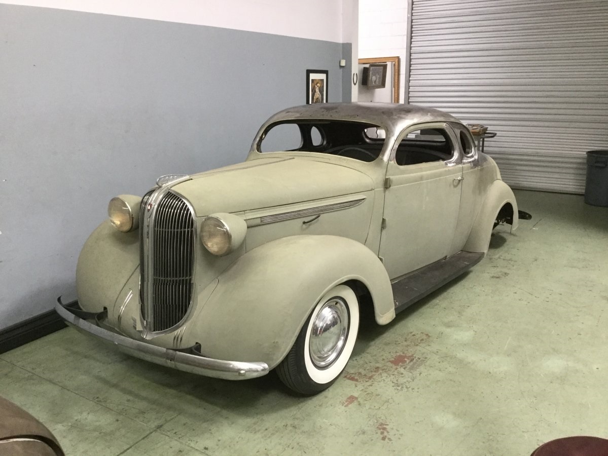

    The front end needs some love. We will see what Jimmy wants to do. We have a few ideas.
    Thanks so much!
    Here's another pic: We are building it low. These are just mock up wheels and tires. It will have white walls & artillaries.

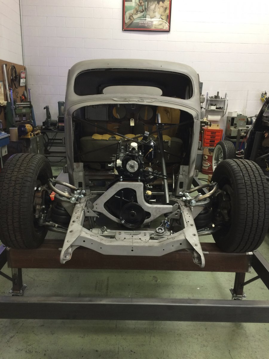

    Here are more progress pics:
    Got the engine in for mock-up, making new floors, made some fender skirts etc. The frame will come off later to get powder coated.
