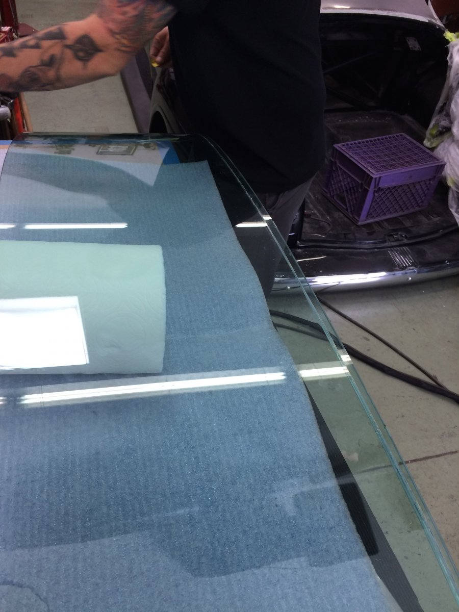

    Here are pics of the winshield IMG_0454.jpg IMG_0810.jpg IMG_0424.jpg IMG_0425.jpg IMG_0429.jpg IMG_0431.jpg garnish molding finished and the back gl*** cut down.

    Being that we are still new to this, we probably aren't qualified to be giving advice. There are some great tutorials on You tube. One great clue was to heat the area cut primarily on the gl*** that will be cut off. Also not lifting your gl*** cutter once you start your cut.

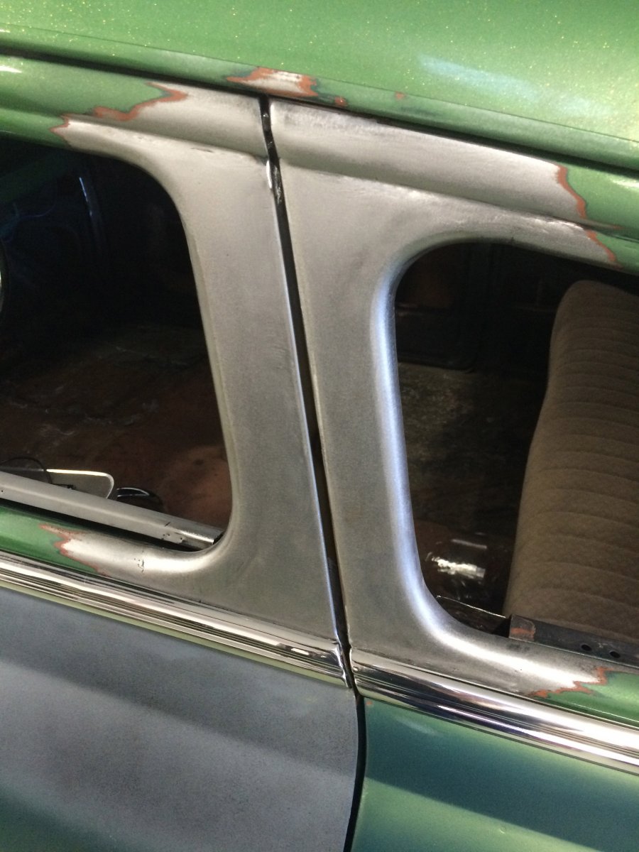

    Here are some more pics: We made the outer skin of the B-pillar as well as the B-pillar itself. This week we will be getting the windshield and back gl*** in, possibly the side gl*** as well. We are waiting on the vent windows that are getting chromed. So we might take it to Bob's in Toluca Lake this Fri. since it could be leaving in the next week. IMG_0596.jpg IMG_0597.JPG IMG_0602.jpg IMG_0604.jpg IMG_0606.jpg IMG_0610.jpg IMG_0949.JPG IMG_0950.JPG IMG_0952.jpg

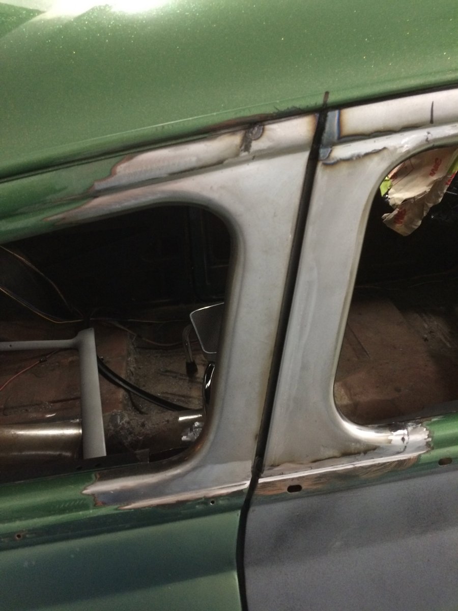

    Here are some more pics: Getting an idea of what it will look like with the stainless trim. Clark had to cut the windshield down another .5" to make more room for the rubber. Cut down the D.S. garnish moulding & we extended the back of it to match the new B-pillars. We made the B-pillars a little wider for better aesthetics. IMG_0653.jpg IMG_0654.jpg IMG_0655.JPG IMG_0657.JPG IMG_0661.jpg IMG_0662.JPG IMG_0663.jpg IMG_0664.jpg IMG_0666.jpg IMG_0667.JPG IMG_0668.jpg IMG_0669.jpg IMG_0672.jpg IMG_0673.jpg IMG_0674.jpg IMG_0675.jpg IMG_0677.jpg IMG_0679.jpg IMG_0680.jpg IMG_0681.JPG

    Hi Bob, you are absolutely right! Yes it's a test fit and it does matter in California. We prefer to do a test fit, then install the gl*** after paint. We have explained the need to remove the gl*** and trim before paint to our customer. We don't do any paint at our shop, so all we can do is suggest this to our customer. At the end of the day if they want gl***, trim etc. installed before body work & paint even though it will need to be removed to paint it properly then we do what they ask. The car is going over 150 miles back to where it came from for paint, so it's really out of our hands at that point. That would be an expensive house call!
    The welds visible on the four corners of the windshield are factory leaded seams that got the lead cooked out of them during the chop. They will need to be re-leaded or bodyworked before paint. The other option would be to cut those areas out and patch in new panels to smooth those areas, but that would be beyond the scope of this project's budget.
