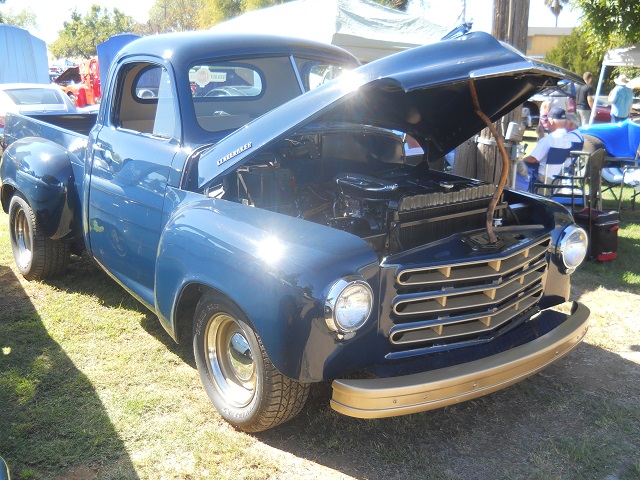

    Here are more pics. It started as a chop, then Hugh had us shave the fuel filler, the door handles, some emblems, made a roll pan. The rear lights were terrible LED's so Clark had an idea to carry the beads from the tail gate into the tail light area and add some Studebaker car lights. Running them vertically and carrying some of the details from them into the roll pan area etc. Anyways...here are some pics. IMG_5561.JPG

    Very nice love the tail lights . How do you weld in yor panele ? Hammer weld or mig ? I see no warpage !

    I really dig the way you brought the beads from the tailgate into the end caps
    for the bed. Keep up the good work.
