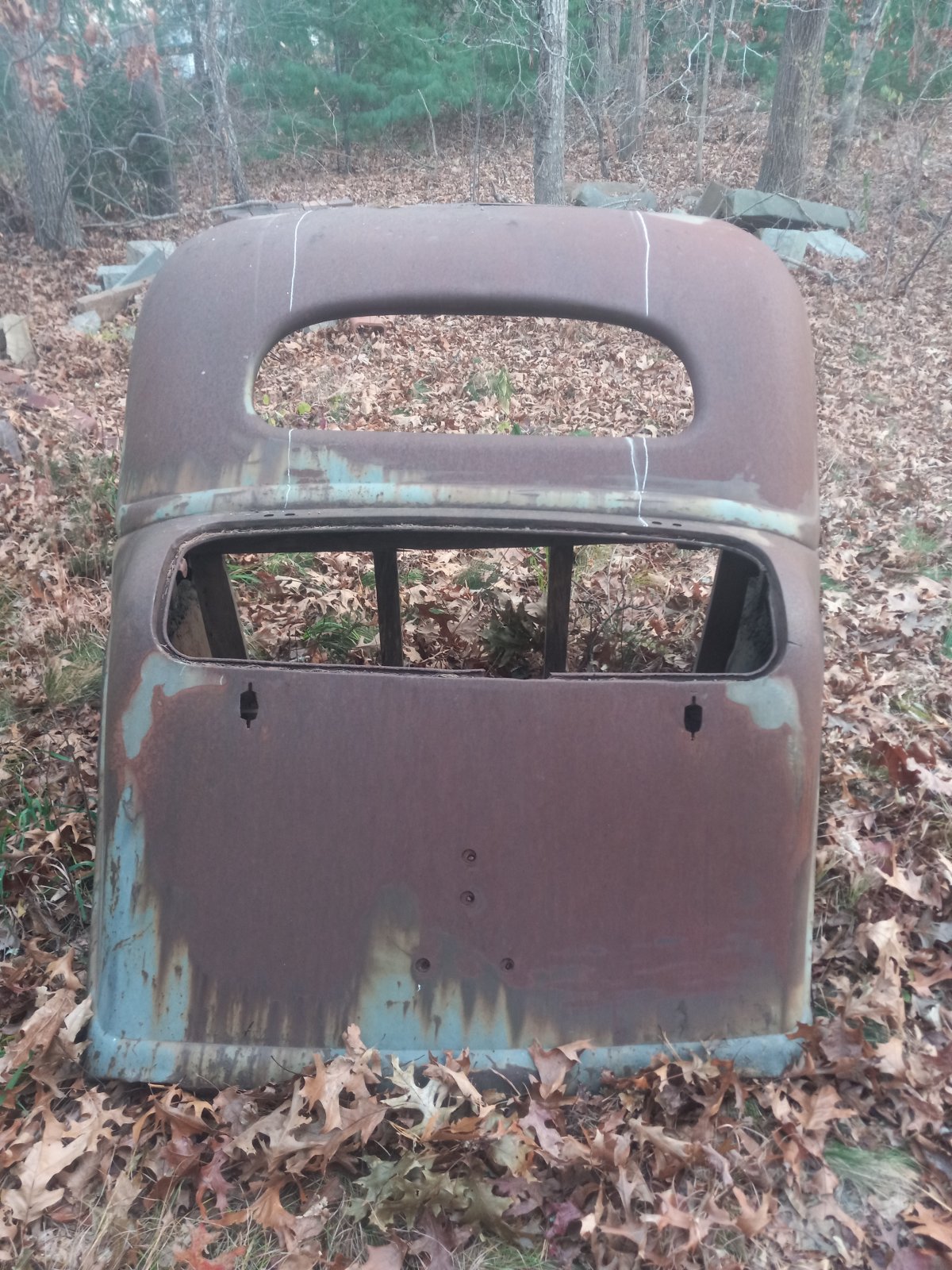

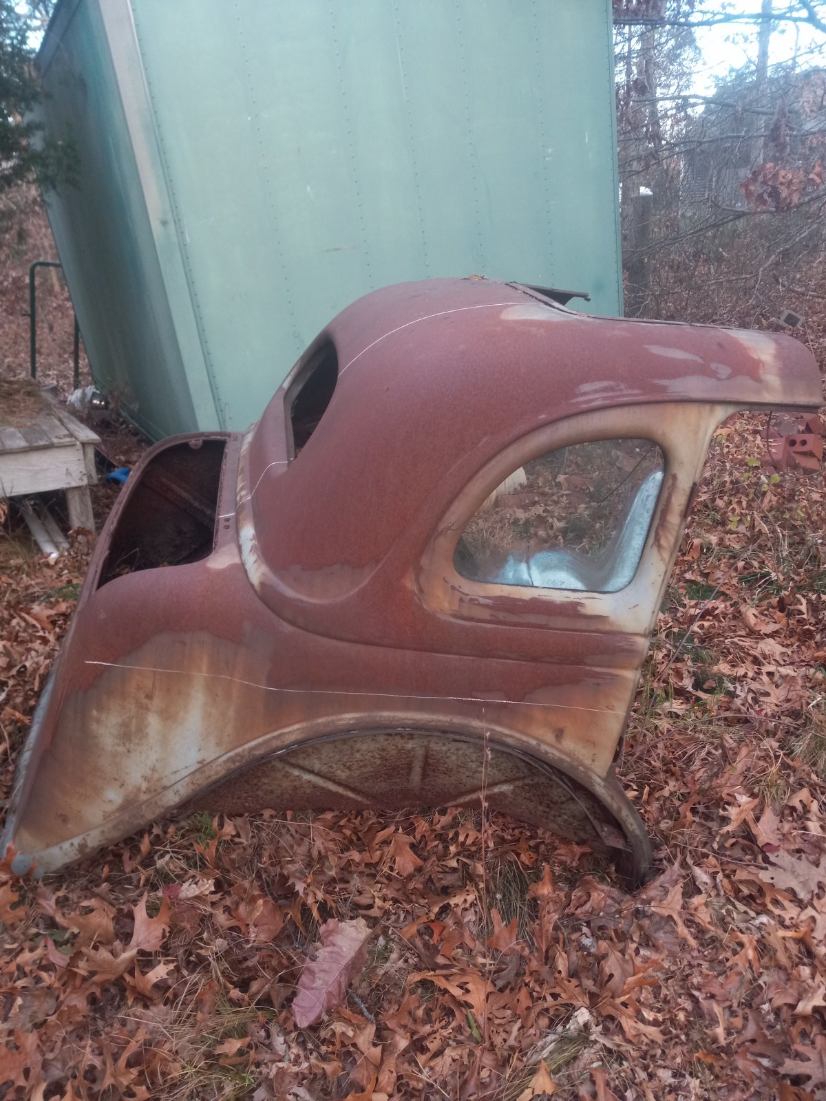

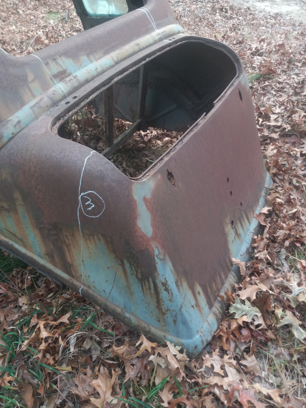

    I have the rear portion of a 35 4 door Humpback Sedan. This can't stay out another winter so I want to take the whiz-wheel to it so I can store it inside. Where would you cut ?
    1. Save the sides
    2 Save the roof
    3 save the tailpan
    35 is a one year only ,roll up rear windows. I KNOW it's not a super desirable model . Somebody will need it SOMEDAY. I just want to make it more manageable to get it inside THANKS Mike 20211204_071050.jpg 20211204_071142.jpg

    If you must cut it for storage, I’d cut it at the reveal below the windows and leave it at that. That’s a good keeper.

    Wherever you cut it, it will be wrong for the next guy. I would cut it thru the windows, like for a chop. Then cut it so the wheelwells were in one piece. Then the catwalk like you pictured.

    I personally would NOT cut through any of the window openings. The body line that goes under the back and side windows can be modified for 33/34 Ford coupe usage (I have a chunk of one of these cars just for that) and also the rear window opening would likely be useful for a 35/36 coupe. cutting it like a 'top chop' would destroy the value of the window openings for those purposes.
    If it absolutely has to be cut, I would cut the top off below that beltline to make it into 2 halves. Someone who is fixing a sedan either from rust or crash damage is only going to need the lower stuff, someone looking for sheetmetal to fix a coupe will likely only be able to use the roof pieces since the tail is so different on a coupe. That's the only logical way to cut it in my opinion. Then you have 2 large pieces instead of one, might make storage a bit easier.
    But I do agree that if you don't need it, now is a better time to advertise it to see if anyone will buy it whole. That'd be the best use for it.

    cut out the whole back window down the bead line
    rear trunk area
    wheel wells about 2" above the bead line
    1/4 window area, rear bead lines can be used on 3 and 5 window coupes
    rear 1/4 window molding and window reg are asked for all the time
    later kb
