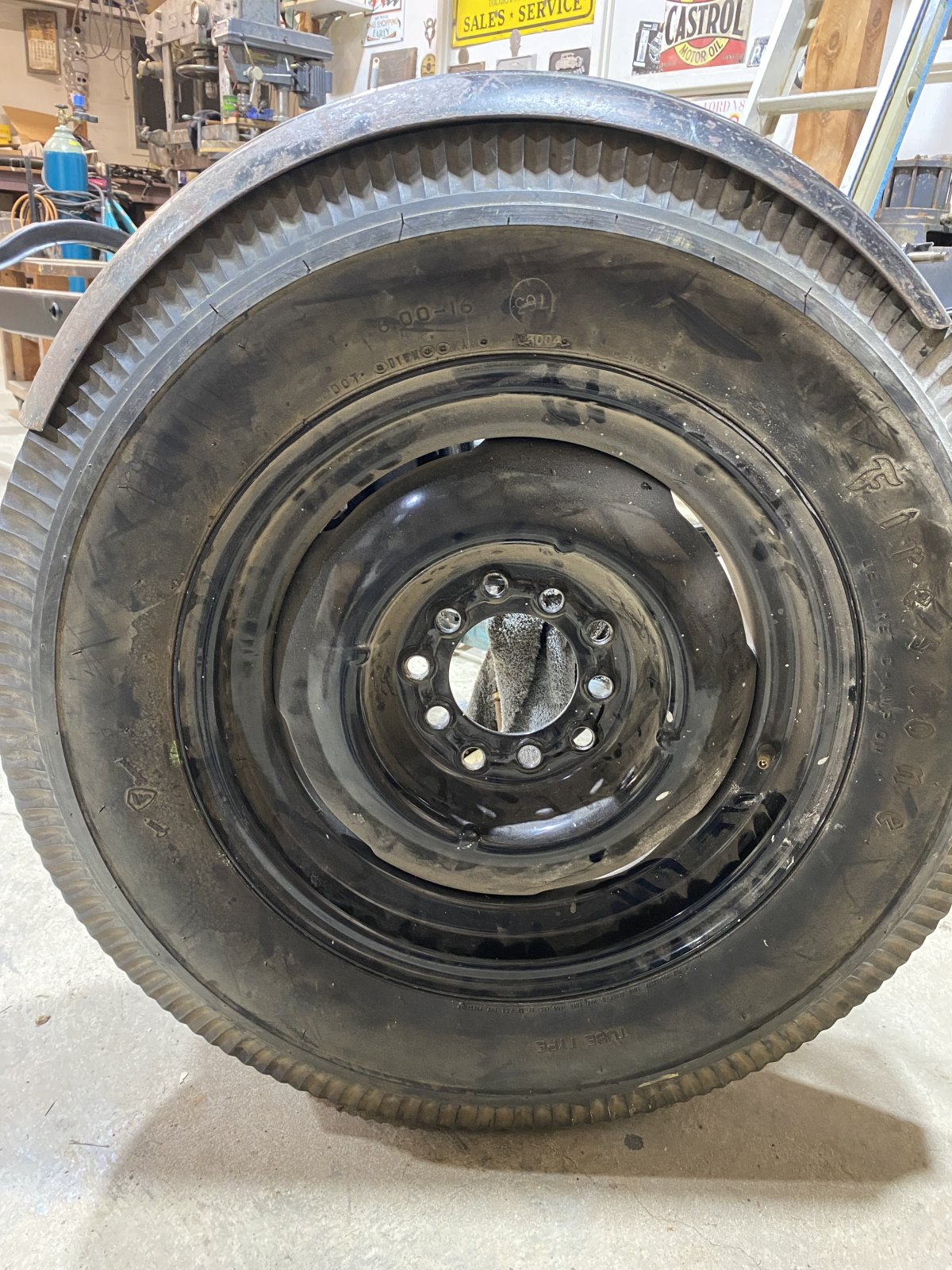

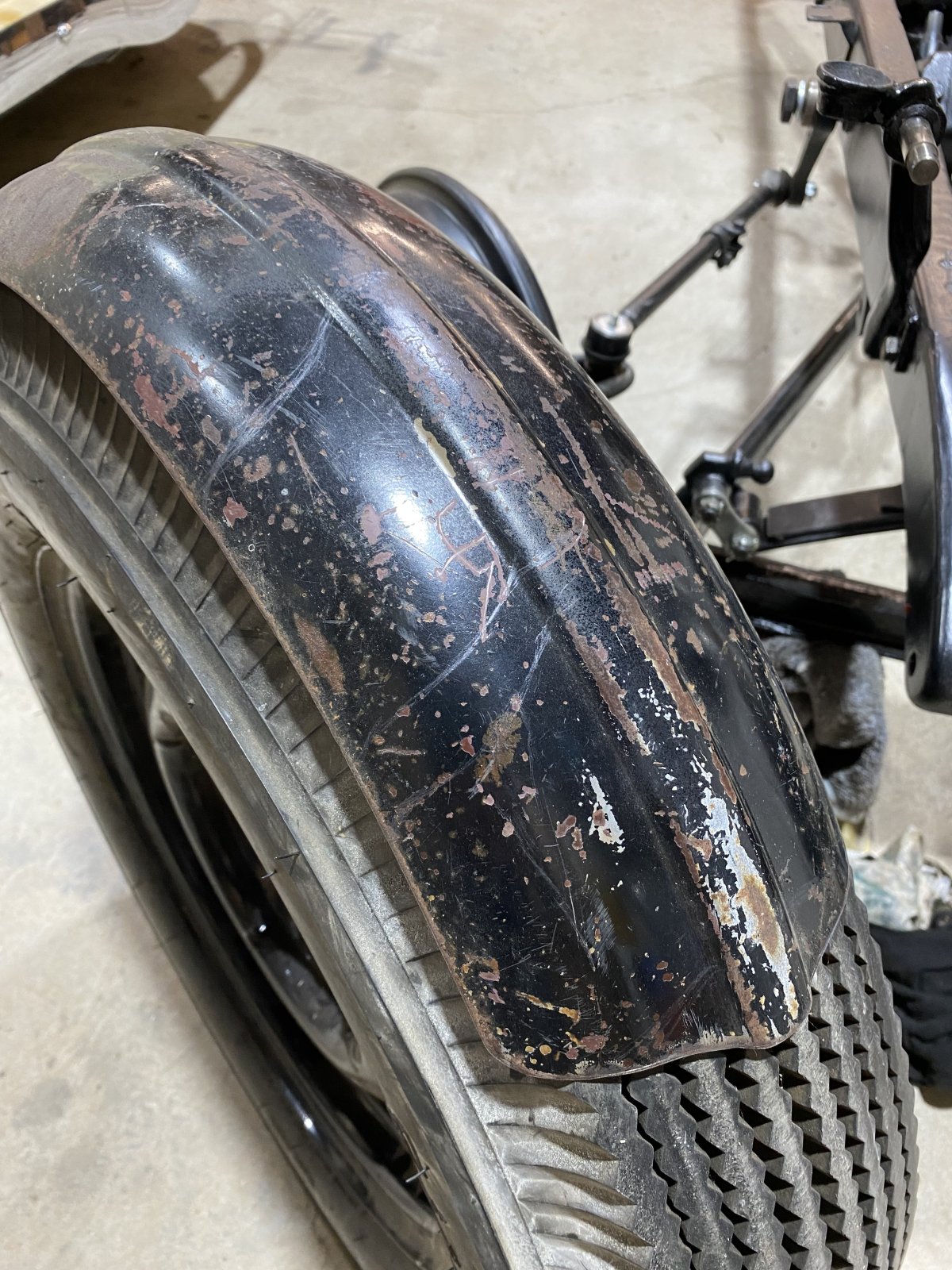

    Down here cycle guards/ mudguards are a requirement for registration so l figured go with the traditional old school way and use a 36 ford spare tyre hoop. So l am into it a bit and as can be seen l really need to change the contour of the guard to get a better fit. Not looking to change tyre diameter at this stage.
    Would heat shrinking be an option? Thoughts?

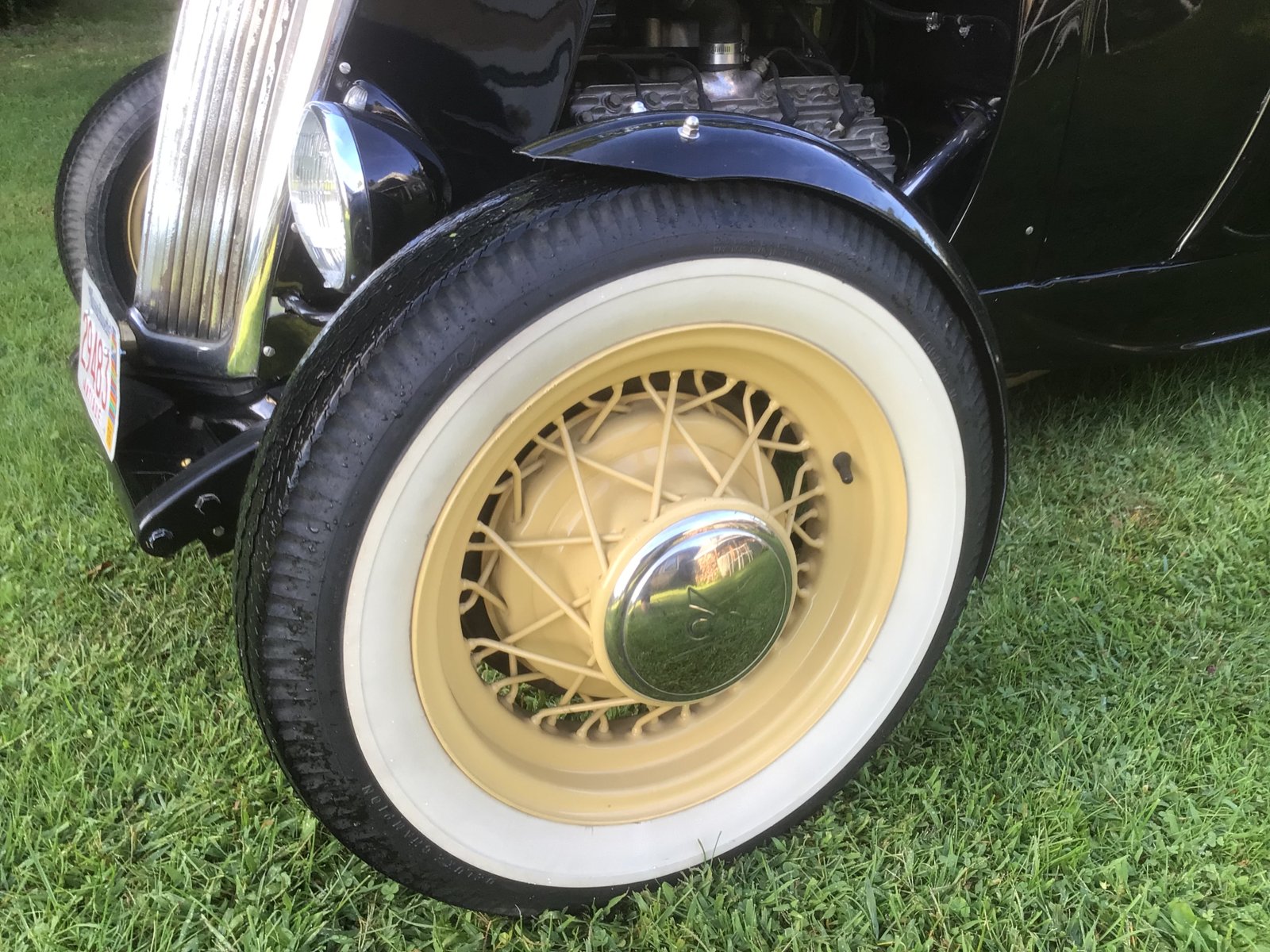

    How about getting smaller tires? These are 500/16. ‘36 spare tire covers. IMG_5417.jpeg IMG_5418.jpeg

    Gotta love the Hamb. The OP says he doesn't want to change the tire diameter, and the first post suggests he do just that. :p

    Tricky, as you open it out it would flatten the profile slightly. Another option is to put transverse slits accross the raised bead and the reweld them to pull the radius out. A lot of work.
    Plan B would be to get the correct radius tire cover from a 4x4 and someone with a bead roller to form the profile.

    You know as flexy as those things are I’d be tempted to build the supporting frame and brackets and see if when you flex it open to fit it on if you can just bolt it on and be done. Would it be in a little bit of tension? Probably, will be make any difference? I doubt it

    Yep, flatten the arch a bit and the radius will change.

    If you stretch the outer edges of the fender it will increase the radius of the curve to fit your tire better

    The cost of a new similar tyre down here will set me back probably over $500 per tyre once fitted so exploring options.
    Will not get it p***ed if I was to cut it shorter.
    I will try some stretching flattening on a bit of the off cut, I feel that the centre ridge is going to make it difficult to get it to "open up"
