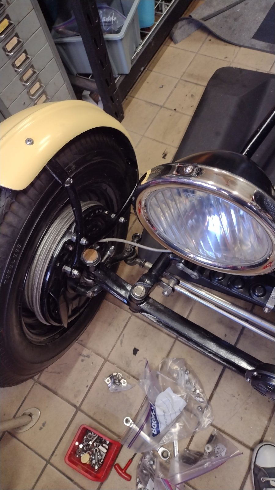

  1. IMG_20210718_173914161_HDR.jpg IMG_20210718_150542664.jpg IMG_20210718_172921023_HDR.jpg Fitted my mudguards today. We have to have them here when it rains.... Which is very often. The stays are made from 1920's bicycle forks.

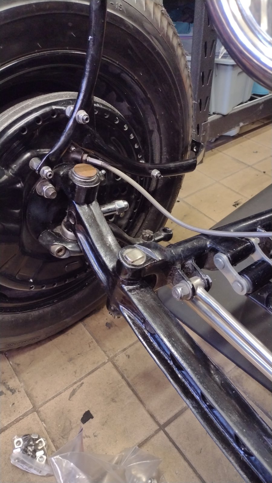

  6. I will take some pictures tomorrow. The rears have heavy duty brackets coming straight off the spring shackle brackets. The fronts are bolted to three points on the brake backing plates
    Stogy and gnichols like this.
  7. Found some. One bolt just goes through a rib near the centre of the backing plate. The other two are studs that take an Allen key in the end and they bolt into some weld bungs in ventilation holes round the edge of the backing plate. The backing plates are extensively drilled and fitted with air scoops on the leading edge. All bolts are 12.9 high tensile.
    The mountings are very solid. Slightly worried the edge of the backing plate could crack under vibration - but they were heat treated after welding to make them less brittle. It won't be a disaster if it does. I will weld on a 6mm reinforcement plate following the circumference of the backing plate.
