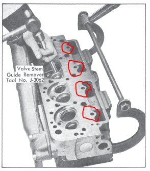

  11. KJSR
    Joined: Mar 7, 2008
    Posts: 2,492
    KJSR
    from Utah
    Those bolts look a little long not to go into the block........
    The Hyena likes this.

    My research confirms what Charlie is telling you. Cad 429 has 17 head bolts per side with the top 4 doing double duty as rocker shaft bolts. My question is: how the hell did you get the other head off without removing the rocker shaft?

    Sure looks like the rocker shaft bolts go clear through.

  19. Also , the rocker bolts line up with holes in the head gasket. Imagine that.
    In answer to your question ..He didn't. We're being spun here..He bought somebody else's nightmare. indexrc.jpg

    YES !!! you guys were all correct rocker bolts were still tightened, GOD im retarded haha
