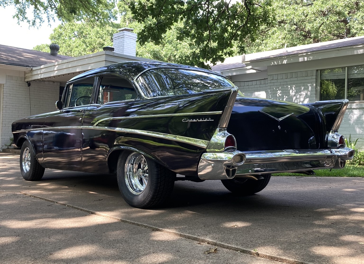

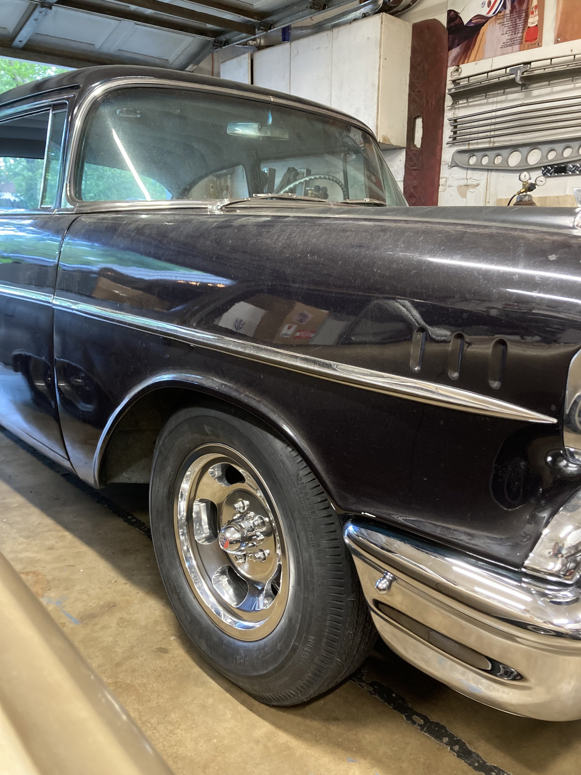

    An update...I've always been inspired by Butt Reynolds. A lot of people seem to like your car as-is...and you do too, but feel like a change and go for it. I'm into that. So I went up. Back to stock spindles and "heavy duty" front springs that I cut one coil from just to be able to install. I don't want to run ball joint spacers. Out back I just removed the lowering blocks and moved the rear springs to the higher setting in the shackles. The wheels and tires are wrong. I always have trouble nailing down the perfect setup...either because I cant get it, or can't afford it. But this time I will wait it out. I REALLY want American Racing Lemans front runners but might settle for ET 5-spokes. Not sure yet for the back. It still doesn't run anyway, so whatever. The steering box is blown out, it's an old power conversion done before the aftermarket had power boxes for these. I ordered a new box. I also yanked the front bumper to see if I like it without, and I'm still torn.

    Beautiful! Front bumpers are optional on these cars. Those wheels are great, some bias ply tires would change the look.
  8. Looking good!
    Personally the Cragars would be my wheel of choice for that car, and you already have them.
    RAK, 427 sleeper and Anderson like this.

    I agree. These are all original curved spoke Cragars and in really good shape. The fronts are 14"x6" and 15"x7" out back. I would like to find some 8.5" for the rear before I think about shelling out $$$$$ for better tires.

    Stance and wheel's look killer, just like the rest of the car! Looks much better without the bumper. The stock grille bar without the grille(or maybe a silver grille) might liven up the front end a little too. ;)

    I guess the stance is pretty close to what I had pictured. Something between Junior stock and late '60's drag car. A stock grill bar would be cool but those things are kind of expensive! Most originals are broken or too crusty, but I'm keeping an eye out. I do think tires will be the next big purchase.
