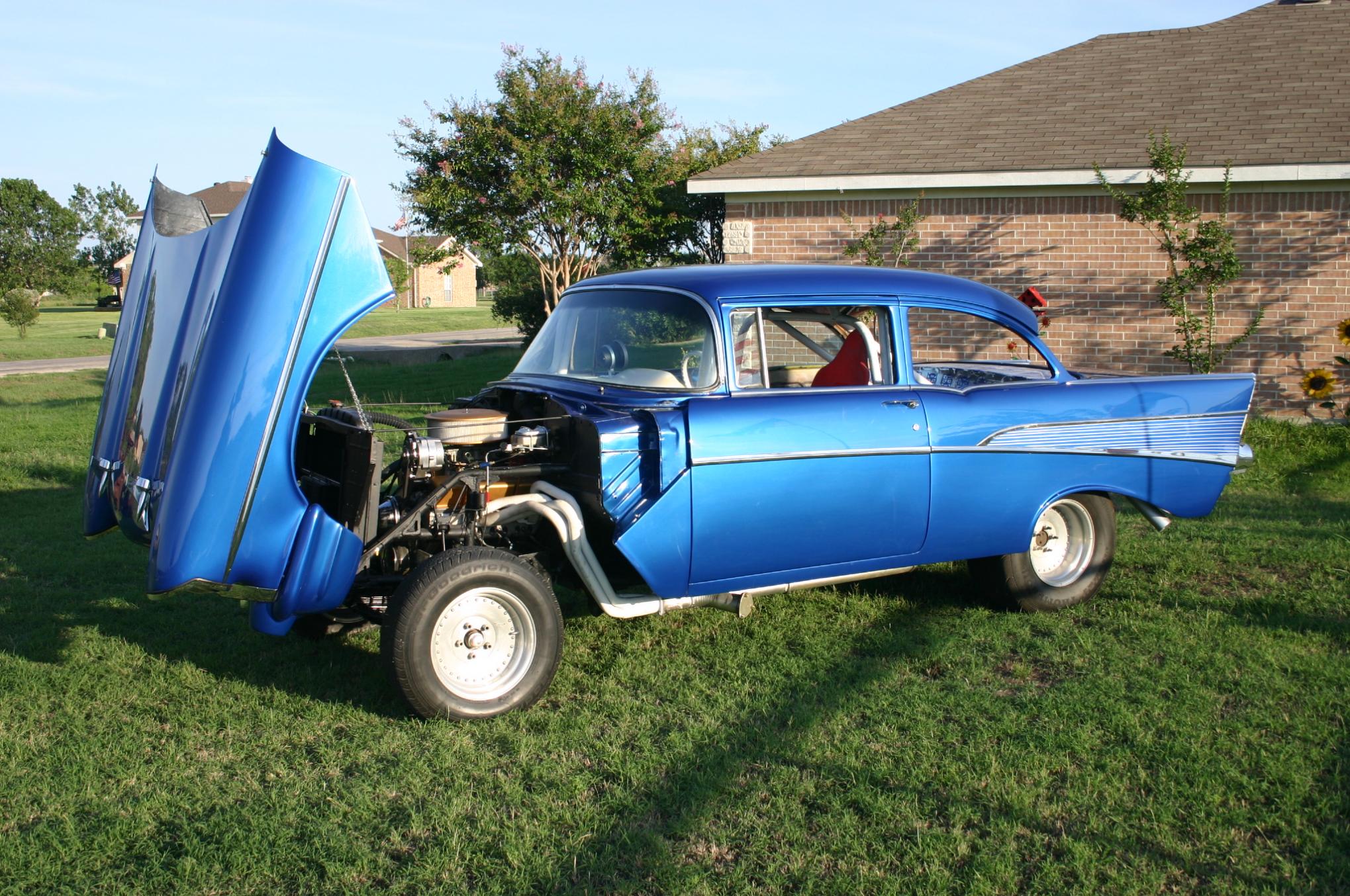

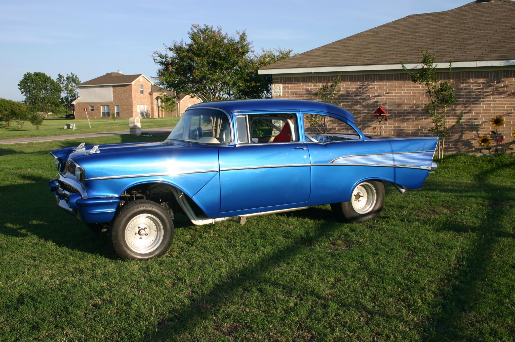

    all tube ch***is wth narrowed 9 inch 4:56gears,on ladderbar with coilover,frt is 4inch drop tube axle with leafs and rear supports.the guy who built it copied a 57 from missouri from the 60s.all fibergl*** tilt front end.it had a 383 two days ago until the previous owner dropped a small bolt in the intake and did not know and fired it up,well it wasnt good no.6 hole ended up with 2 cracks top to bottom. there for right time right place!new power plant began today 383.going to redo wiring and inside,have all the missing pieces to finish.

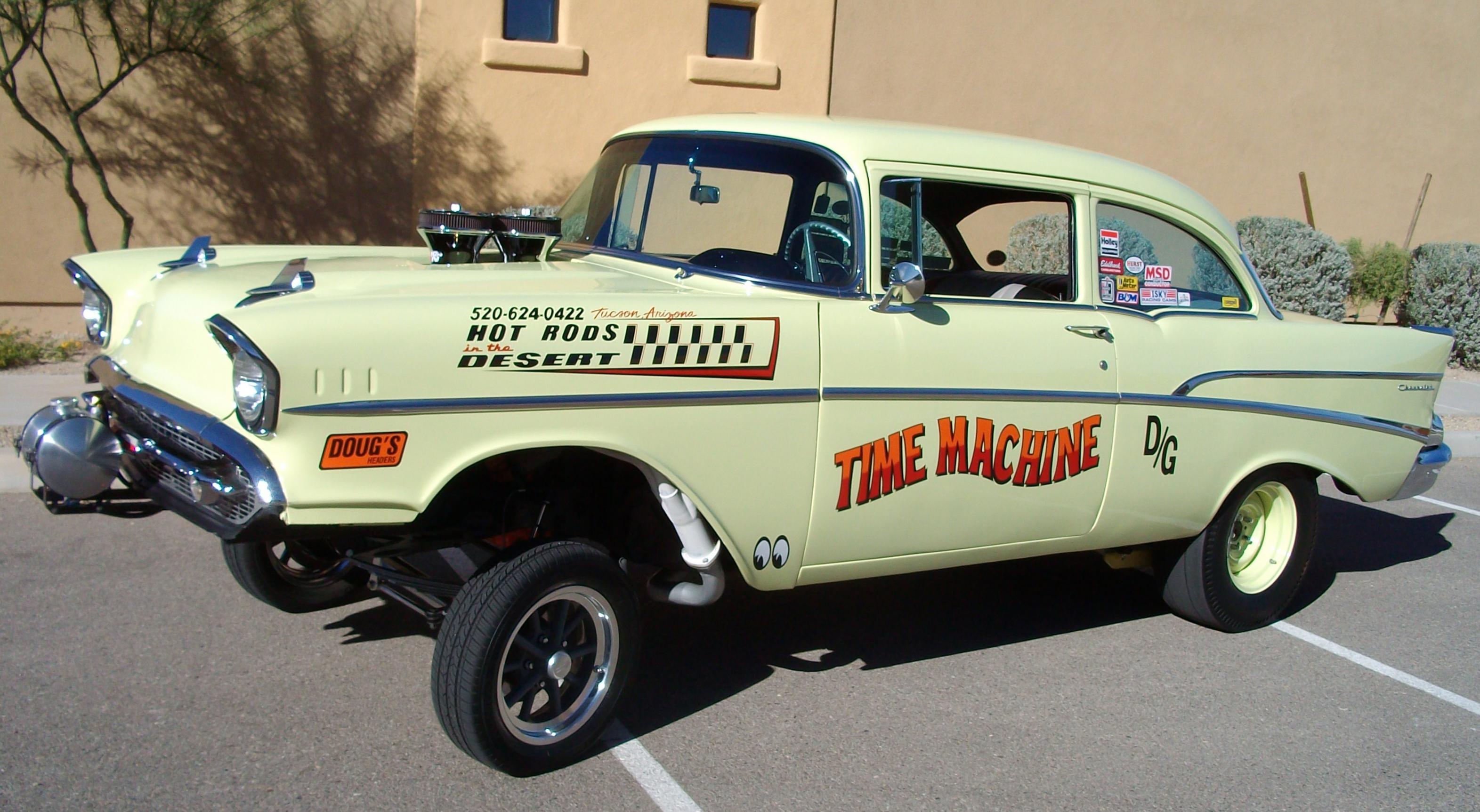

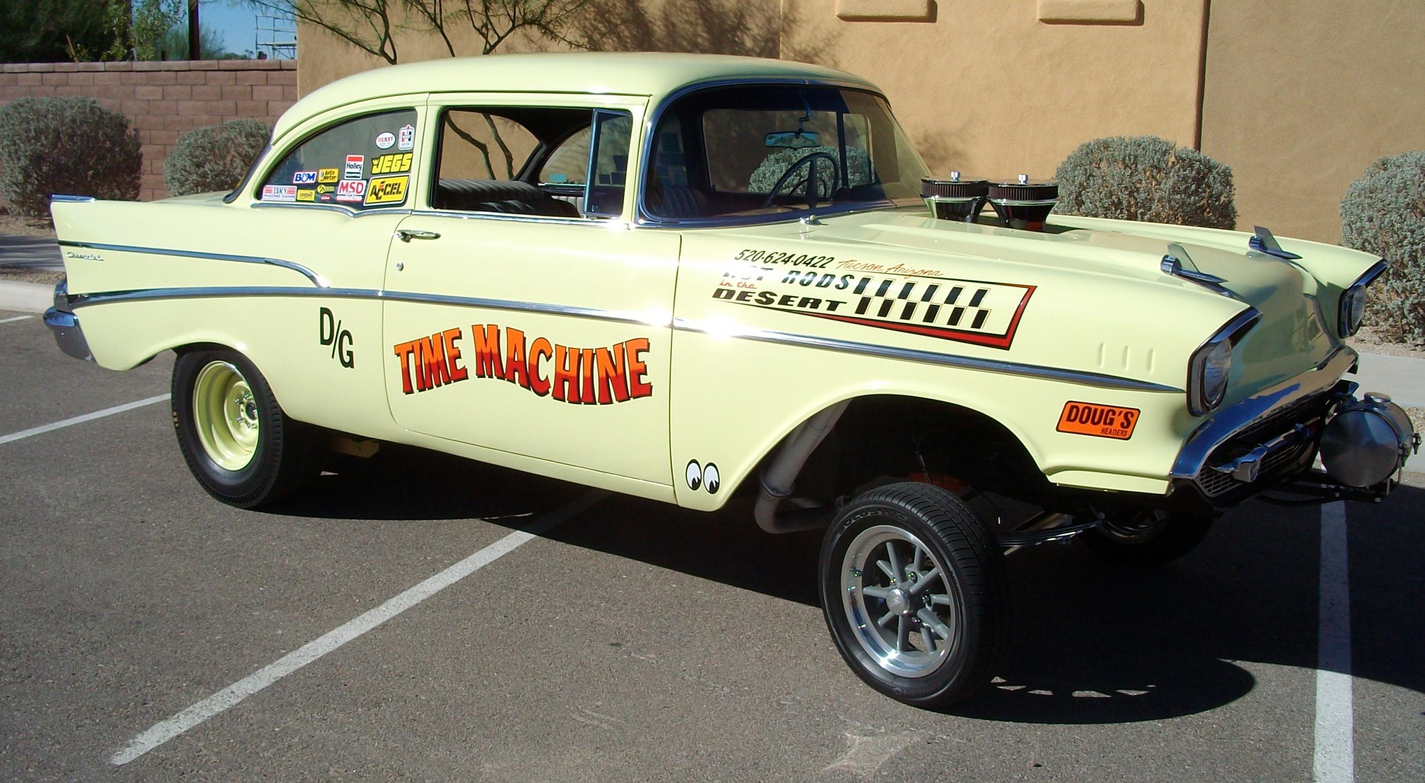

    i almost forgot,told him about some of the responses of the hamb and he listened,piecrust slicks,all hand painted lettering.Dad got pictures of mine today now he wants to come help finish it,DADS ARE GREAT,I am 44 and hes 65 and still building.he went yesterday and installed the strait axle in his friends 56 or 57.I wish he lived closer.here are updated picts of his,they are never done RIGHT!

    made the first test drive,with the following,
    new 383 with,dart aluminum heads(ported and matched of course)
    roller rockers with stud girdles
    victor jr with holly 850
    bullet 540 lift solid lifter cam
    drove to my engine builders house to do first launch.ALL I CAN SAY IS HOLD ON!
    and dad watch out! i know wheels got to go,building is half the fun.
