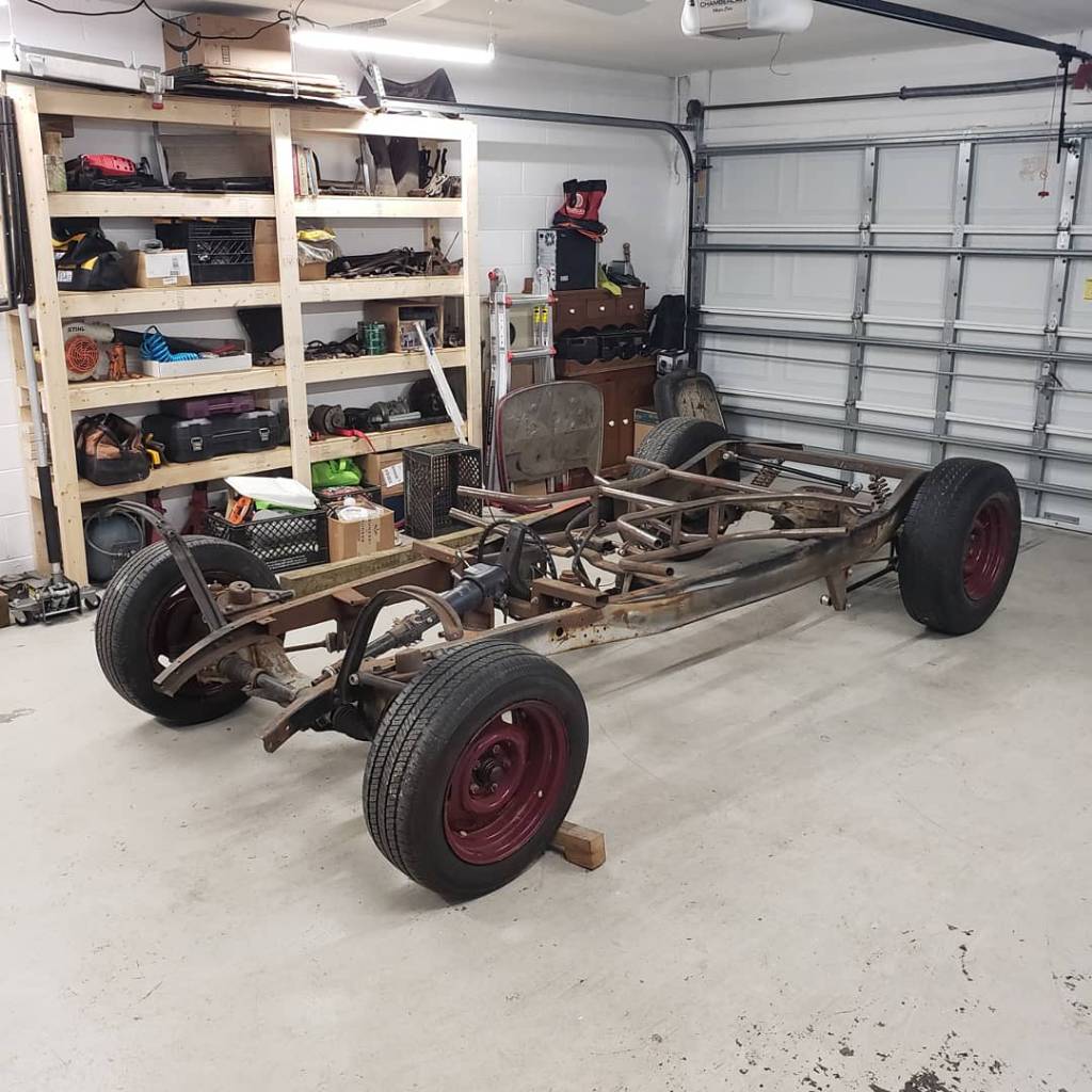

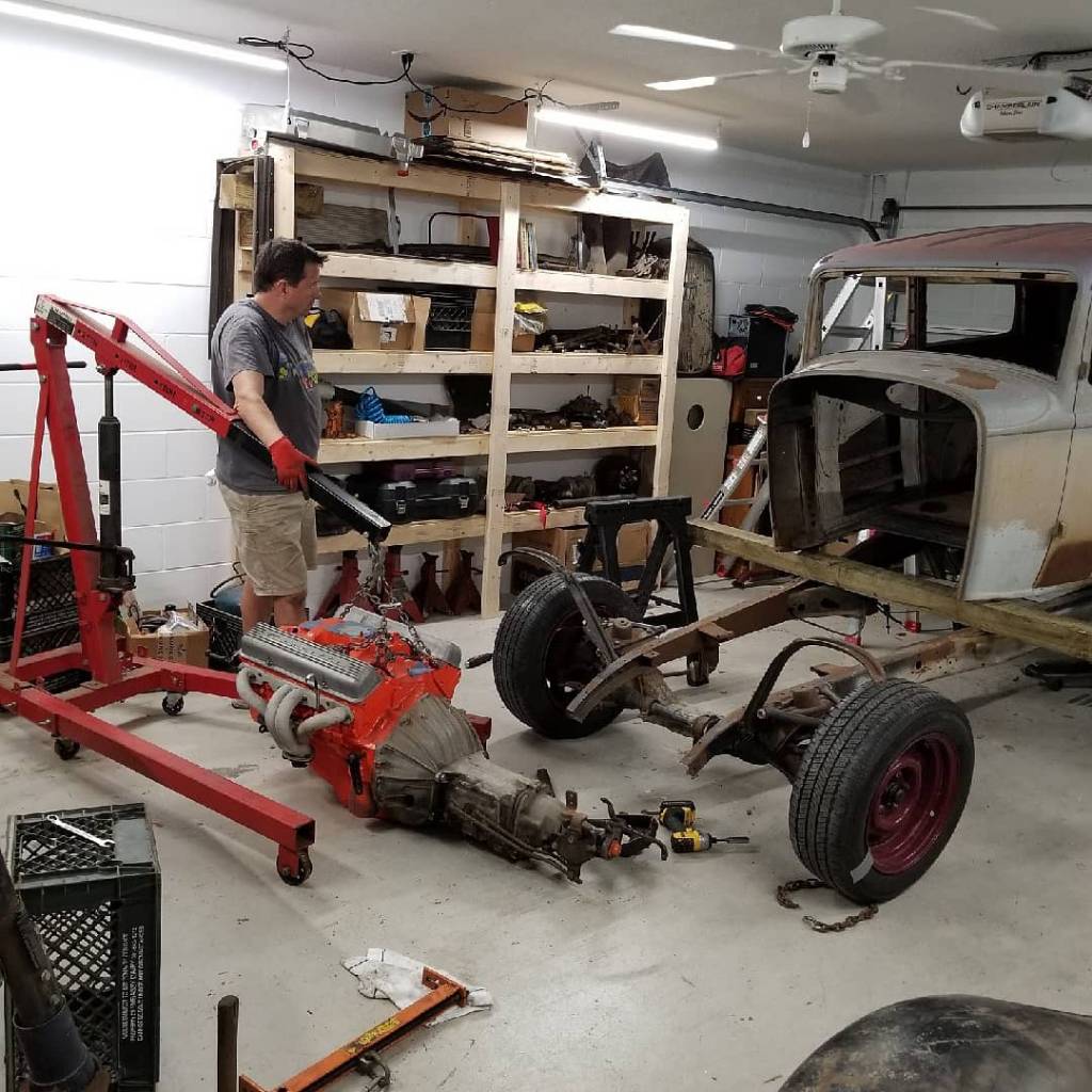

    My last post asked about opinions on how to (re)build my dads 32. Finally got her back down to Florida and am getting to work. Looks like we are going to be removing the mustang II dad installed in the 80's and install the 4" dropped chrome I-beam I picked up this past weekend at the Turkey run in Daytona. Also got a new vega box, and all the various bits to go with the swap. Here's a few pictures of the dis***embly. IMG_20181128_090859_654.jpeg IMG_20181128_090859_655.jpeg IMG_20181128_090859_656.jpeg

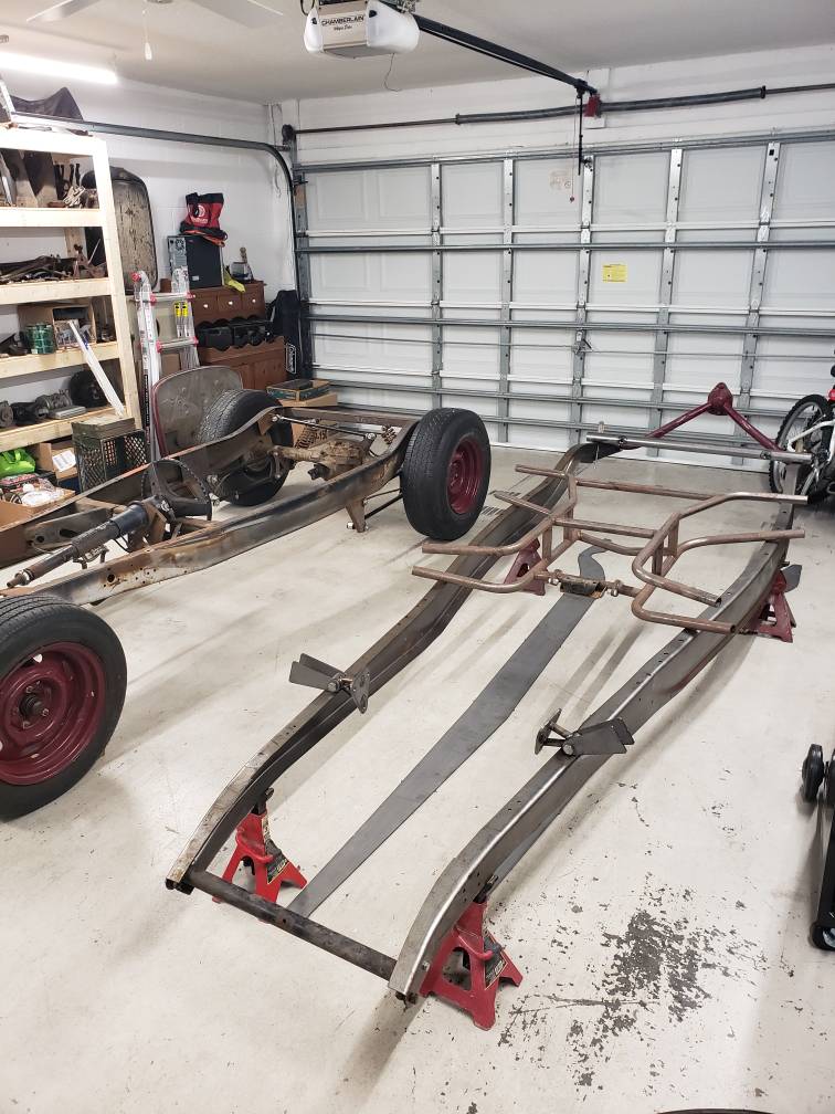

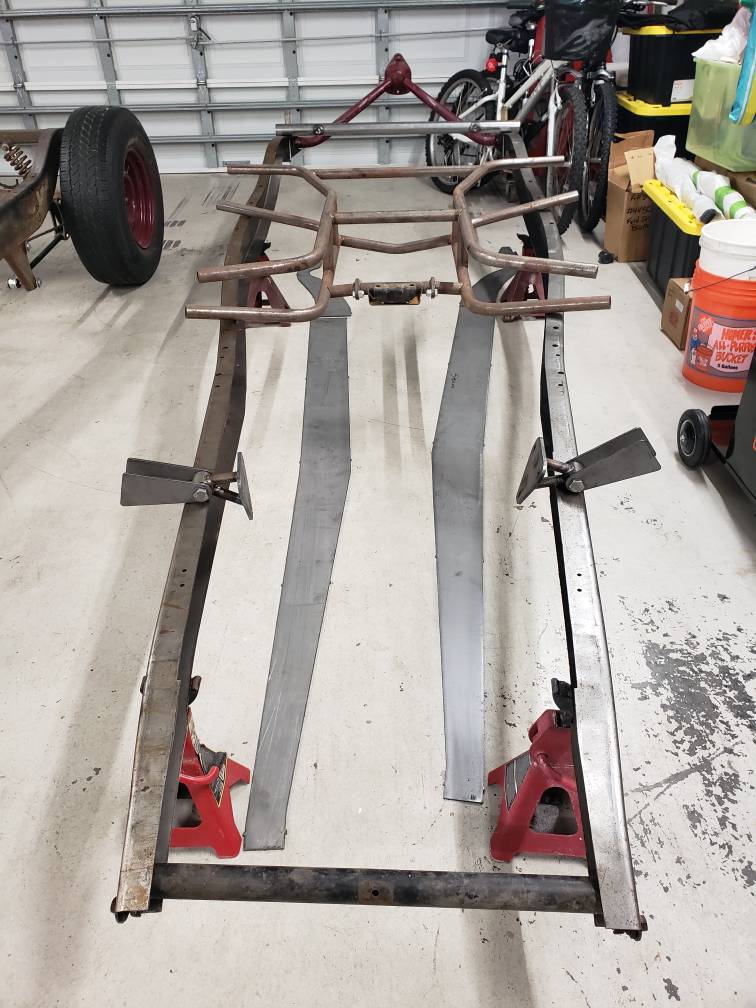

    The JW Rod garage frame builders kit showed up this afternoon. Couldn't resist doing a quit mockup. Excited to get started on the new frame! 20181207_190855.jpeg 20181207_190907.jpeg

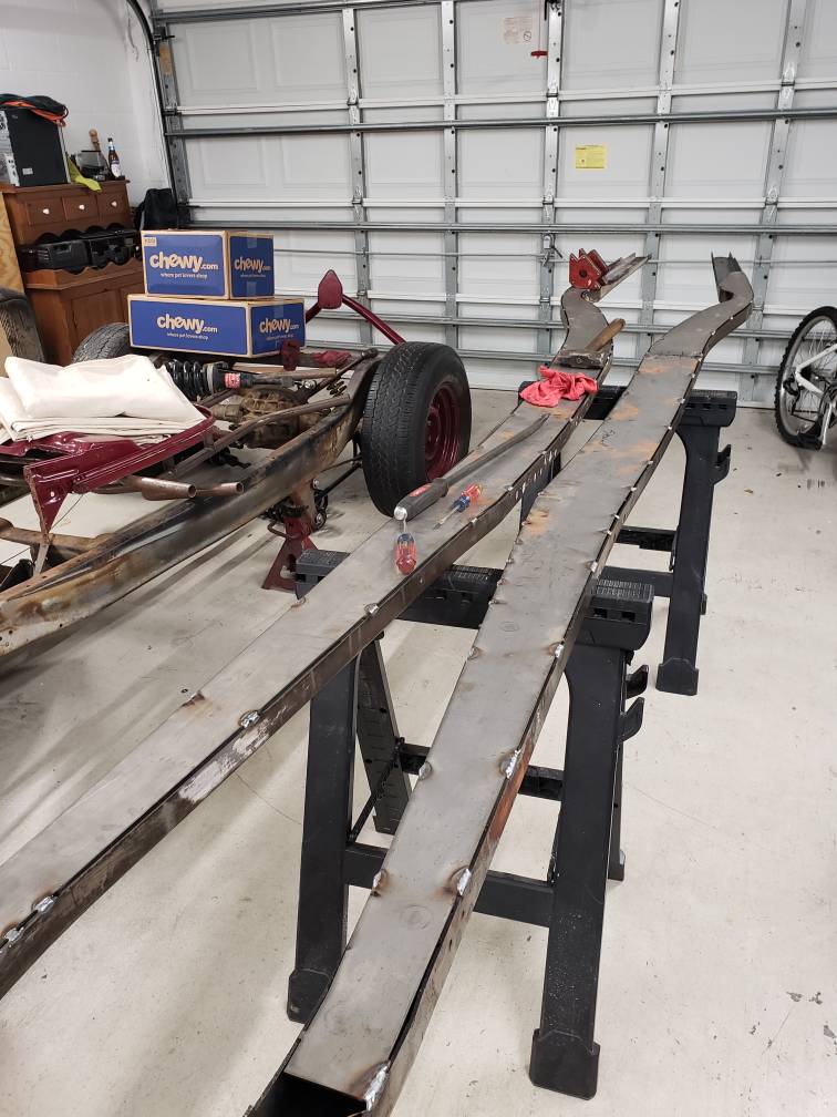

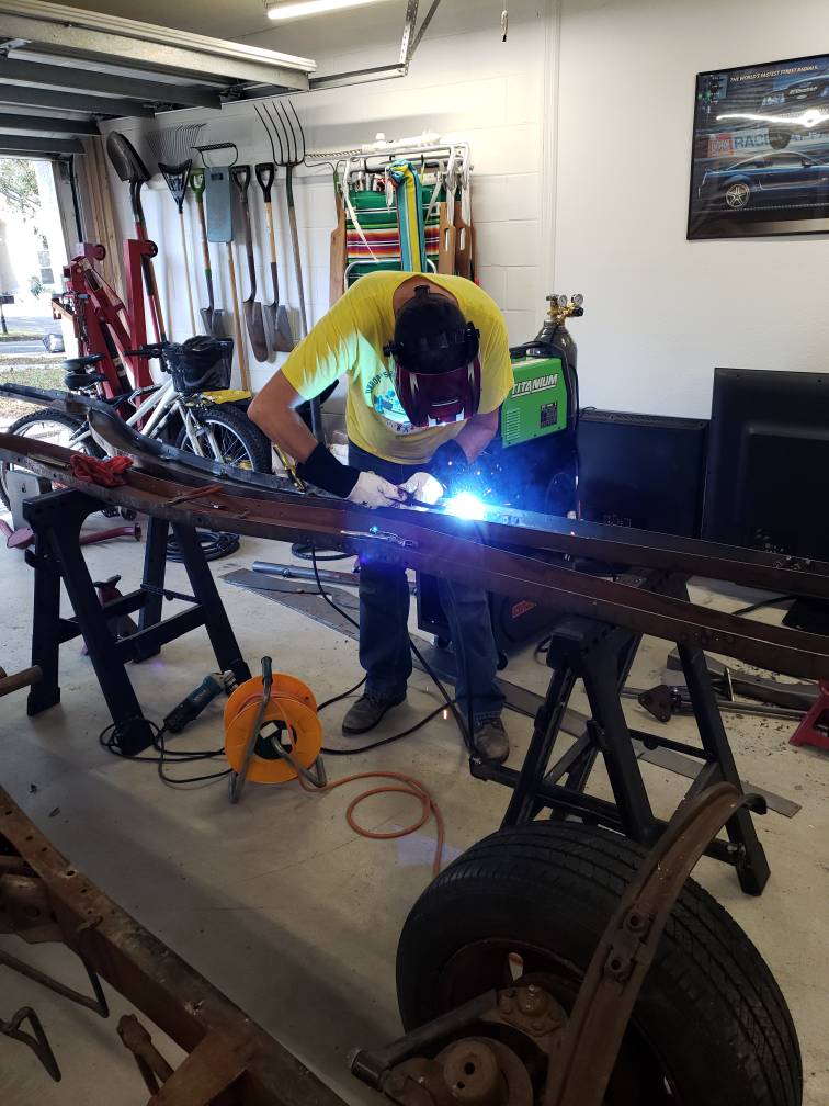

    Dad and I made some progress on the JW frame builders kit today. We had ordered about a hundred dollars worth of 5/16 18 & 1/4 20 weld in cage nuts from McMaster Carr for all of the body mount, fender, running boards and hood hold down bolts that will be inaccessible when the frame is boxed. Spent a full day getting them all in! I wiped everything with laquer thinner and ospho before I painted the inside of the frame rails to help control any rust. Then he helped me line up the boxing plates. All thats left now is to do the perimeter weld for the boxing plates before we jig it up for the cross members. 20190113_125309.jpeg 20190113_153541.jpeg 20190113_182101.jpeg

    Hey bud, I'd jig that frame up before welding anything on it. Most repro rails require a bunch of tweaking to be up to Ford specs. I'd hate to see you installing everything and then drop a body on top that won't fit.

    Yeah, that's what I said in my post, I need to jig it to start installing my cross members. All I have is spec sheets, anyone know someone with a 32 frame jig in Florida? I called Clark Hot Rods in Daytona, but the only phone number I could find listed went to a real estate company and they didn't return my call.

    You should jig it before you weld in the boxing plates too.
