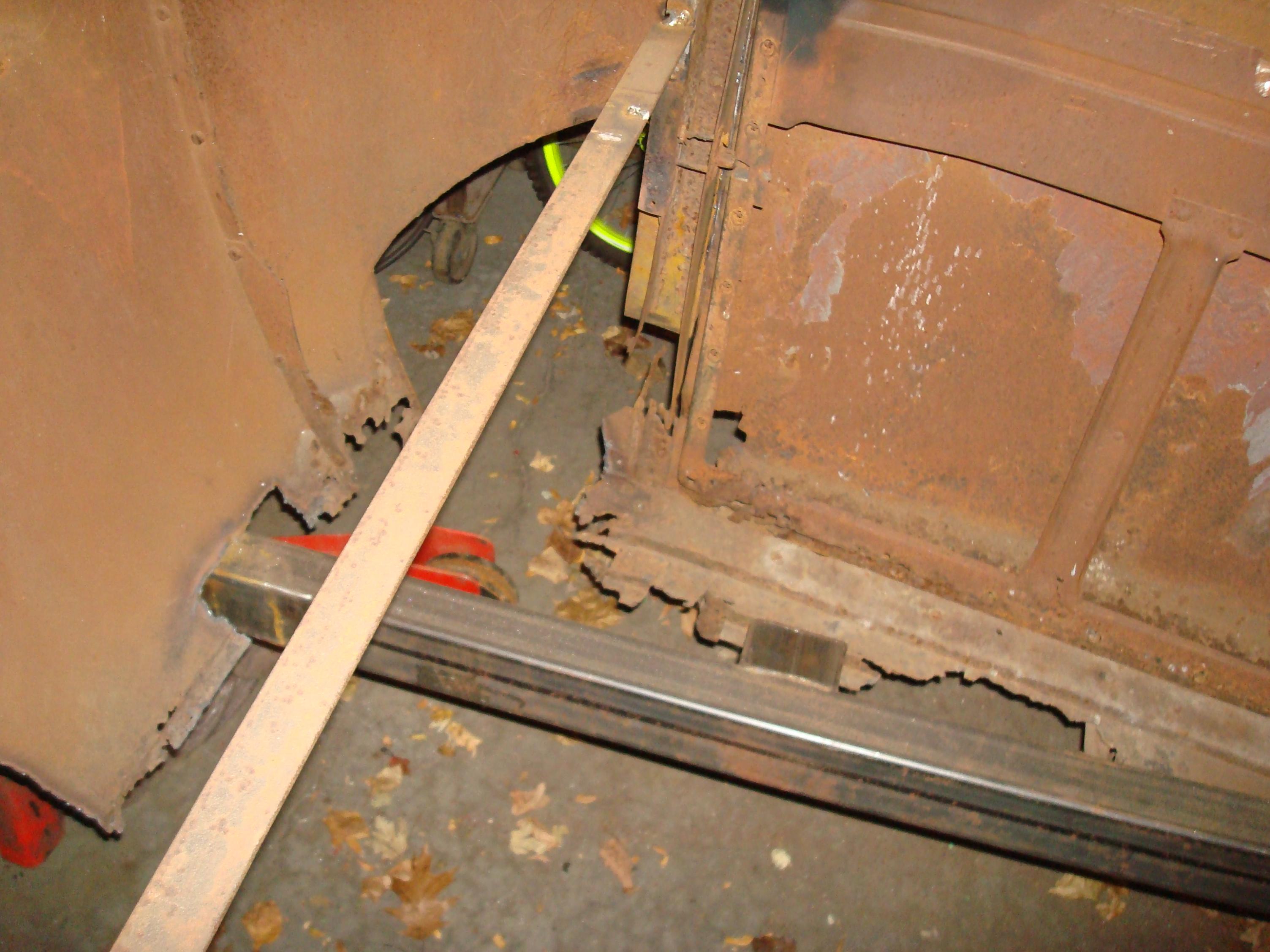

    So heres a lil taste of what I have to work with as far as the floor goes... NOT a pretty sight!
